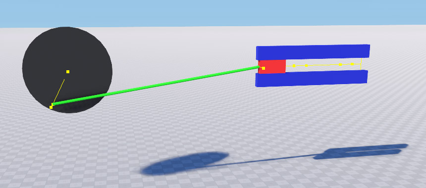

Creating Geometry and Adding Some Physics#
The first thing we are going to address in this tutorial is the geometry of our mechanism (see the picture above). We are going to create the following parts:
  • 2 blue guide bars
  • a red piston
  • a green rod
  • a black wheel
  • 2 dummy objects with dummy bodies to attach the parts of our mechanism to.
We are also going to add some physical parameters to the geometry such as mass and collision shapes. So, we need a set of basic functions:

Now using these functions we can create our mechanism. We are going to use DynamicMesh objects for the parts and Dummy objects for mounting points.
// creating parts of the mechanism
Mat4 transform = Mat4(translate(0.0f, 0.0f, 10.0f)*rotateY(90.0f));
piston = createBodyBox("piston", vec3(1.0f, 2.0f, 0.5f), 15.0f, vec4(1.0f, 0.1f, 0.1f, 1.0f), transform * Mat4(translate(0.0f, 3.5f, 0.0f)));
guide_bar1 = createBodyBox("guide_bar1", vec3(1.0f, 9.0f, 0.5f), 15.0f, vec4(0.0f, 0.1f, 0.7f, 1.0f), transform* Mat4(translate(1.0f, 3.0f, 0.0f)));
guide_bar2 = createBodyBox("guide_bar2", vec3(1.0f, 9.0f, 0.5f), 15.0f, vec4(0.0f, 0.1f, 0.7f, 1.0f), transform* Mat4(translate(-1.0f, 3.0f, 0.0f)));
wheel = createBodyCylinder("wheel", 3.0f, 0.25f, 25.0f, vec4(0.1f, 0.1f, 0.1f, 1.0f), transform * Mat4(translate(0.0f, -15.0f, -0.5f)));
rod = createBodyCylinder("rod", 0.1f, 15.0f, 5.0f, vec4(0.1f, 1.1f, 0.1f, 1.0f), transform * Mat4(translate(0.0f, -5.0f, 0.0f) * rotateX(90.0f)));
//creating mounting points
dummy1 = createBodyDummy("dummy1", vec3(1.0f, 1.0f, 1.0f), transform * Mat4(translate(0.0f, -15.0f, -1.5f)));
dummy2 = createBodyDummy("dummy2", vec3(1.0f, 1.0f, 0.5f), transform * Mat4(translate(0.0f, 7.0f, 0.0f)));

	jh2 = JointHinge::create(rod->getBody(), piston->getBody(), Vec3(0.0f, 2.5f, 10.0f), vec3(1.0f, 0.0f, 0.0f));
	// setting number of iterations
	jh->setNumIterations(8);
	jh2->setNumIterations(8);
	// creating fixed joints
	jf1 = JointFixed::create(dummy2->getBody(), guide_bar1->getBody(), Vec3(0.0f, 7.0f, 9.0f));
	jf2 = JointFixed::create(dummy2->getBody(), guide_bar2->getBody(), Vec3(0.0f, 7.0f, 11.0f));
	jf1->setNumIterations(1);
	jf2->setNumIterations(1);
	// creating a prismatic joint
	jp = JointPrismatic::create(piston->getBody(), dummy2->getBody());
	jp->setWorldAxis(vec3(0.0f, 1.0f, 0.0f));
	// setting linear limits [-5.0; 0.0] and softness
	jp->setLinearLimitFrom(-5.0f);
	jp->setLinearLimitTo(0.0f);
	jp->setLinearSoftness(0.5f);
	jp->setNumIterations(8);
	// creating a cylindrical joint
	jc = JointCylindrical::create(dummy1->getBody(), wheel->getBody());
	// setting rotation axis in world coordinates
	jc->setWorldAxis(vec3(1.0f, 0.0f, 0.0f));
	// setting common joint constraint parameters
	jc->setLinearRestitution(0.4f);
	jc->setAngularRestitution(0.4f);
	jc->setLinearSoftness(0.4f);
	jc->setAngularSoftness(0.4f);
	// setting linear and angular damping
	jc->setLinearDamping(4.0f);
	jc->setAngularDamping(2.0f);
	// setting small linear limits as we are not going to use this degree of freedom to the full extent
	jc->setLinearLimitFrom(-0.0005f);
	jc->setLinearLimitTo(0.0005f);
	jc->setNumIterations(16);
	// setting up motor parameters for a cylindrical joint to animate the whole mechanism
	jc->setAngularVelocity(1000.0f);
	jc->setAngularTorque(150.0f);
