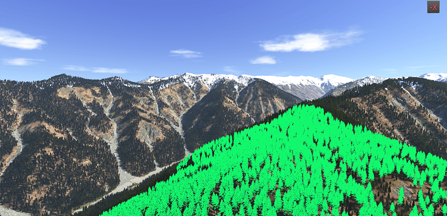

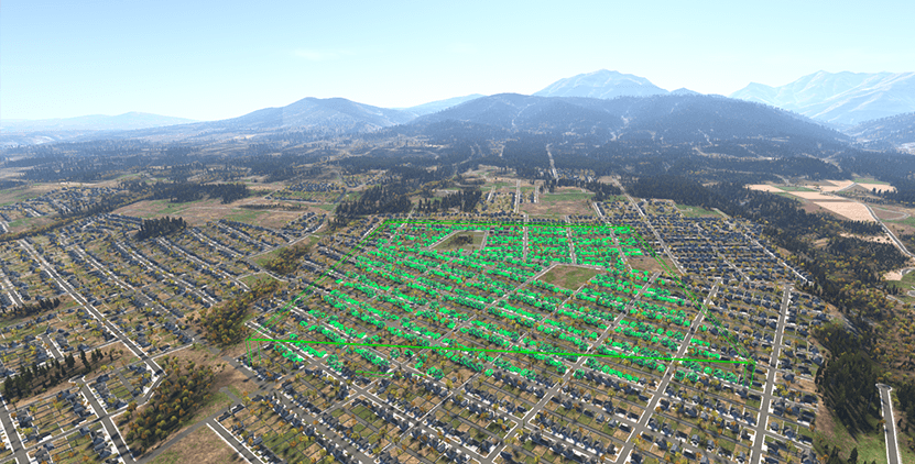

UNIGINE provides additional objects to take full advantage of mesh batching:UNIGINE提供了其他对象以充分利用网格划分的优势:
  • Mesh Clutter is an object used to scatter a large number of identical meshes across the world. It is suitable for simulating vegetation a lot while keeping performance high. Mesh Clutter是用于在世界上散布大量相同网格的对象。它适用于大量模拟植被,同时又保持较高的性能。
  • Mesh Cluster is an object that can contain a great number of identical meshes with the same material, which are managed as one object. Cluster meshes can be scattered either automatically, or each mesh can be positioned, rotated, and scaled manually.Mesh Cluster是一个对象,可以包含大量具有相同材质的相同网格,将它们作为一个对象进行管理。群集网格可以自动分散,也可以手动定位,旋转和缩放每个网格。
Follow the Working with Large Number of Objects article for more details on using these objects.跟着处理大量对象文章以获取有关使用这些对象的更多详细信息。
