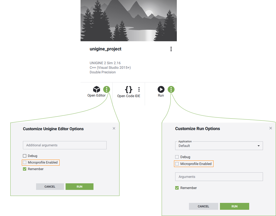

One way to disable Microprofile is to untick the corresponding option before running UnigineEditor or the application:禁用Microprofile的一种方法是在运行UnigineEditor应用程序之前取消选中相应的选项:
Disabling Microprofile via SDK Browser

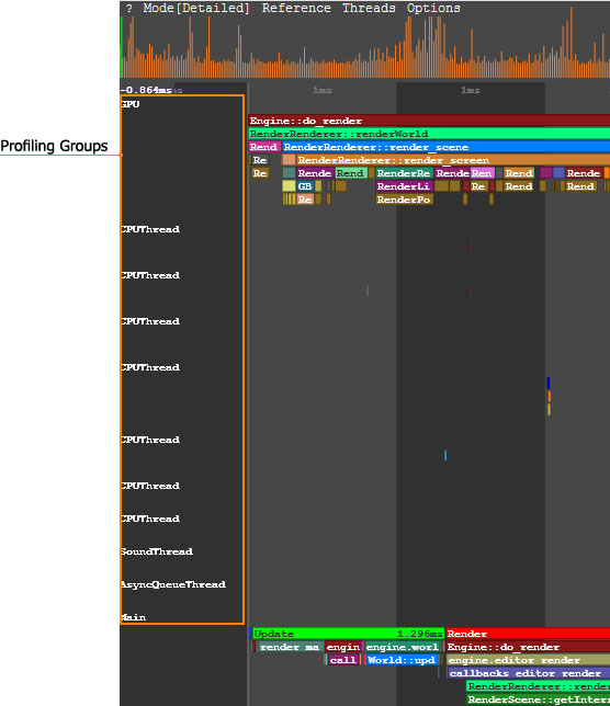

The Microprofile visualizes the detailed per frame performance data on the operations performed by the engine on CPU and GPU and on the engine threads. In the Microprofile main menu, you can change the visualization mode: click Mode and choose the required one. By default, the Detailed mode is set. Microprofile可视化引擎在CPU和GPU 以及引擎线程上执行的操作的每帧详细性能数据。在Microprofile主菜单中,您可以更改可视化模式:单击Mode并选择所需的模式。默认情况下,设置为Detailed模式。

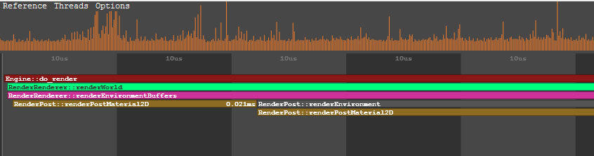

Profiling Groups Displayed in Detailed ModeDetailed模式显示的性能分析组
In the Detailed mode, each operation (function) and thread is displayed as a separate colored region. The regions are hierarchical: the function called by the other function is displayed under the last one. The size of the region is determined by the time the corresponding operation takes.Detailed模式下,每个操作(功能)和线程均显示为单独的彩色区域。区域是分层的:另一个功能调用的功能显示在最后一个功能下方。区域的大小取决于相应操作所花费的时间。
In the picture below, the Engine::do_render() function calls the RenderRenderer::renderWorld() functions and so on:在下图中,Engine::do_render()函数调用RenderRenderer::renderWorld()函数,依此类推:
To view the data on a certain operation or a thread, point to the corresponding region. To zoom in/out the displayed regions, scroll the mouse wheel.要在某个操作或线程上查看数据,请指向相应的区域。要放大/缩小显示的区域,请滚动鼠标滚轮。

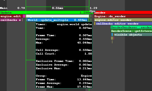

In the Main group of the performance data, the call stack of the operations (e.g., update, rendering, etc.) performed by the engine on CPU is displayed.在性能数据的Main组中,显示引擎在CPU上执行的操作的调用堆栈(例如update, rendering等)。
Performance Data on World Update Function World Update函数的性能数据

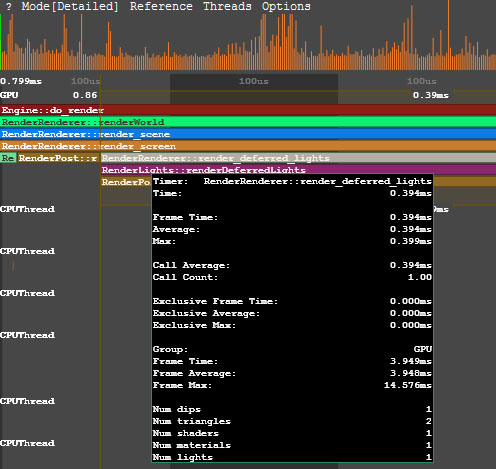

GPU Data
GPU数据#
In the GPU group of the performance data, the call stack of the operations performed by the engine on GPU is displayed. In addition to the main performance data, for each function (e.g. environment rendering, post materials rendering and so on), the number of DIP calls and rendered triangles is shown. Also there can be the number of surfaces, lights, shadows rendered by this function, the number of materials and shaders used; the information on the node or material for which the function is called (identifier, name, etc.).性能数据的 GPU 组中,显示了引擎在GPU上执行的操作的调用堆栈。除了主要性能数据以外,对于每个功能(例如环境渲染,后期材质渲染等),还会显示DIP调用和渲染的三角形的数量。还可以有此功能渲染的表面,灯光,阴影的数量,所使用的材质和着色器的数量。有关调用该函数的节点或材质的信息(标识符,名称等)。
Performance Data on Deferred Lighting Rendering延迟照明渲染上的性能数据
When the region that corresponds to the certain function is pointed, the Microprofile displays when this function is called on CPU and how much time is spent on its performing. 指向与某个功能对应的区域时,将在CPU上调用此功能以及执行该功能所花费的时间时显示Microprofile

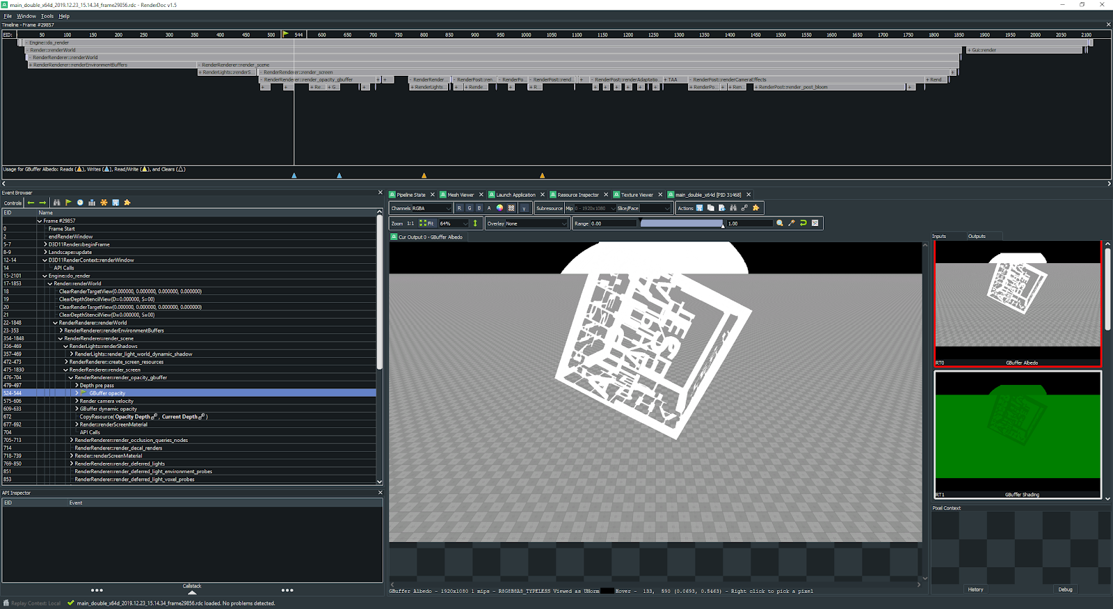

Vulkan or DirectX commands can be combined into GPU Debug groups that are created automatically when defining a profiling scope. All graphic resources loaded from external files, such as textures, shaders, static or skinned meshes, as well as the Engine's internal resources, have their own debug names to simplify identification. This information can be useful when using Graphics API debuggers, such as NVIDIA Nsight or RenderDoc. Vulkan或DirectX命令可以组合到在定义概要分析范围时自动创建的GPU调试组。从外部文件加载的所有图形资源(例如纹理,着色器,静态或蒙皮的网格物体)以及引擎的内部资源均具有自己的调试名称,以简化识别。使用Graphics API调试器(例如NVIDIA NsightRenderDoc)时,此信息可能很有用。
Example of debug data viewed in RenderDocRenderDoc中查看的调试数据示例

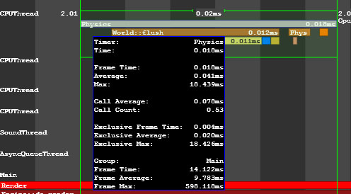

The performance data on the engine threads is visualized in the CPUThread, SoundThread, AsyncQueueThread, WorldSpawnMeshClutterThread, WorldSpawnGrassThread groups. 引擎线程上的性能数据在CPUThread, SoundThread, AsyncQueueThread, WorldSpawnMeshClutterThread, WorldSpawnGrassThread组中可视化。
Performance Data on Physics Thread物理线程上的性能数据

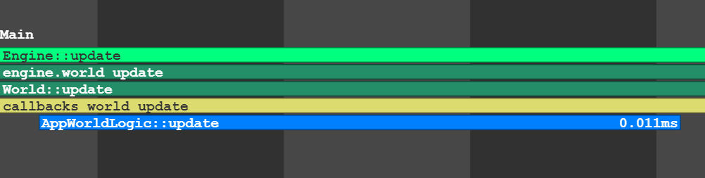

Using Microprofile For Application Logic
将Microprofile用于应用逻辑#
You can use the Microprofile to inspect performance of your application logic. 您可以使用Microprofile来检查应用程序逻辑的性能。
  1. Open the source code of your application.打开应用程序的源代码。
  2. Include the UnigineProfiler.h file to get access to methods of the Profiler class.包含UnigineProfiler.h文件以访问Profiler类的方法。
    AppWorldLogic.h
    #include <UnigineProfiler.h>
  3. Find a function or a scope in the code you want to inspect.在要检查的代码中查找函数或作用域。
  4. In the beginning of the function (or the scope), call Profiler::begin(). Specify a name for the capture to be displayed in the Microprofile.在函数(或作用域)的开头,调用Profiler::begin()。 指定要在Microprofile中显示的捕获的名称。
    You can specify the __FUNCTION__ macro to automatically use the class and the function name as the capture.您可以指定__FUNCTION__宏以自动使用类和函数名作为捕获。
  5. In the end of the function (scope), call Profiler::end().在函数(作用域)的末尾,调用Profiler::end()
    AppWorldLogic.cpp
    int AppWorldLogic::update()
    	// start profiling
    	Profiler::begin("AppWorldLogic::update");
    	float time = Game::getTime();
    	float angle_0 = time * 1.0f;
    	float angle_1 = time * 1.5f;
    	float angle_2 = time * 2.0f;
    	light_0->setWorldTransform(translate(Unigine::Math::Vec3(sinf(angle_0), cosf(angle_0), 1.0f) * 20.0f));
    	light_1->setWorldTransform(translate(Unigine::Math::Vec3(sinf(angle_1), cosf(angle_1), 1.0f) * 20.0f));
    	light_2->setWorldTransform(translate(Unigine::Math::Vec3(sinf(angle_2), cosf(angle_2), 1.0f) * 20.0f));
    	// stop profiling
    	Profiler::end();
  6. Run the project.运行项目。
  7. Open the console and run the microprofile_enabled 1 command.打开控制台并运行microprofile_enabled 1命令。
  8. Go to the Microprofile and find the region with the specified name.转到Microprofile并找到具有指定名称的区域。

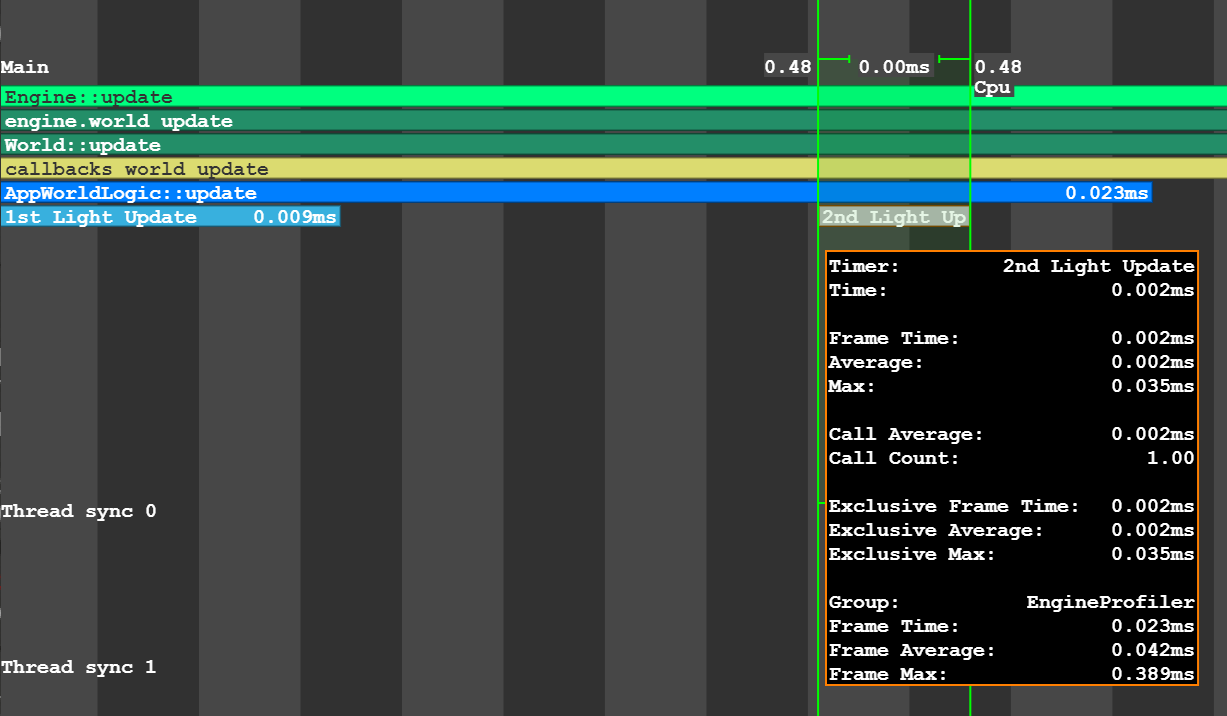

Creating Nested Counters for Profiling
创建用于分析的嵌套计数器#
To create several nested counters, you should use the beginMicro() and endMicro() functions. beginMicro() returns an identifier that should be passed to endMicro(). This enables to create nested and intersecting profiler counters.要创建多个嵌套计数器,应使用beginMicro()endMicro()函数。 beginMicro()返回应传递给endMicro()的标识符。 这样就可以创建嵌套和相交的分析器计数器。
In the following example, combination of begin()/end() and beginMicro()/endMicro() is used. So, profiling of the AppWorldLogic::update() function will be available in both the Profiler and the Microprofile.在以下示例中,使用begin()/end()beginMicro()/endMicro()的组合。 因此,AppWorldLogic::update()函数的分析将在分析器和Microprofile中都可用。
AppWorldLogic.cpp
	// start profiling
	// start profiling of the first light source (available in the Microprofile only)
	int id_0 = Profiler::beginMicro("1st Light Update");
	// stop profiling of the first light source
	Profiler::endMicro(id_0);
	// start profiling of the second light source (available in the Microprofile only)
	int id_1 = Profiler::beginMicro("2nd Light Update");
	// stop profiling of the second light source
	Profiler::endMicro(id_1);
	// stop profiling
	Profiler::end();
