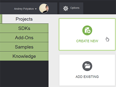

It is very easy to start your own C++ project by using UNIGINE SDK Browser:
  1. Open the UNIGINE SDK Browser.
  2. Go to the Projects tab and click CREATE NEW.

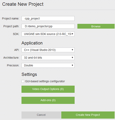

  3. Specify the following parameters:
    • Project - specify the name of your project.
    • Project Path - specify the path to your project folder.
    • SDK - choose the UNIGINE SDK.
    • API - here choose C++ to start working with the C++ API.
      This parameter depends on a platform:
      • On Windows you can create C++ Visual Studio 2010 or C++ Visual Studio 2013 project.
      • On Linux you can create C++ GNU make project.
    • Architecture - specify the architecture of your target platform.
    • Precision - specify the precision. In this example we will use double precision.
    Read more about these parameters in this article

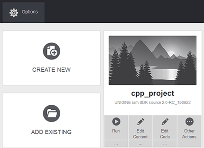

  4. Click the Create New Project button. The project will appear in the projects list.
You can run your project by clicking the Run button.

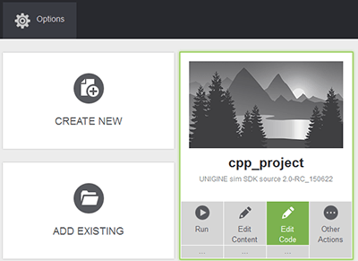

  1. If you created the C++ project for Visual Studio:
    1. Choose your C++ project in the UNIGINE SDK Browser and click the Edit Code button to open the project in IDE.

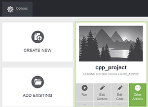

    If you created C++ GNU make project:

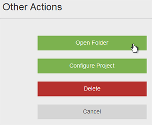

    1. On the created C++ project, click on the Other Actions button and then the Open Folder button.
      Open Folder button
    2. Go to the <YOUR PROJECT>\source\ folder and open the AppWorldLogic.cpp file with any plain text editor.

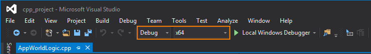

  3. If your use Visual Studio, do the following:
    1. Before compiling your code, check that the appropriate platform and configuration settings for your project are set correctly.

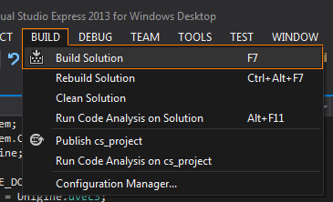

    2. Build your project by clicking Build -> Build Solution in Visual Studio.

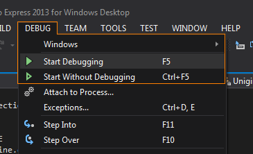

    3. Start your project by clicking Debug -> Start in a proper mode in Visual Studio.
