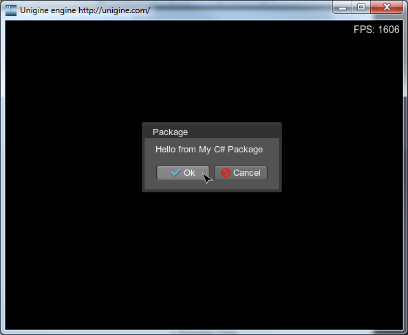

Output#
The following result will be shown:
In the console:
Output
MyPackage.selectFile("data/package.cpp",): called
MyPackage.readFile(,866): called
Loading "data/package.cpp" 4ms
MyPackage.selectFile("data/package.world",): called
MyPackage.readFile(,62): called
Loading "data/package.world" 0ms
Hello from My C# Package
