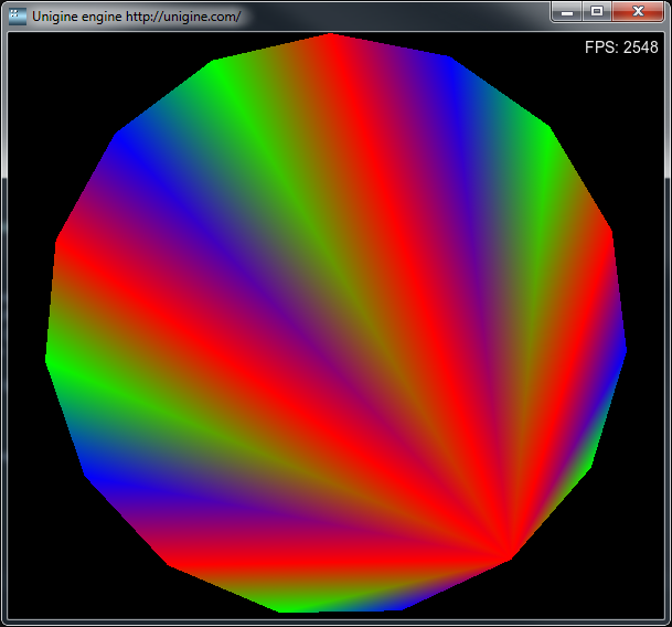

In this part of the code we create the FfpPlugin class which inherits the Plugin class and override the gui() method. We specified the render() method and call it inside the overridden gui() method. Engine calls this function before gui each render frame.
In the Main() method, we create an instance of the FfpPlugin class and add it to the engine by using the addPlugin() method after the wrapper and the engine had been initialized.

Output#
The following result will be shown:
