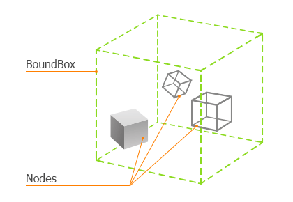

Intersection with Nodes#
To find the intersection of nodes with bounds of the specified volume, you should use functions that have a bounding volume and a vector of nodes in arguments:
Schematic visual representation of intersection with nodes in bounding volume.
These functions return the value indicating the result of the intersection search: 1 if the intersection was found; otherwise, 0. Intersected nodes can be found in the vector that passed as an argument to the function.
To clarify the nodes search, perform the following:
  • Specify the type of node to search.
Usage Example
In the example below, the engine checks intersections with a bounding box and shows the message in the console.
In the update() method: the engine checks the intersection and shows the message about intersection.

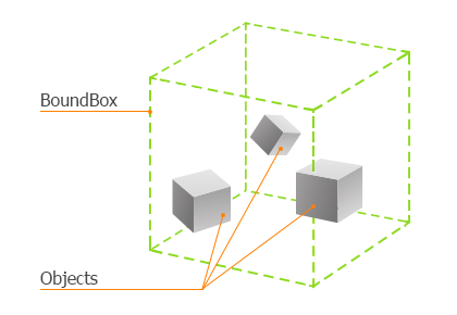

Intersection with Objects#
The following functions can be used to perform the intersection search with objects:
Schematic visual representation of intersection with objects in bounding volume.
These functions return the value indicating the result of the intersection search: 1 if the intersection was found; otherwise, 0. You can pass the start (vec3 p0) and the end (vec3 p1) point of the intersecting line or pass the (BoundBox, BoundFrustum, BoundSphere) to get the intersection of objects with a line or with a bounding volume, respectively. Intersected nodes can be found in the vector that passed as an argument to the function.
Usage Example

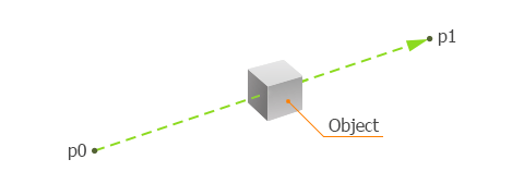

First Intersected Object#
The following functions are used to find the nearest intersected object with the traced line. You should specify the start point and the end point of the line, and the function detects if there are any object on the way of this line.
Schematic visual representation of intersection with objects and traced line.
These functions return an intersection information and a pointer to the nearest object to the start point (p0). Information about the intersection can be presented in standard vectors or in the following format that you pass to functions as arguments:
  • WorldIntersection intersection - the WorldIntersection class instance. By using this class you can get the intersection point (coordinates), the index of the intersected triangle of the object and the index of the intersected surface.
  • WorldIntersectionNormal normal - the WorldIntersectionNormal class instance. By using this class you can get only the normal of the intersection point.
  • WorldIntersectionTexCoord texcoord - the WorldIntersectionTexCoord class instance. By using this class you can get only the texture coordinates of the intersection point.
These functions detect intersection with surfaces (polygons) of meshes. But there are some conditions to detect the intersection with the surface:
  1. The surface is enabled.
  2. The surface has a material assigned.
  3. Per-surface Intersection flag is enabled.
    You can set this flag to the object's surface by using the Object.setIntersection() function.
To clarify the object search, perform the following:
  • Use an intersection mask. An intersection is found only if an object is matching the intersection mask.
  • Specify the list of objects (nodes) to exclude and pass to the function as an argument.
Usage Example
In the example below, the engine checks intersections with a raytraced line and shows the message in the console.

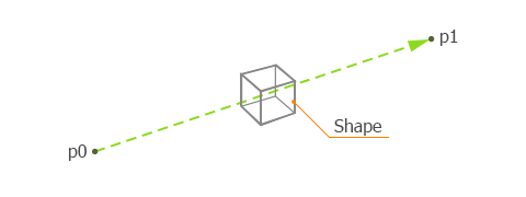

Physics intersection function detects the intersection with a shape of bodies. If the object has no body, this function detects intersection with surfaces (polygons) of the object with intersection flag. When you need to find the intersection with the shape of the object (not with polygons), the intersection function of Physics class is the best way to get it.
The picture above shows how the getIntersection() function detects the shape that intersects with the line.
There are 4 functions to find physics intersections:
These functions perform tracing from the start p0 point to the end p1 point to find a collision object (or a shape) located on that line. Functions use world space coordinates.
Thus, to exclude some obstacles you should use these methods:
  • Use an intersection mask. An intersection is found only if an object is matching the intersection mask, otherwise it is ignored.
  • Specify the list of objects to exclude and pass to the function as an argument.

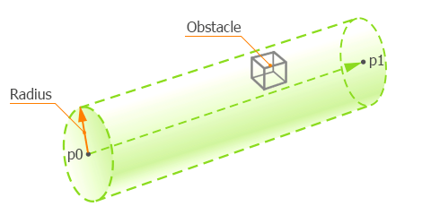

Game class getIntersection() functions are used to check the intersection with obstacles (pathfinding nodes):
The engine creates an invisible cylinder with specified radius between two points and checks if an obstacle is presented inside of it.
Schematic visual representation of intersection with objects and cylinder volume.
These functions return an intersection information and a pointer to the nearest obstacle to the start point (p0). Information about the intersection will be presented in the GameIntersection class instance which you pass to the function as an argument or in the vector.
Use mask and exclude arguments of the overloaded function to specify the obstacle search.
To clarify the obstacle search, perform the following:
  • Use an obstacle intersection mask. An intersection is found only if an object is matching the intersection mask, otherwise it is ignored.
  • Specify the list of obstacles to exclude and pass to the function as an argument.

	player->getDirectionFromScreen(p0,p1,mouse_x, mouse_y, width, height);
	// create an instance of the GameIntersection class
	GameIntersectionPtr intersection = GameIntersection::create();
	// try to get the intersection with an obstacle
	// cylinder has radius 1.5f, intersection mask equals to 1
	ObstaclePtr obstacle = Game::get()->getIntersection(p0, p1, 1.5f, 1, intersection);
	// check, if the intersection of mouse direction with any obstacle was occurred;
	if (obstacle)
		// show the coordinates of the intersection in console
		Log::message("The intersection with the obstacle was here: (%f %f %f)\n", intersection->getPoint().x, intersection->getPoint().y, intersection->getPoint().z);
