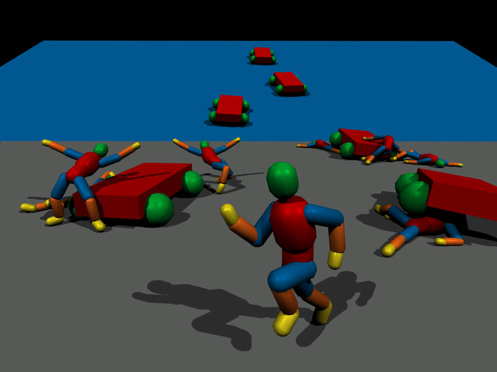

Run Lola Run
Rag dolls and rigid bodies moving according to rigid bodies dynamics

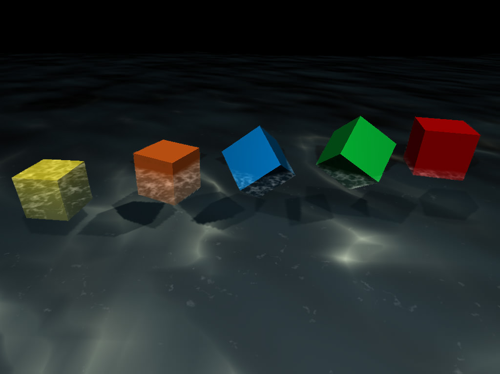

Boxes of different mass and density
Buoyant boxes of different mass and density
Density determines buoyancy of the body in accordance with Archimedes' principle. The higher the density, the less tendency a body has to float.

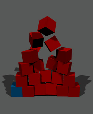

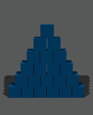

Frozen boxes     Simulation starts again as the impulse unfreezes boxes
Frozen blue and unfrozen red boxes. The impulse applied to the pyramid of boxes unfroze all but one
