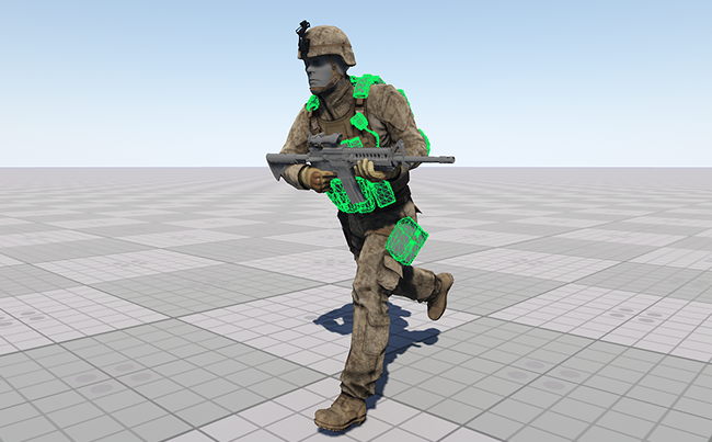

Mesh is the basic unit, that consists of a set of polygons and is used to create geometry for worlds in a UNIGINE project.
Some meshes can be animated, apart from a set of polygons representing its surfaces, such mesh has a hierarchical set of interconnected bones (a skeleton or a rig) which can be used to animate the vertices of the polygons. Another way to animate a model is to create morph targets (or blend shapes), these are "deformed" versions of a mesh, stored as a series of vertex positions. In each key frame of an animation, the vertices are interpolated between these stored positions.
Exported 3D model
You can create 3D models, rigs, and animations in an external modeling application (3DSMax, Maya, Softimage, etc.), and then import them to your UNIGINE project via the Asset Browser.
It is recommended to use FBX as an intermediate file format to bring your 3D models to UNIGINE. This format is supported by the most popular 3D editors: Autodesk Maya, Autodesk 3ds Max, Blender, Modo, etc.
