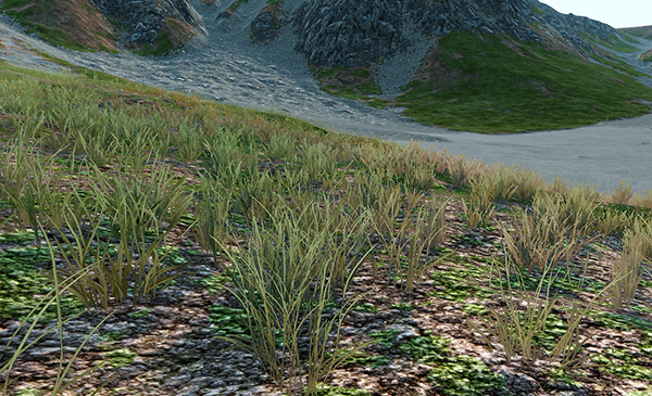

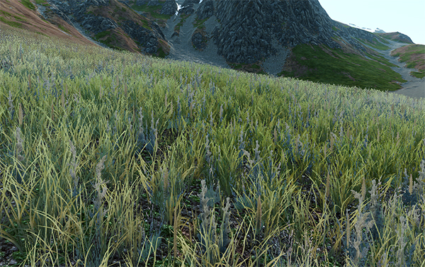

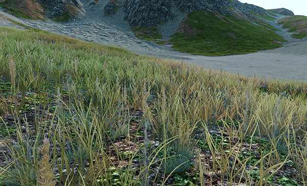

Adding Grass
The article provides the tips and tricks how to create animated grass, swaying and moving as if with the wind. Your grass will also realistically vary in color across the field, so that it does not look unnatural like a freshly-painted lawn. Moreover, you will keep the frame rate high when rendering all these polygons. No matter how big your grass field should be (it can cover the whole terrain), grass appears only around the camera. And here is a first tip: grass looks better upon a hilly terrain. As for planes, low and non-dense grass would be a reasonable choice.

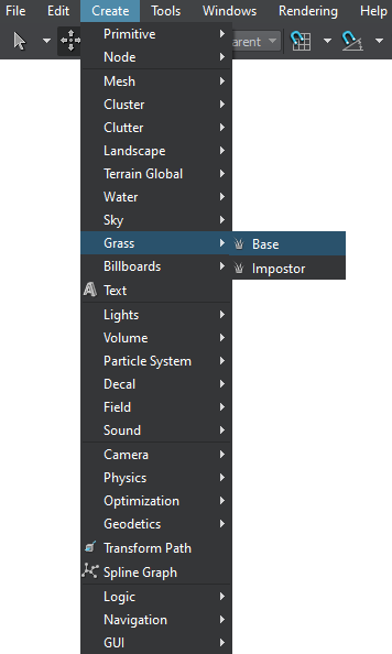

  1. In the Menu bar, choose Create -> Grass -> Base and drop the grass somewhere in the world.

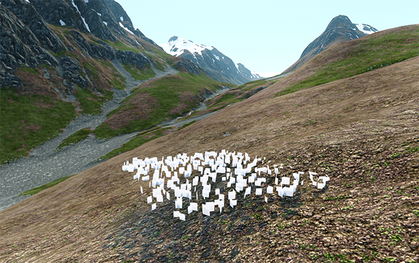

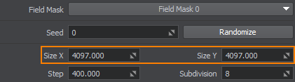

  4. In the Grass section of the Node tab, set the real size of the grass field: select both grass objects and set Size X (along the X axis) and Size Y (along the Y axis) to repeat the size of the 4097 × 4097 terrain.

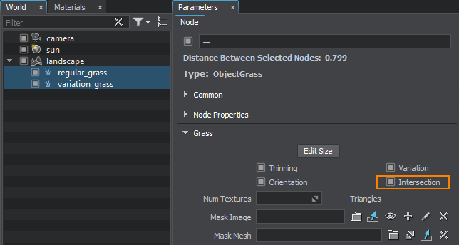

  5. Add the grass objects as child nodes to the terrain, so the grass can grow upon the terrain repeating its relief: select the grass nodes and drag them to the terrain node with the left mouse button pressed.
  6. Enable the Intersection option to allow intersection with a parent node.
    Now the grass grows upon the terrain (repeats its relief), but the field is still not positioned properly:

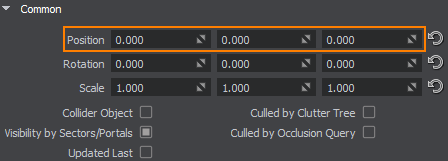

  7. In the Node tab of the Parameters window, reset the position of the grass objects to 0 relative to its parent in the Common section.
    Position of the grass object becomes synchronized with the terrain:

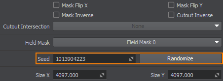

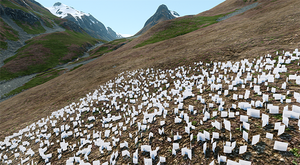

  8. Currently, coordinates of the grass quads of both objects are coincide. To avoid grass quads flickering, position grass quads of the grass_regular object differently: click Randomize (Node tab -> Grass section) to generate a random seed.

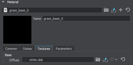

  2. Go to the Material section of the Node tab: currently, the base grass_base material is assigned to the grass nodes. Click Inherit or to create a new child material. The new material will be automatically assigned to both grass nodes.
  3. Rename the new material grass_regular in the Name field.

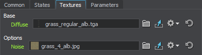

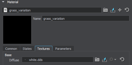

  5. Adjust the materials of the grass objects: for each material, go to the Textures tab and drag the diffuse texture to the corresponding field.
    You may want to manually edit the alpha channel of the mipmaps, because on automatically generated mipmaps thin blades may disappear incorrectly or unpleasantly.

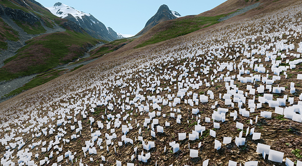

  6. Go to the Grass section of the Node tab. For both Grass objects, set the proper number of horizontal rows in the diffuse textures in the Num Textures field. For example, we have 4 rows for both grass objects, so the Num Textures must be set to 4.
    As you can see, the regular_grass node isn't rendered properly because there is no image mask. The diffuse texture of the regular grass contains only 1 column, so the 1-channelled image mask (R8) should be set.

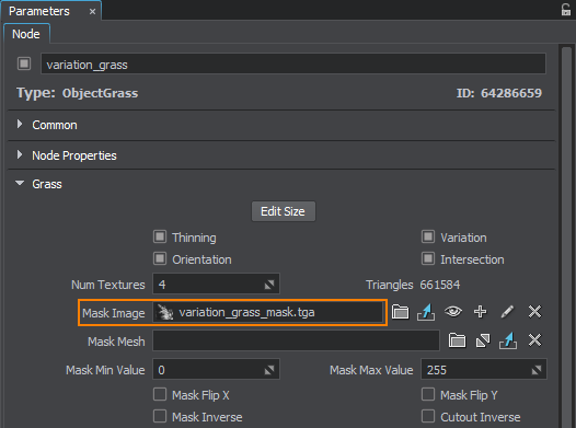

  7. Drag the correct R8 image mask from the Asset Browser to the corresponding field in the Grass section of the Node tab to fix rendering of the regular_grass node. We will set up all related parameters later.

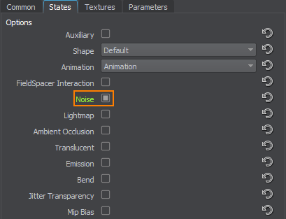

  8. Go to the States tab of the Material section (Node tab, Parameters window). Check the Noise option for the grass_regular material. It will allow you to color the blades of the regular grass differently across the whole field. The Noise option will also be set for the grass_variation material.
  9. For the grass_variation material, go to the States tab of the Material section and uncheck the Noise option. It will allow the grass of various types to differ from the regular grass.
  10. For the grass_regular material, go to the Textures tab and drag the spatial noise texture from the Asset Browser to the Noise field.

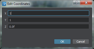

  11. Go to the Parameters tab of the grass_regular material. To the right of the Noise Transform field, click to edit the values (or modify the expression right in this field).
  12. Set the scale of texture coordinates by X and Y axes to 1: in this case, the spatial noise texture will cover the entire terrain.

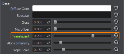

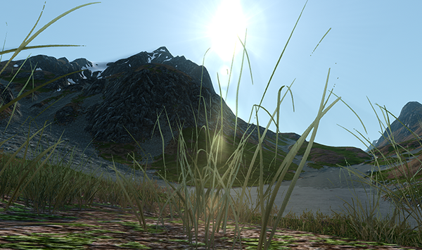

  14. The blades are quite thin, so make them a little bit more transparent to light when it shines from behind: increase the Translucent parameter up to 0.7 for the grass_regular material. For the grass_variation material it will be applied automatically.
    The grass will become more transparent and lighter:

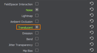

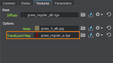

  15. Go to the States tab and enable the Translucent option for the regular grass. This will activate the Translucent Map in the Textures tab that allows specifying translucent areas of the grass blades.
  16. In the Textures tab, drag the translucent texture from the Asset Browser to the Translucent Map field.
    According to the texture, the translucence effect applied to the grass blades will be gradient.

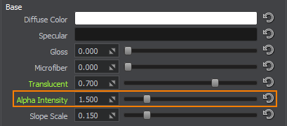

  18. Increase the Alpha Intensity to 1.5 to scale the Alpha channel of the diffuse texture of the regular grass. In the result, the grass field will look denser.

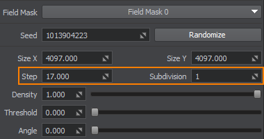

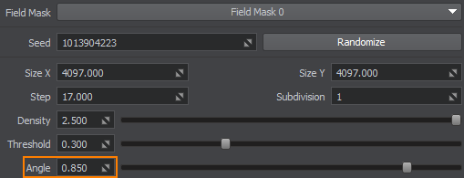

  1. First, set up the density of the grass. For the regular grass, go to the Grass section of the Node tab and drop the Step to 17. It will make the cells which are used to render the grass field smaller, however, this value is not so large to hit the performance when the cell is created.
    The Subdivision should be set to 1 to avoid additional subdivision of the grass cells: higher values of this parameter are usually used when the grass is used as a low-poly distant LOD of a forest created by using World Clutter or Mesh Clutter.
    The grass is regenerated. The density also changed, because it is defined for one cell. As we made the cell smaller, the grass turned out to be slightly more dense.

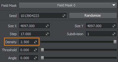

  2. Increase the Density of the regular grass in a cell to 2.5 to add more grass blades on the field. For the various grass, set this value to 0.5.

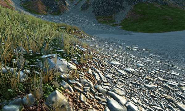

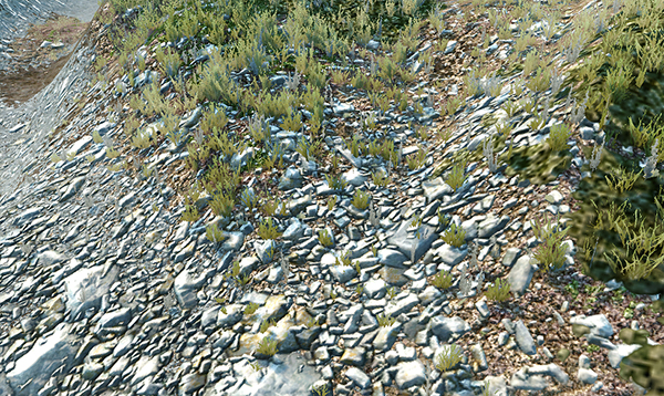

  3. Now tweak the spread of the grass. For the regular grass, we have already set the image mask. Now you should set it for the grass of various types: drag the RGBA8 image mask to the Mask Image field in the Grass section of the Node tab.
    The grass no longer grows on mountains peaks and stony areas:

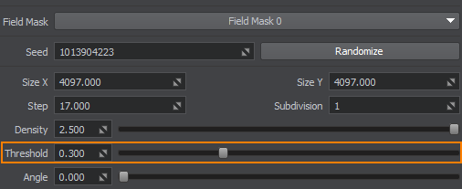

  4. Set the Threshold to 0.3 to increase the mask intensity.
    Perform this step for both grass objects.
    This will decrease the area that the grass covers:

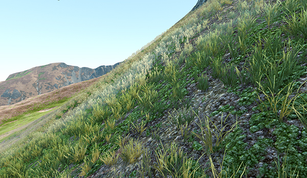

  5. Usually the grass does not grow on the steep hillsides. Increase the Angle to 0.85 to make steep areas grassless.
    Now the spread of the grass is more realistic:

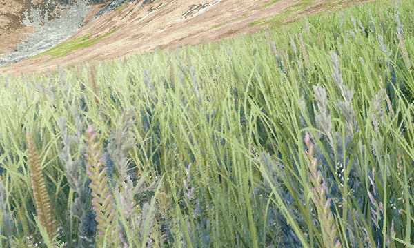

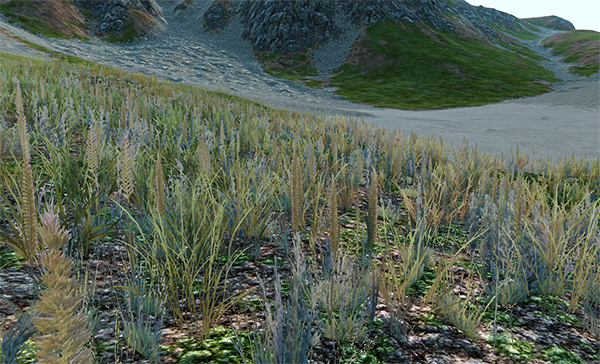

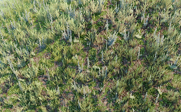

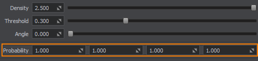

  6. Currently, all types of the grass of various types (in other words, slots of the diffuse texture of the grass_variation node) are spread uniformly across the grass field. However, in nature, one type of grass can predominate over the others or grow in small groups. To achieve this, change the Probability parameter so that one type of the grass will predominate over the other types according to the diffuse texture.
    For example, you can set the probability factor to 4 for the 3rd column of the diffuse texture:

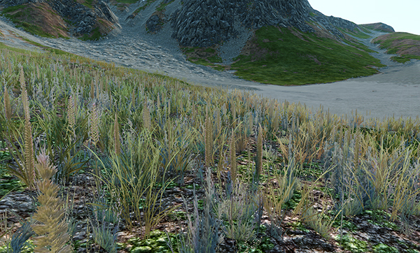

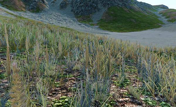

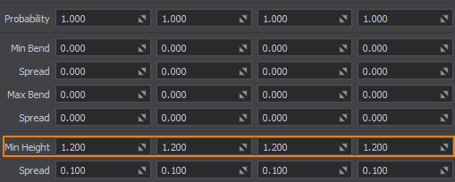

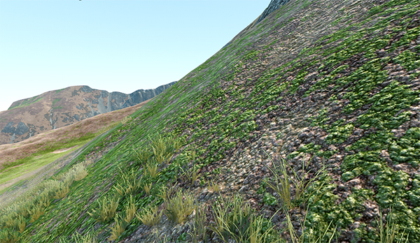

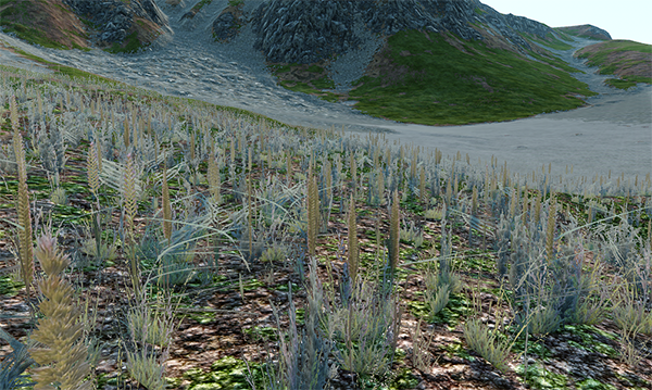

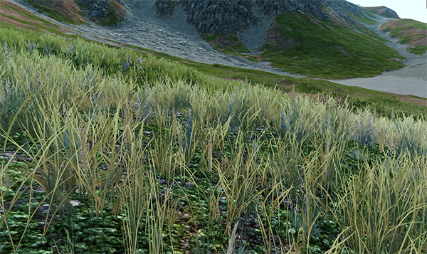

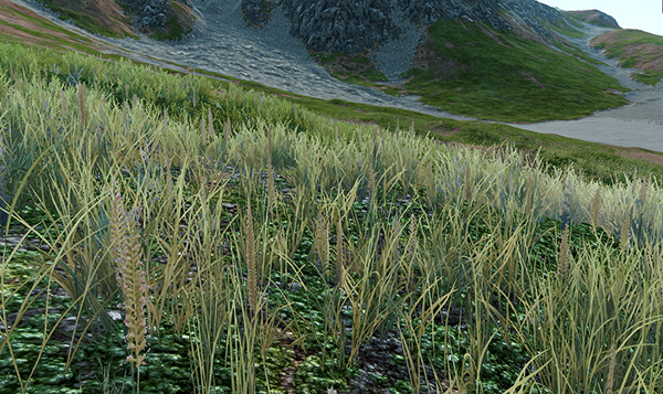

  1. When changing from bare areas to grassy ones, our grass starts to grow as small and thinned out. But on the stones, it does not look too good. Increase the Min Height up to 1.2. In areas with low density (according to the mask) the grass will be higher. You can set different height values for each of four columns in the diffuse texture, or leave it the same for all.
    Perform this step for both grass objects. For the regular grass, setting the value for the first column is enough.

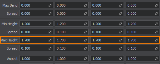

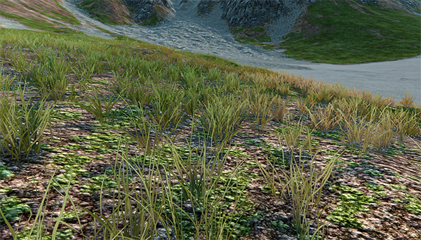

  2. Increase the Max Height of the grass blades to 1.7 units. In areas with high density (according to the mask) the grass becomes higher. We'll use the same height for all four columns in the diffuse texture as well.

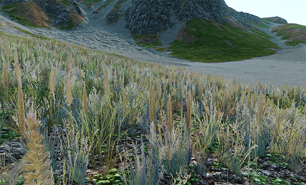

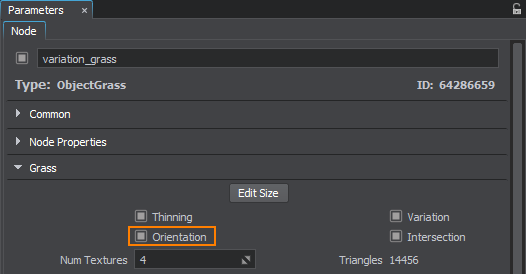

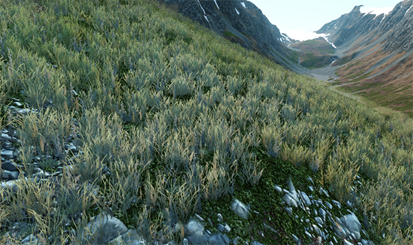

  3. Unlike trees, the grass is usually grows perpendicular to the terrain. Check the Orientation in the Grass tab of the Parameters window to orient the grass objects along the normal of the terrain. Perform it for both regular and variation grass.

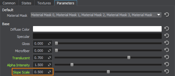

  4. From above the grass seems too flat. In the Material section of the Node tab (the Parameters window), go to the Parameters tab and increase the Slope to 0.5 to make it more billboard-like.
    The slope will be the same for both the grass_regular and grass_variation materials.

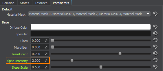

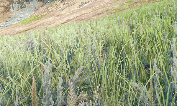

  5. Grass blades are too thin and sometimes appear in dashed lines. Increase the Alpha Intencity up to 2 to make the blades look thicker and the grass denser.

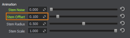

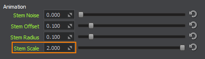

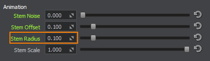

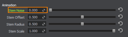

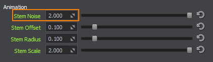

  1. In the Parameters tab of the Material section (the Node tab, Parameters window), set the Stem noise to 0 to make all the grass blades move uniformly. It will help to learn how to adjust the animation.
  2. Decrease the Stem offset to 0.1 to make the grass sway and stretch horizontally to a lesser degree.
  3. Decrease the Stem radius to 0.1 so that the grass does not bend down to the ground.
  4. Increase the Stem scale to 2 to make the grass move two times faster.
  5. Increase the Stem noise to 2 to make the blades movement more random.

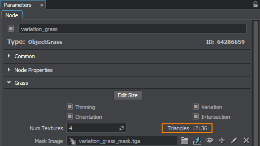

Grass optimization means reducing the number of grass polygons rendered each frame and the number of DIP calls. To optimize the grass that we added and set up above, we have already set the Step value to 17: the Size of the grass field is divided by this value exactly, with no remainder by division. This allows avoiding visual artifacts and unexpected visual effects. Also such value stays within the recommended optimal range.
The Thinning option is set for the grass objects by default: it allows reducing the number of grass polygons rendered across the grass Fade distance.
After changing the settings mentioned above, you can compare the previous and the current number of grass triangles: simply check the Triangles counter.
