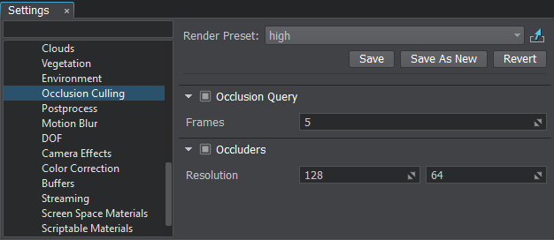

Occlusion Culling Settings
Occlusion Query | The value indicating if additional hardware occlusion query test before sending data to GPU is enabled. This test is performed for all objects with the Culled by occlusion query flag set. enabled by default.
Console access: render_occlusion_queries (API control) |
Frames | The number of frames for additional hardware occlusion query test performed before sending data to GPU. Make sure that the additional hardware occlusion query test (see the OcclusionQueries) is enabled. Range of values: [0, 1024]. The default value is : 5. Console access: render_occlusion_queries_num_frames (API control) |
Occluders#
Occluders | The value indicating if rendering of occluders is enabled. enabled by default.
Console access: render_occluders (API control) |
Resolution | The resolution of the texture, to which occluders (see the Occluders) are rendered. From 1x1 to 1024x1024 Default: 128x64 Console access: render_occluders_resolution (API control) |
