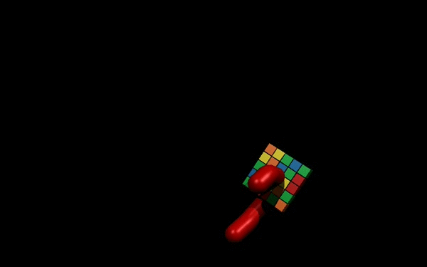

Transform Bone is an object that obtains transformations of the specific bone of the Skinned Mesh. The nodes that are made children of Transform Bone move in accordance with these transformations.
Skinned Mesh in the example contains 6 bones. Transform Bone with a multicolored set of boxes is assigned to its third bone

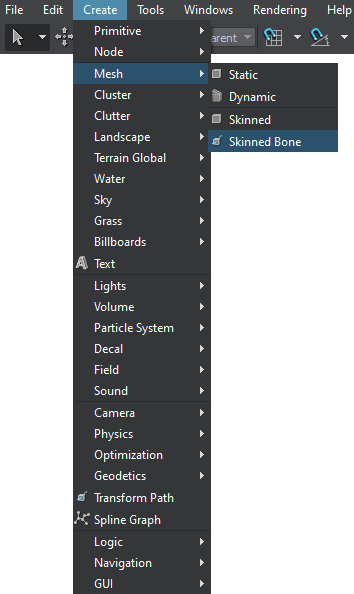

To add a Transform Bone to the scene via UnigineEditor, do the following:
  2. On the Menu bar, click Create -> Mesh -> Skinned Bone.
  3. Place the node somewhere in the world.

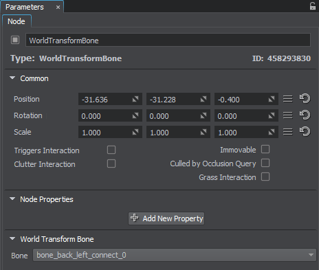

  6. In the Node tab, specify the Transform Bone parameters.
Parameters#
In the Node tab of the Parameters window, you can adjust the following parameters of Transform Bone:
Bone Specifies the bone, transformations of which are applied to objects.
