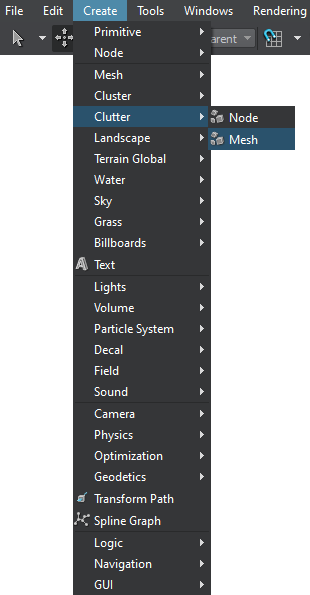

To create Mesh Clutter, simply perform the following steps:
  1. On the Menu bar, click Create -> Clutter -> Mesh.
  2. In the dialog window that opens, choose the path to the .mesh file. This mesh would be used as the source one for the Mesh Clutter.

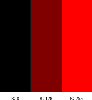

For example, if the following image mask is used:

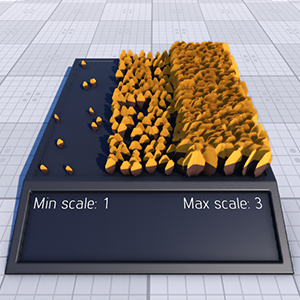

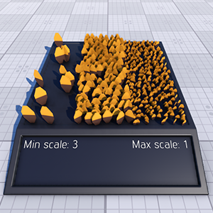

The Mesh Clutter objects will be scaled as follows:
Min scale = 1; Max scale = 3
Min scale = 3; Max scale = 1

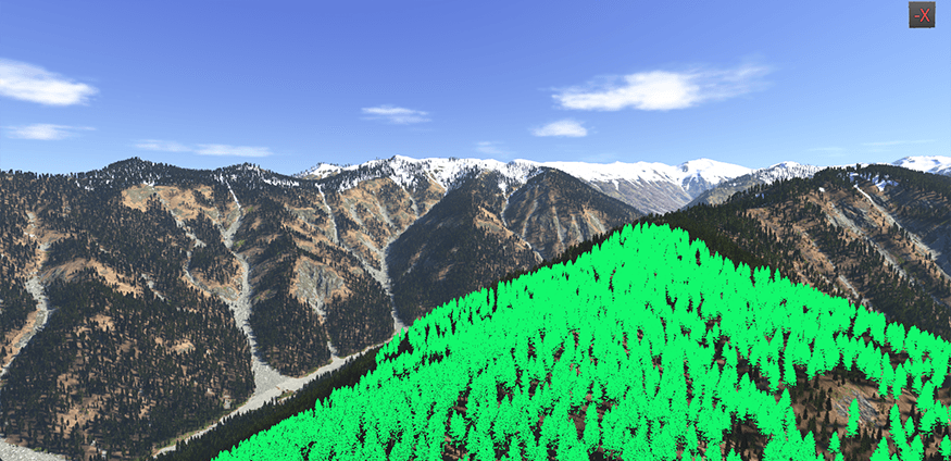

Terrain Mask Mask of the Landscape Terrain to be used to define the area where the Mesh Clutter object is to be placed.

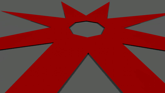

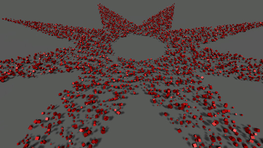

Mesh Mask A mesh-based mask can be used to place the objects. Vector masking makes it possible to create roads, rivers, etc. with extremely high precision regardless of the mask texture resolution. A mesh for masking should be a simple planar mesh.
Mesh used as a mask
Mesh-based masking

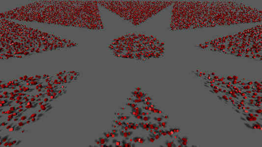

Inverse The Inverse flag toggles if the objects are placed inside or outside the mesh contour.
Inverse masking

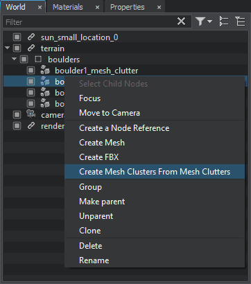

Creating Mesh Clusters from Mesh Clutters#
If you require more freedom in adjusting an existing Mesh Clutter, you can convert it to a mesh cluster using the relevant context-menu option.
