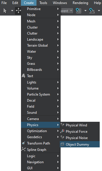

To add a Dummy Object to the scene via UnigineEditor do the following:
  1. Run UnigineEditor.
  2. On the Menu bar, click Create -> Physics -> Object Dummy.
  3. Place the Dummy Object somewhere in the world.
