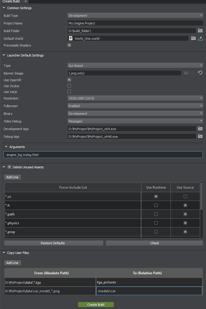

To create a final build for your project via UnigineEditor, perform the following:
  1. In UnigineEditor, select File -> Create Build. The Create Build window will open.
  2. Specify the required settings and click Create Build.

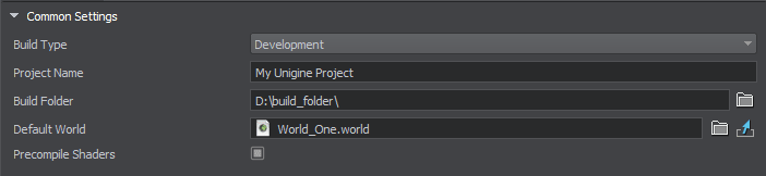

Common Settings#
Build Type
(config)
Type of the build that defines which binaries are copied:
  • Release — optimized binary without any additional debug info.
  • For the Development build, two binaries are copied:
    • development binary — optimized binary with Microprofile enabled
    • debug binary — unoptimized binary with debug information enabled
If the project's SDK is unavailable, this option is unavailable, as well. In this case, Build Type is defined by the build of UNIGINE Engine selected at the project creation.
Project Name
(name)
Name of the output executable or .bat/.sh file. This name shall also be displayed as the Launcher's title and a title of the application window as well.
Build Folder
(path)
Path to the output folder where the build is going to be stored
  • You shouldn't create this folder inside your project folder, as it may significantly increase its size.
  • Build folder should be empty, otherwise, its contents will be deleted!
Default World
(world)
The world that is loaded when the application is started. If no world is selected, the User shall be responsible for loading worlds via code, otherwise, a black screen will be displayed when running the application.
Precompile Shaders
(precompile)
If enabled, generates shaders for the current Video API.
Shader cache increases performance and reduces spikes and freezes in the release application, which makes it very important for the release build. If the shaders have already been precompiled, selecting this box won't affect the build time.

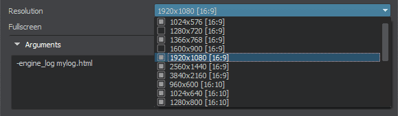

Resolution
(selected_res)
The resolution of the application screen. Multiple resolutions can be selected. The resolution that is clicked upon is set as default.
Multiple resolutions for the console mode are specified in the configuration file via the resolutions parameter (list the ones you need):

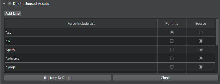

Delete Unused Assets#
The corresponding video tutorial is also available.
This feature enables you to delete all unused assets from the final build. To turn it on, check the option near the Delete Unused Assets section heading.
The table enabled below allows you to specify assets to be force-included in your final build. Here is how it looks:
The Build tool scans all assets of the types specified as wildcards (including location) in the Force-Include list (*.world, *.cs, *.fbx, *.prop, etc.), automatically resolving all dependencies (an FBX asset shall be checked for all meshes, meshes shall be checked for materials assigned to their surfaces and so on...). Thus, all assets in your project that are used by the assets of the specified types are collected and included in the final build.
You can add more asset types to the list or remove existing ones by simply right-clicking on the desired line (a new line shall be inserted after the one you clicked on). You can also click Restore Defaults to reset the list to its initial state.
For each type of assets in the list you can specify whether to include runtime or source file. But be careful, as checking only Runtime for .png textures will result in ignoring the ones with the Unchanged option enabled (i.e. having no runtime), they simply won't be included. To check your list against such cases click Check, the following Check List window will open:

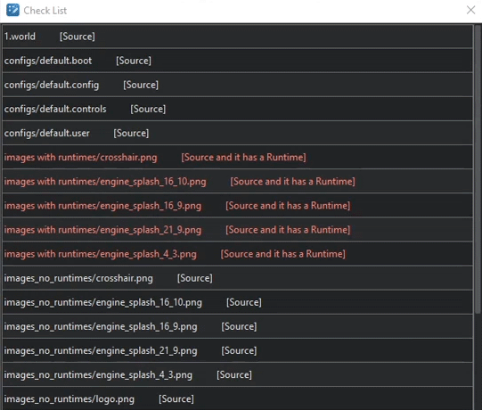

In this window all files found in the process of scanning are listed. The ones in white are ok, but the ones in red require your attention, for example, you may mistakenly choose to include source for an asset that has a runtime. So, be sure to look through red ones. The following options are possible:
  • [Source and Runtime] - both boxes are checked (both source and runtime files shall be added).
  • [Source] - when Source is checked and the asset has no runtime (only the source shall be added).
  • [Source and it has a Runtime] (shown in red) - when Source is checked, but the asset has a runtime (only the source shall be added).
  • [Runtime] - when Runtime is checked, and the asset has a runtime (only the runtime shall be added).
  • [No Runtime] (shown in red) - when Runtime is checked, but the asset has no runtime (nothing shall be added).

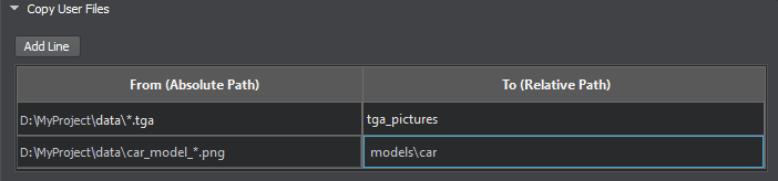

Copy User Files#
User files are added to the build folder by filling in the table with two columns:
  • From (Absolute Path) — an absolute path to a source file or folder. Folders can be specified using wildcards.
  • To (Relative Path) — path to the destination folder that is relative of the Build Folder. It can be a folder name where the file or files are copied to, or a folder and a file name, i.e. the copied file can be renamed as well.
There are some rules for adding user files to the build folder:
From (Absolute Path) To (Relative Path) Comment
C:\test\<folder_name> <another_folder_name>, or
\<another_folder_name>, or
\<another_folder_name>\
All files and folders inside <folder_name> will be recursively copied. Thus, it doesn't matter if you use slashes or not.
C:\Pictures\screenshot_alb.png \folder_with_pictures\, or
One file with the name indicated in the From column will be copied into <output_folder>\folder_with_pictures\
C:\Pictures\screenshot_alb.png \folder_with_pictures\123.png
But: 123.jpg (or 123.png)
The file will be renamed.
However, if the target file extension is written incorrectly (differs from the actual file extension), a new folder with such name will be created instead, i.e. the resulting path of the example destination files will be:
