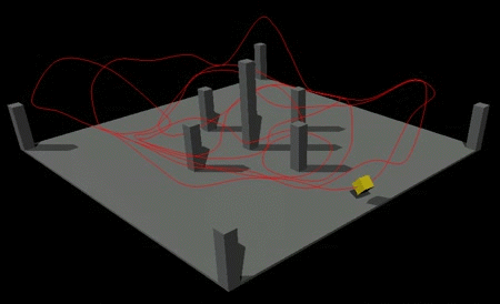

Transform Path is a succession of transformations based on an arbitrary path. The objects that are made children of the Transform Path can move along with these transformations.

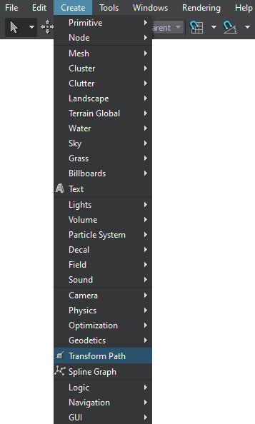

To add Transform Path to the scene via UnigineEditor, do the following:
  2. On the Menu bar, click Create -> Transform Path.
  3. Choose the path to the .path file.
    The path can be changed afterwards in the World Transform Path section of the Parameters window.
  4. Place the object somewhere in the world.

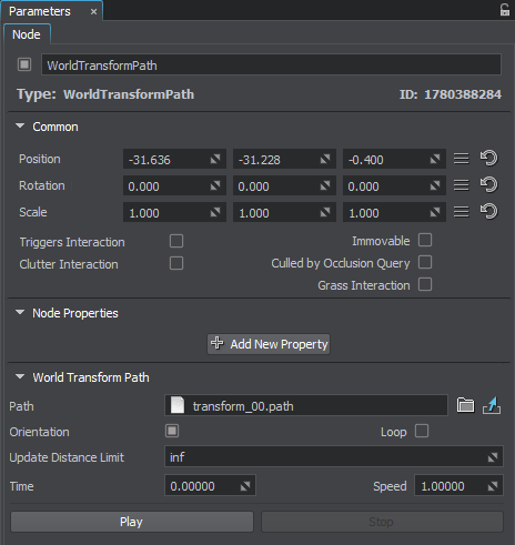

Parameters#
In the Node tab of the Parameters window, you can adjust the following parameters of Transform Path:
Path Sets a path to the new .path file.
Orientation Indicates whether the object should be oriented along the path or keep its initial position.
Playback Parameters#
Transform Path has the following playback parameters:
Loop Loops the transformation defined by the path.
Update Distance Limit Sets the distance from the camera within which the object should be updated.
Time
Sets the time, from which the playback of the transformation defined by the path starts.
If the object is oriented along the path, its transformation corresponds to the path transformation at the specified time. Otherwise, only the object position is changed.
Speed
Sets the speed of the transformation playback.
Negative values provide the reverse playback.
Play Continues playback of the transformation defined by the path if it has been paused, or starts the playback, if it has been stopped.
Stop Stops the playback of the transformation defined by the path. This function saves the playback position so that playing of the transformation defined by the path can be resumed from the same point.
