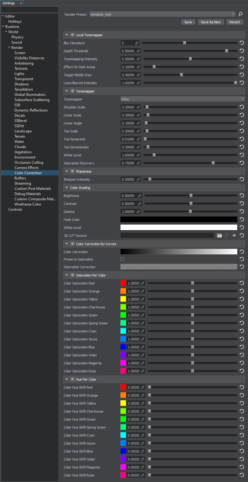

Color Correction
This section describes settings for color correction of the scene.
Scene Color Settings

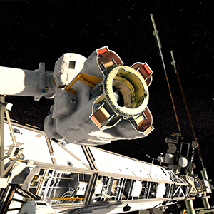

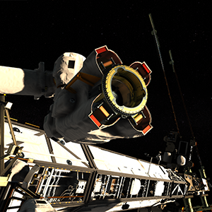

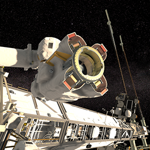

Local Tonemapper#
Local tone mapping uses a spatially varying mapping function determined by the neighborhood of a pixel, which allows an increase in the local contrast and the visibility of some details of an image. The local tonemapper enables the generation of a mask based on the entire image, providing more pleasing results because human vision is more sensitive to local contrast.

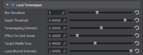

Local Tonemapper Settings
Local Tonemapper The value indicating if the local tonemapper is enabled. disabled by default.
Console access: render_local_tonemapper (API control)
Blur Iterations The number of blur iterations applied to the screen texture, which is used to define bright and dark portions of the screen. A higher number of iterations increases the blur radius and reduces halo artifacts around objects, but may affect performance.
Range of values: [0, 10]. The default value is : 5.
Console access: render_local_tonemapper_num_blur_iterations (API control)
Depth Threshold The depth threshold value used to detect the areas affected by local tonemapping. A properly set value may help to reduce halo artifacts.
Range of values: [0.0f, 1.0f]. The default value is : 0.9f.
Console access: render_local_tonemapper_depth_threshold (API control)
Tonemapping Intensity The intensity of the local tonemapping effect.
Console access: render_local_tonemapper_tonemapping_intensity (API control)
Effect On Dark Areas The the extent of applying the local tonemapping effect on dark areas.
Range of values: [0.0f, 1.0f]. The default value is : 0.1f.
Console access: render_local_tonemapper_effect_on_dark_areas (API control)
Target Middle Gray The the target middle gray value for tonemapping.
Range of values: [0.0f, 1.0f]. The default value is : 0.4f.
Console access: render_local_tonemapper_target_middle_gray (API control)
Luma Blurred Intensity The intensity of blurring the luma values. It is recommended to keep the default value for this setting. With the value set to 0, a regular screen texture is used instead of a blurred screen texture. This might be required in a rare case of reducing the halo effect and increasing the tonemapping effect for small details.
Console access: render_local_tonemapper_luma_blurred_intensity (API control)
Tonemapper#
The tone mapping provides better image quality by remapping high dynamic range (HDR) colors into a range suitable for mediums with low dynamic range (LDR), like LCD or CRT screens. Its most common purpose is to make an image with a low dynamic range appear to have a higher range of colors providing a more dynamic and realistic effect. It lightens the darkest image regions and makes the lightest regions darker.
When using an HDR camera, always apply tonemapping, otherwise color intensity values exceeding 1 will be clamped at 1, altering the luminance balance of the scene.
Tonemapper settings
Tonemapper The value indicating if tone mapping is enabled. enabled by default.
Console access: render_tonemapper (API control)
Tonemapper Mode The mode of tone mapping. One of the following values:
  • Filmic
  • ACES (by default)
  • ACES with Reinhard
  • Reinhard
  • Reinhard Luma-Based
Console access: render_tonemapper_mode (API control)

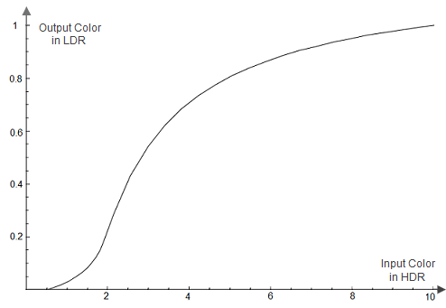

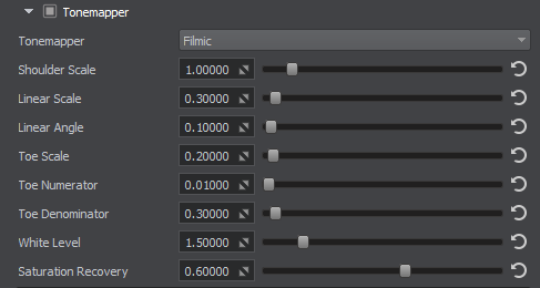

Filmic#
Parameters described below represent John Hable's artist-friendly tonemapping curve, which is constructed by using the following formula:
  • A — Shoulder Scale
  • B — Linear Scale
  • C — Linear Angle
  • D — Toe Scale
  • E — Toe Numerator
  • F — Toe Denominator
Tone Mapping Curve
For more details about tone mapping curve construction see the article on Filmic Tonemapping with Piecewise Power Curves.

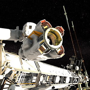

Shoulder Scale The Shoulder Strength tonemapping parameter value that is used to change bright values.
Range of values: [0.0f, 1.0f]. The default value is : 0.2f.
Console access: render_filmic_shoulder_scale (API control)
Shoulder Scale = 0.2 (by default)
Shoulder Scale = 1
Linear Scale The Linear Strength tone mapping parameter value that is used to change gray values. The Linear Scale controls the length of the tone mapping curve linear part.
Range of values: [0.0f, 1.0f]. The default value is : 0.3f.
Console access: render_filmic_linear_scale (API control)
Linear Scale = 0.3 (by default)
Linear Scale = 1
Linear Angle The Linear Angle tone mapping parameter value. This parameter controls the slope of the linear part of the tone mapping curve.
Console access: render_filmic_linear_angle (API control)
Linear Angle = 0.10 (by default)
Linear Angle = 1
Toe Scale The Toe Scale tonemapping parameter value that is used to change dark values. The Toe Scale controls the slope of the tone mapping curve toe (the area of underexposure).
Console access: render_filmic_toe_scale (API control)
Toe Scale = 0.20 (by default)
Toe Scale = 1
Toe Numerator The Toe Numerator tonemapping parameter value.
Range of values: [0.0f, 1.0f]. The default value is : 0.01f.
Console access: render_filmic_toe_numerator (API control)
Toe Numerator = 0.01 (by default)
Toe Numerator = 0.08
Toe Denominator The Toe Denominator tonemapping parameter value.
Console access: render_filmic_toe_denominator (API control)
Toe Denominator = 0.3 (by default)
Toe Denominator = 1
White Level The Linear White Point tonemapping parameter value, which is mapped as pure white in the resulting image.
Console access: render_filmic_white_level (API control)
White Level = 1.0 (by default)
White Level = 0.5
Saturation Recovery The color saturation recovery value for the filmic tonemapper. Filmic tonemapper desaturates image colors in bright areas making them look grayish. This parameter enables you to recover initial color saturation in such areas. Higher values make colors more saturated:
  • 0.0f - standard filmic tonemapping, no saturation recovery is performed.
  • 1.0f - color saturation is recovered to the full extent.
When the 1.0f value is set specular highlights appear too saturated, so the recommended value is 0.75f (default)
Range of values: [0.0f, 1.0f]. The default value is : 0.75f.
Console access: render_filmic_saturation_recovery (API control)
White Level = 0.5
ACES#
White Clip The white clip parameter for the ACES operator. Controls the cut-off point for white.
Range of values: [0.0f, 10.0f]. The default value is : 2.51f.
Console access: render_aces_white_clip (API control)
Toe The toe parameter for the ACES operator. Controls the dark color. Higher values result in darker colors.
Range of values: [0.0f, 10.0f]. The default value is : 0.03f.
Console access: render_aces_toe (API control)
Shoulder Angle The shoulder angle parameter for the ACES operator. Controls how much overshoot should be added to the curve's shoulder.
Range of values: [0.0f, 10.0f]. The default value is : 2.43f.
Console access: render_aces_shoulder_angle (API control)
Shoulder Strength The shoulder strength parameter for the ACES operator. Controls the strength of the transition between the curve's midsection and the curve's shoulder.
Range of values: [0.0f, 10.0f]. The default value is : 0.59f.
Console access: render_aces_shoulder_strength (API control)
Shoulder Length The shoulder length parameter for the ACES operator. Controls the amount of f-stops to add to the dynamic range of the curve. Defines how much of the highlights the curve takes into account.
Range of values: [0.0f, 1.0f]. The default value is : 0.59f.
Console access: render_aces_shoulder_length (API control)
Mix ACES With Reinhard#
Mix With Reinhard The ACES with Reinhard tonemapping operator contribution. If the value is closer to 0, then ACES prevails. Otherwise, when the value is closer to 1, the Reinhard has a grater impact.
Console access: render_aces_with_reinhard_mix (API control)
Reinhard#
Contribution The Reinhard tonemapping operator contribution.
The value is calculated according to the following formula: C / (1 + C) It controls the overall contribution that the Reinhard operator makes to the final color grading of the image. The higher values result in more tonemapping contribution to the final image.
Console access: render_reinhard_contribution (API control)
Reinhard Luma-Based#
Contribution The Reinhard Luma-Based tonemapping operator contribution. Controls the overall contribution that the Reinhard operator makes to the final color grading of the image. Higher values result in more tonemapping contribution to the final image.
Console access: render_reinhard_luma_based_contribution (API control)
Sharpness#
Sharpness The value indicating if the sharpening post-processing effect is enabled. disabled by default.
Console access: render_sharpen (API control)
Sharpen Intensity The intensity of the sharpening effect.intensity of the sharpening effect. To use this option, sharpening post-processing effect should be enabled (see the Sharpen).
Range of values: [0.0f, inf]. The default value is : 0.5f.
Console access: render_sharpen_intensity (API control)
Color Grading#
Brightness
Correction of the overall scene brightness:
  • Positive values lighten the colors up to white.
  • Negative values darken the colors up to black.
Contrast
Correction of the overall scene contrast:
  • Positive values increase the contrast.
  • Negative values decrease the contrast.
Gamma Correction of the overall scene gamma.
Fade Color The fade color for the scene on the screen. By gradually changing this value it is possible to create "fade in" and "fade out" effects depending on the w component of the given vector. For example, when the following vectors are passed the result will be:
  • vec4(1,1,1,1) - a fully white screen. Positive w results in additive blending.
  • vec4(0.5,0.5,0.5,1) - light colors on the screen.
  • vec4(1,0,0,1) - R channel for all screen colors is to its maximum; G and B without changes.
  • vec4(0,0,0,0) - there is no fading (no color alterations are done to the screen).
  • vec4(1,1,1,-1) - a fully black screen. Negative w results in scene colors * (1 - RGB), where RGB is the first three components of the passed vector.
  • vec4(0.5,0.5,0.5,-1) - dark colors on the screen.
vec4_zero - default value (white)
Console access: render_fade_color (API control)
White Level White level of the scene.
3D LUT Texture The loading, viewing, or clearing of the Lookup Table texture for color transformation.

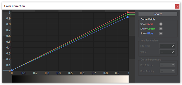

Color Correction by Curves#
Color Correction
Tonal range and tone response of the final image. The horizontal input color values are mapped to the vertical output values based on curves for Red, Green and Blue channels. By adjusting all three channels at once, you control the luminance of the final image.
Color correction curves
Preserve Saturation Preserve initial scene color saturation after applying color correction.

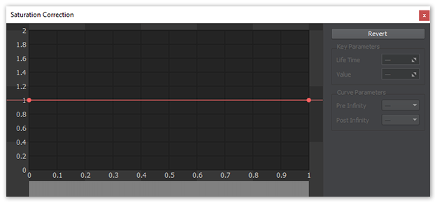

Saturation Correction
Correction curve of the overall scene saturation. The input luminance values are mapped to the vertical saturation values:
  • The higher the value, the more saturated and vibrant the colors are.
  • The lower the value, the duller and more colorless the colors are.
Saturation curve
Control the saturation of shadows by adjusting the values on the left, highlights - on the right.

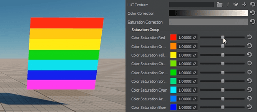

Saturation and Hue#
Saturation per Color
Saturation fine-adjustment for 12 major colors of the spectre.
Saturation adjustment

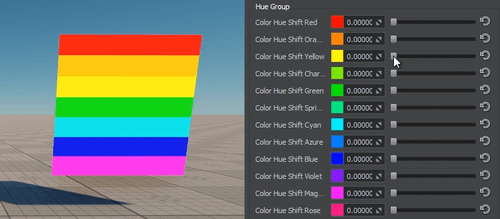

Hue per Color
Hue (color shift) fine-adjustment for 12 major colors of the spectre.
Hue adjustment

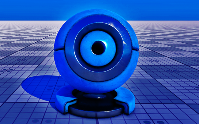

Color Correction LUT#
Color Correction LUT (Lookup Texture) is an optimized way of performing color grading in a post effect. Instead of tweaking individual color grading parameters, only a single texture is used to produce the corrected image. The lookup is performed by using the original image color as a vector to address the lookup texture.
One of the most common applications of lookup tables is to use them to see how images look in different media, such as TV/video or film, which have different color capabilities. Using a lookup table designed to mimic a certain display medium gives a much better idea what your current work will look like after it’s transferred to that medium.
Advantages of using a Color correction LUT include:
  • Better performance — realtime computation is replaced by a simple array indexing operation.
  • More professional workflow opportunities, where all color transforms can be defined using professional image editing software (such as Photoshop or GIMP), which provides a more precise result.
Simple scene with neutral color correction applied.
Same scene using the lookup texture with shadows, highlights and vibrance applied.
Various visual effects can be created by changing the color correction LUT dynamically in realtime.
