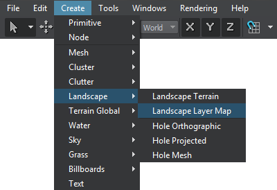

Create a new Landscape Layer Map via either of the following ways:
  • By creating a node:
    1. In the Create menu, select Landscape -> Landscape Layer Map and place the new Landscape Layer Map node in the scene.
    2. By default, the map has the white, flat and read-only landscape_layer_map_base.lmap asset set in the Landscape parameter. Click Create to create a new landscape layer asset.

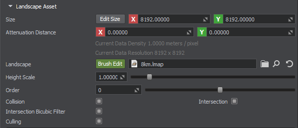

Landscape Asset Parameters#
Size Width and Length, in units (meters). Click Edit Size to toggle the size editing mode.
Attenuation Distance Distance of the transparency attenuation, starting from the edge of the map.
Current Data Density
Landscape Layer Map density calculated as the ratio of the Size to the Resolution, in meters/pixel.
The ratio is calculated for both dimensions separately: the spatial Width is divided by the texture Width, the same is done for the Length and the texture Height, and the maximum ratio value is considered the Current Data Density in meters/pixel.
Landscape
.lmap asset to store the landscape data. By default, it is the blank read-only landscape_layer_map_base.lmap asset, to edit the layer map you can create a new asset by using the Create button or specify an existing one. Brush Edit opens the Brush Editor.
Several Landscape Layer Maps can refer to the same .lmap asset without extra memory required.
Height Scale Scale multiplier along the Z axis.
Order The layer rendering order used in layers blending (higher numbers on top).
Collision Collision with the map.
Intersection Intersection with the map.
Intersection Bicubic Filter Enables bicubic filtering for intersection detection.
Culling Streaming is based on using previously loaded geometry to define what is going to be streamed next. This option enables uploading preliminary low-level data of all maps to CPU to be used for initializing the streaming. If disabled, only low-level data of the base map is uploaded on CPU.

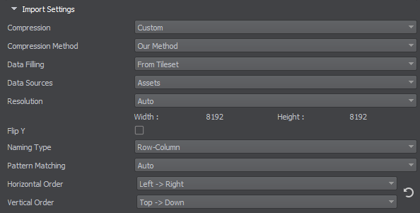

Import Settings#
Import Settings are the settings of the .lmap asset associated with the Landscape Layer Map node.
There is a set of buttons to work with import settings:
Restore Defaults Reset all settings to the default values.
Apply Save and apply changes to the import parameters without reloading graphic resources. Click Apply after selecting a compression method option.
Reimport Reload all graphic resources with respect to the specified import parameters. Click Reimport after making any changes to the import settings to apply them.
Cancel Discard changes made to the import parameters.
Import settings:
Compression
Compression options:
  • Off — compression is disabled (maximum file size).
  • Lossless — lossless compression Our Method is enabled, all lossy compressions are disabled.
  • Lossy — lossless compression Our Method is enabled, all lossy compressions are enabled for all data (Lossy Compression checkboxes are checked).
    Use of Lossy compression will lead to quality deterioration every time the data is compressed.
  • CustomCompression Method combo box appears below, Lossy Compression checkbox appears for Albedo and Masks.
Compression Method
Compression method options:
  • Our Method — recommended. UNIGINE compression method optimized for compressing 2D and 3D textures. It provides better results than LZ4 and Zlib without deteriorating the quality.
  • Zlib — for high compression ratio (can provide up to 2 times higher compression ratio, but takes up to 20 times longer).
  • LZ4 — temporary option, planned to be removed in the upcoming releases.
Data Filling
Origin of terrain data:
  • Manual — this type of data is selected for work with brushes.
    The only setting available for this option is Resolution.
  • From Tileset — this type of data is used to add any available data sources.
Data Sources
Where data is taken from:
  • Assets — available asset files. This option is good for small terrains.
  • External files — absolute path to the file is indicated (for example, network disk). A recommended option in case of creating a huge terrain using high-density graphic data.
The engine doesn't track the changes made to external files. If there are some changes, you can update graphic data via the Reimport button.
Resolution
Resolution of maps limited only by available video memory. The following values are available:
  • Manual — set by the user. Graphic data from textures is remapped to fit the resolution.
  • Auto — automatically detected from the specified textures, the resolution of the biggest texture is used. If a tileset is specified the resulting resolution of all tiles combined will be considered.
Flip Y Flip tiles along the Y axis.
Naming Type
The source tileset layout type. The following values are available:
  • Row Column — the row-column based tileset. When set, each tile of the source tileset is determined by the row and column numbers (e.g. tileset_x0_y2.png).
  • Indexed — the index-based tileset. When set, each tile of the source tileset is determined by the index (e.g. tileset_0.png). The number of columns of the source tileset is specified in the Number of Columns field.
Pattern Matching
  • Auto — automatically select the naming pattern.
  • Manual — manually specify the naming pattern.
Pattern A string naming pattern (e.g. _x%X_y%Y for the Row Column naming type or _%X for the Indexed type).
Number of Columns The number of columns in the tileset.
Horizontal Order
Horizontal loading direction of the source tileset.
  • Left -> Right
  • Right -> Left
Vertical Order
Vertical loading direction of the source tileset.
  • Top -> Down
  • Down -> Top

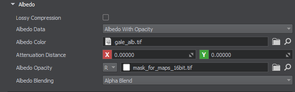

Albedo#
When Data Filling is Manual, the only settings available are Lossy Compression and Albedo Blending.
Lossy Compression Enables lossy compression.
Albedo Data
  • None — no data of this type is available at all.
  • Only Albedo — load the specified albedo data as is. In this case, data of this layer will always overlap data of underlying layers.
  • Albedo with Opacity — load the specified albedo map with an additional opacity mask applied. The mode is useful for blending albedo data with data of underlying layers.
Albedo Color Albedo color image.
Albedo opacity Sets the albedo opacity map and channel where data is stored.
Albedo Blending
  • Alpha-Blend — the colors of this layer map and the underlying one are blended.

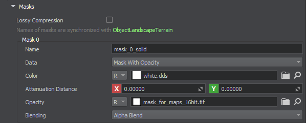

Masks#
When Data Filling is Manual, the only settings available are Lossy Compression, Name and Blending.
Name
The mask name, which is synchronized with the current active ObjectLandscapeTerrain. On change, no reimport required.
Names of masks are stored by Landscape Terrain objects, i.e. names shown in the parameters of a Landscape Layer Map will change in correspondence with the current enabled Landscape Terrain.
Data
  • Only Mask — load the specified texture as is. In this case, data of this layer will always overlap data of underlying layers.
  • Mask with Opacity — load the specified mask with an additional opacity mask applied. The mode is useful for blending the mask with data of underlying layers.
Color
The image and its channel to be applied as mask to the LandscapeLayerMap.
Instead of specifying a single-color image for the mask, you can set the Default Value for it and avoid excessive data loading.
Opacity Sets the opacity map and channel where data is stored.
Blending
Mode of blending this detail layer with other data layers:
  • Alpha-Blend — the corresponding masks of this layer map and the underlying one are blended.
  • Additive — data of the layer map is added atop.
  • Overlay — added data replaces the data below it.
  • Multiplicative — the colors of the masks are multiplied.
Enter the Masks Debug mode by using the Landscape Masks helper in the Editor or via the render_show_landscape_mask N console command, where N is the index of a mask from 1 to 20.
