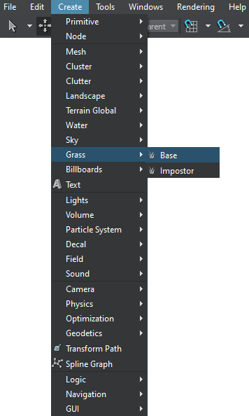

To add grass to the world, perform the following:
  1. On the Menu bar, click Create -> Grass -> Base.
  2. Place the object somewhere in the world.
The default grass field would appear with the grass_base material assigned.

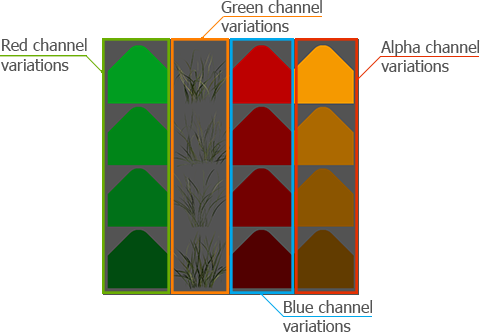

Mask
RGBA8: each channel controls distribution of the chunks in the vertical column of the grass diffuse texture.
  • Red channel specifies the areas of growth for the 1st texture column.
  • Green — for the 2nd texture column.
  • Blue — for the 3rd texture column.
  • Alpha — for the 4th texture column.
In case R8, RG8, or RGB8 texture is used as a mask, the diffuse texture must have only one, two, or three columns. So, if your diffuse texture contains, for example, only 1 vertical column, the R8 texture should be used.
0 mask channel values (no color) create areas where grass should not grow. Non-zero channel values create a grassy area: the higher the value, the denser grass grows.
If the mask texture is not set, the default white texture is used. It doesn't have a predefined amount of channels: the type of this texture depends on the value set in the Num Textures field. So, if Num Textures = 2, the default mask texture will be RG8.
Set in the ObjectGrass -> Node tab -> Grass section - > Mask Image field.

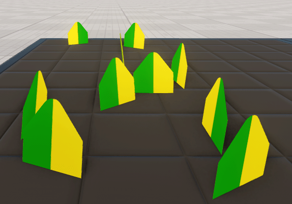

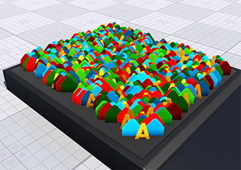

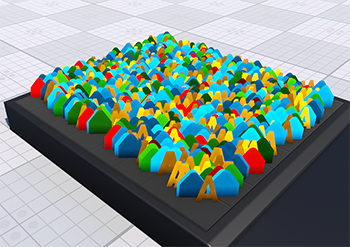

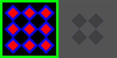

For example, we have the following diffuse and mask textures:
Diffuse texture
RBG and A channels of the mask
We see that in the first column, chunks of the green shades correspond to the red channel of the mask, which is 9 red rhombuses; in the second column, chunks of the real grass variation correspond to the green channel of the mask, which is the square green mask frame; in the third column, chunks of the red shades correspond to the blue channel of the mask, which is the blue rhombuses frames; and in the fourth column, chunks of the yellow shades correspond to the alpha channel of the mask, which is the rest black areas (note that these parts won't re rendered, as there no alpha color data).
The result will be as follows:

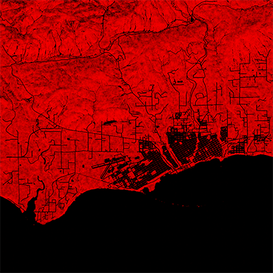

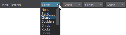

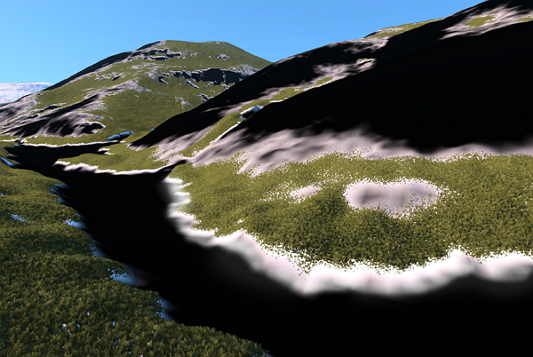

Terrain Mask#
The same way as by an arbitrary image mask, the grass density distribution can be defined by ObjectLandscapeTerrain masks. If a Landscape Terrain object is present in the world and has some masks provided, the names of the masks are available in the Mask Terrain parameter, so you can specify a certain landscape mask for each grass texture slot (grass type).
Grass distribution based on a landscape mask. Landscape Masks helper is enabled
