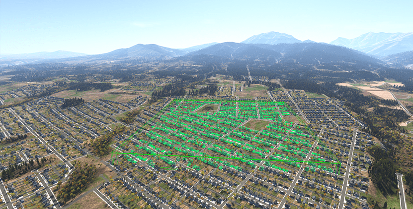

The mesh cluster is usually used for objects of the same type, for example, houses in neighborhoods.
Meshes of the mesh cluster object that are visible in the viewing frustum are loaded, meshes outside the frustum are culled. Using the mesh cluster is very efficient performance-wise: it substantially speeds up rendering and allows handling a lot of objects without any performance drop.

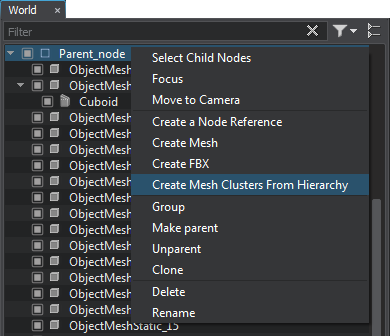

To create a mesh cluster by baking all identical meshes in the hierarchy, right-click the parent node of the hierarchy in the World Hierarchy window and select Create Mesh Clusters From Hierarchy in the context menu.

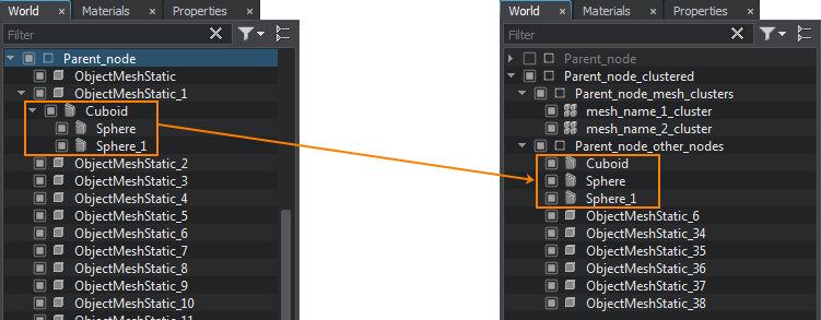

Applying this operation creates a dummy node with the _clustered postfix added to the parent node name. This dummy node contains two child nodes:
  • Node that is a parent of all mesh clusters. This node is named by adding the _mesh_clusters postfix to the source parent node name. Mesh cluster names are formed using the mesh name and the _cluster postfix.
  • Node that is a parent of all other child nodes of the source parent node. This node is named by adding the _other_nodes postfix to the source parent node name.
The created clusters contain all identical meshes of the source node including meshes that are referenced by Node References. Other nodes are added as a linear list. The source node is disabled.
Creation of a clustered node: nodes that are not in clusters are added as a linear list

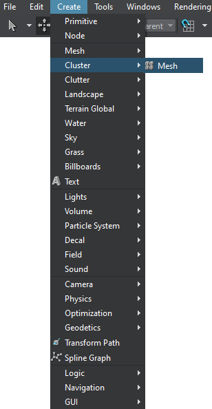

  1. On the Menu bar, click Create -> Cluster -> Mesh.

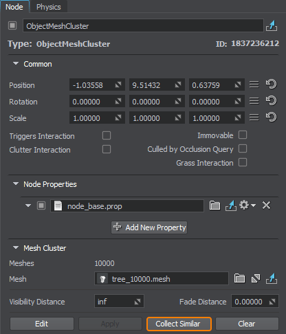

  5. Click Collect Similar in the Node tab, Mesh Cluster section. All meshes having the same mesh and material assigned will be baked to the cluster. Baked meshes are no longer seen in the nodes hierarchy.

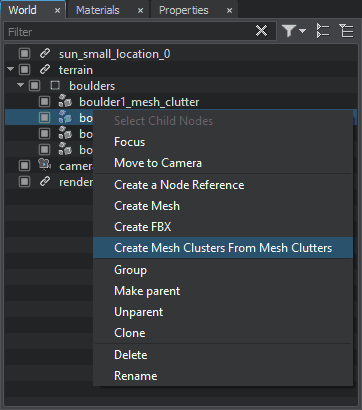

Creating Mesh Clusters from Mesh Clutters#
To create a Mesh Cluster from a Mesh Clutter, use the following context-menu option:
Using this option disables the Mesh Clutter and creates and enables a mesh cluster with the same name and postfix _Cluster added.

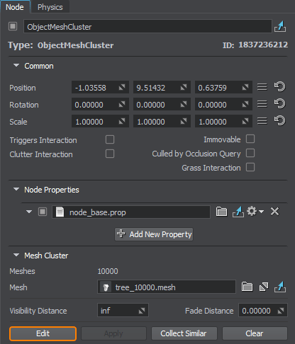

To edit a mesh cluster (either created or collected), for example, to reposition or remove some meshes, click Edit in the Mesh Cluster section of the Node tab.
Meshes that were collected would become mesh cluster children.

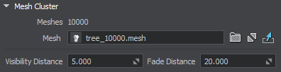

Mesh Change the source cluster mesh thus changing all children meshes.
Visibility Distance The distance up to which all cluster meshes are visible.
  • If set to infinity (inf), the Fade parameter will be ignored.
  • The real range of cluster visibility directly depends on the object (surface) maximum visibility distance and also on its fade out distance. In case meshes disappear at a closer distance, further increase of the visibility distance won't affect the performance in any way.
To avoid flickering of cluster meshes, the object maximum visibility distance should be greater than the sum of minimum visibility distance and minimum fade out distance:
Max Visibility > Min Visibility + Min Fade
Fade Distance The distance up to which the number of rendered cluster meshes gradually decreases, as they disappear randomly one by one. The fade distance follows the visibility distance. Without the fade distance set meshes disappear sharply, as a clearly seen line. Using fade distance allows the objects to disappear one by one until up to the fade distance only a few left. It makes the disappearing smooth and much less noticeable.
