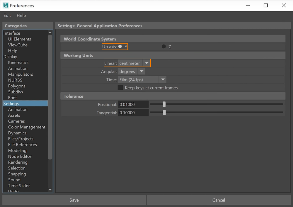

Check that World Coordinate System and Working Units are set as follows:

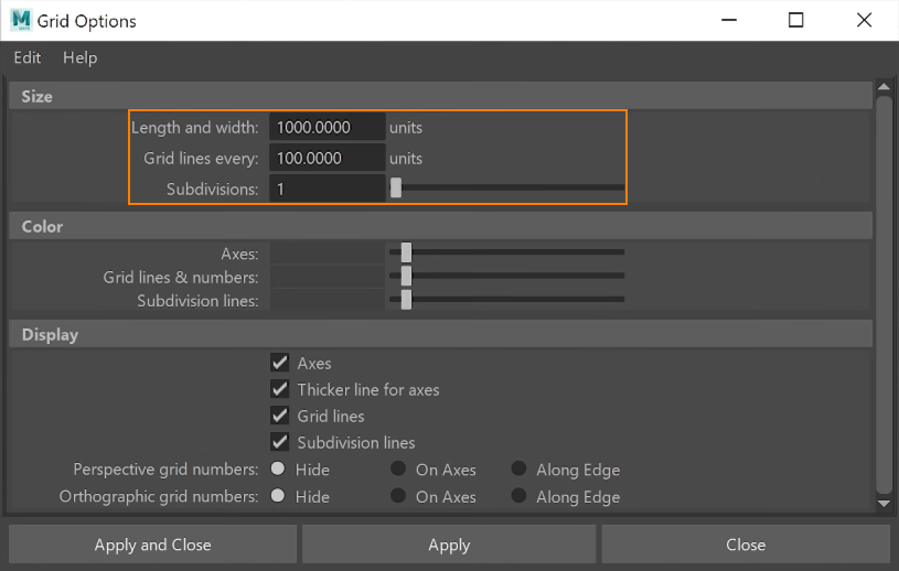

For convenience, you can set the grid cell size equal to 1 meter. Click Display -> Grid and set the following:

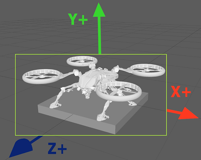

Orient the model towards the positive direction of the Z axis, which is the front direction in Autodesk Maya.

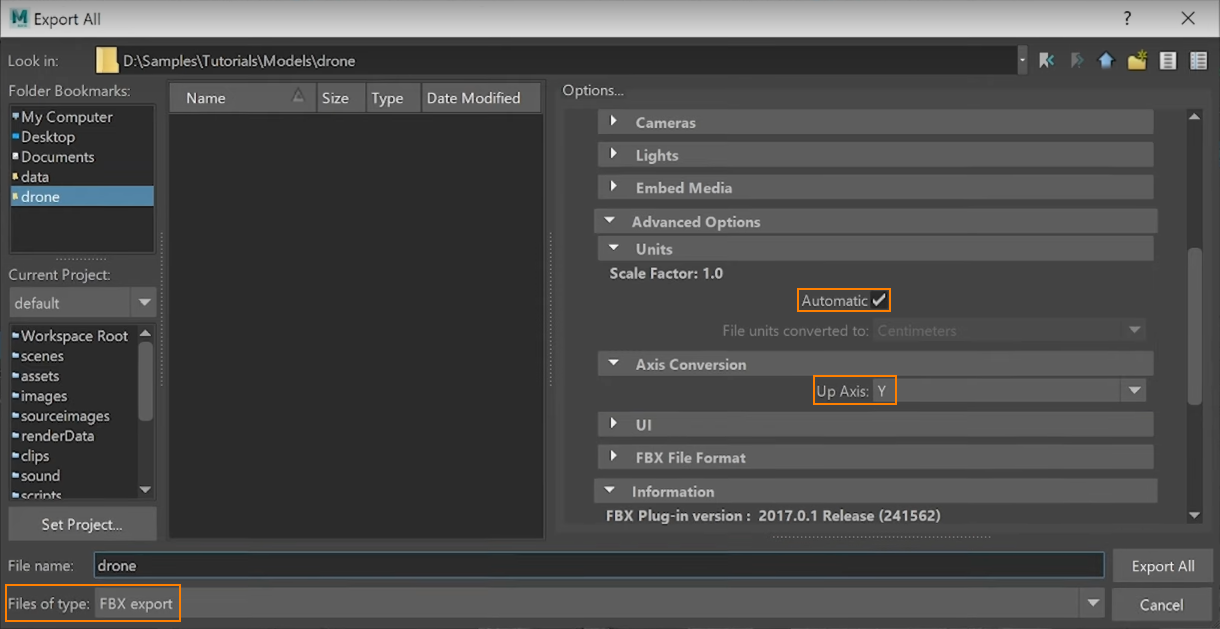

As soon as your model is ready for export, click File -> Export All....
Export settings should be the following:
- Files of type: FBX export
- Units: Automatic
- Up Axis: Y
