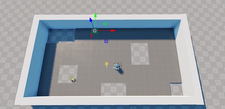

  1. To create Color Zones select some floor tiles in a group (holding the Shift hotkey), right-click and choose Unpack To Node Content.
  2. Then disable Collisions for these nodes but make sure that Intersection is enabled, so that the character's turning works correctly.
  3. To make them invisible, go to Viewport Mask and click Clear All. This way all bits of mask are set to 0 and they will not match the Camera's Viewport Mask.
  4. Disable Collision option for the ground node. Now, physical objects can fall through the holes and the ground.

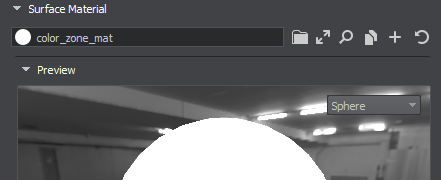

  5. Create a color_zone_mat material inherited from mesh_base and assign it to the plane surface.
  6. In the States tab, check the Emission option.

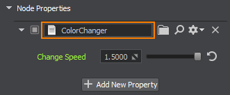

  3. Build and run the solution to generate a property file for the component.
  4. Switch back to the UnigineEditor and attach the ColorChanger property to the color zone visualization (color_zone).

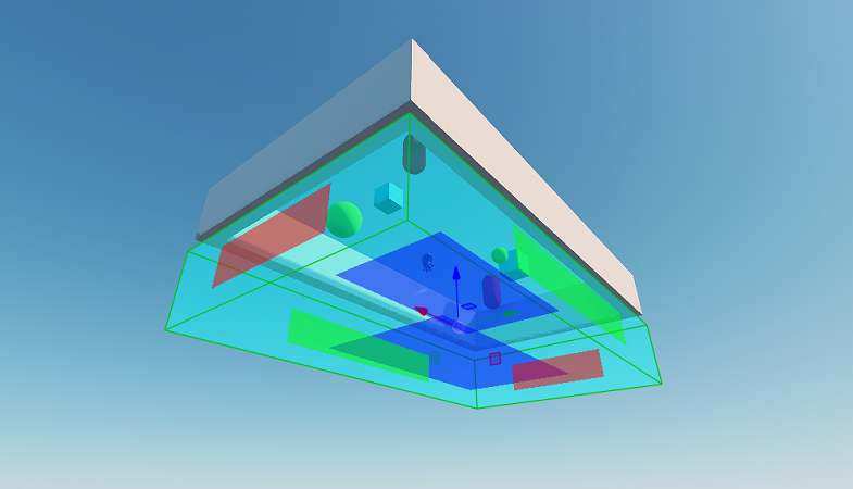

Step 4. Add a World Trigger#
To get rid of objects that were thrown in the Color Zone, let's use a World Trigger. The trigger defines an area into which a physical object will fall and a callback that fires when an object gets inside.
  1. Create a new World Trigger by choosing Create->Logic->World Tigger and place it in the world.

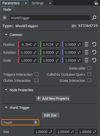

  2. Check the Touch option in the Parameters window of the World Trigger node to make the trigger fire callbacks on partial contact with another node.
  3. Position it beneath the ground and adjust its size so it covers the whole play area by going to Parameters and clicking Edit Size. Adjust the size of the World Trigger in the Viewport.

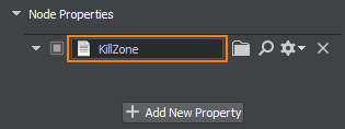

  5. Build and run the solution to generate a property file for the component.
  6. Switch back to UnigineEditor and add the KillZone component to the previously created World Trigger.

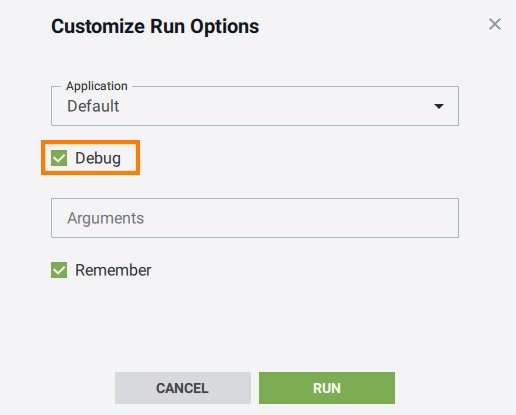

  8. To run the project via the SDK Browser, click on the ellipsis beneath the Run button to open the Customize Run Options window. By default your IDE builds a Debug version of your applications, while the SDK Browser is configured to launch the Release one. So, before clicking Run you should check the Debug option to run the proper executable to check out your progress while developing your application.
