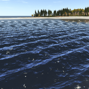

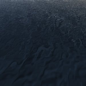

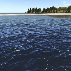

  • Scale of mesh UV coordinates affects appearance of water waves simulated by using normal maps. For example, if you apply the same normal map to 2 meshes with UV coordinates at the scale of 1:1 and 2:1 correspondingly, waves on the second mesh will be narrower than on the first mesh because of normal map tiling.
    UV coordinates at scale of 1:1
    UV coordinates at scale of 2:1

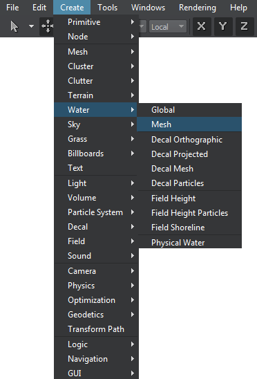

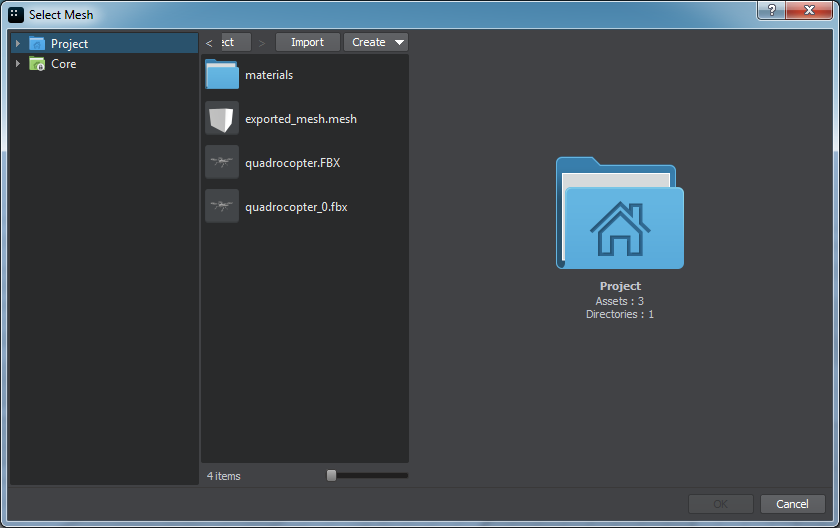

To add a water object of a finite size to the scene via UnigineEditor:
  1. On the Menu bar, click Create -> Water -> Mesh:
  2. Choose a mesh to be used and place the water mesh object in the scene:

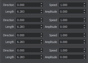

By default, water surface ripples according to the normal map (see the water_mesh_base material). However, different kinds of waves can be also simulated with 4 directional geometrical waves, summed to create dynamic waves. This model uses static geometry animated in vertex shader. Movement each of the wave is set independently that enhances flexibility of adjustment.
The waves have the following characteristics defining their periodic and sinusoidal nature:
Direction A directional wave (unlike the circular one from the objects, for example) travels along the specified direction:
  • By the minimum value of 0, the wave spreads along the Y axis and is parallel to the X axis.
  • Positive values rotate the wave about the Z axis, meaning the wave direction is slanted counterclockwise relative to its initial spread.
  • Negative values rotate the wave on the water surface clockwise.
  • By the maximum possible values of 180 or -180, the wave direction becomes parallel to the X axis yet again.

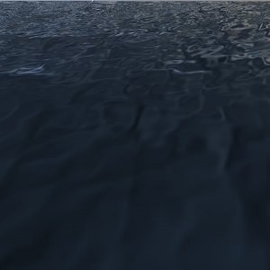

Length The length represents distance between successive crests of the wave:
  • The smaller the value, the more rippled the water surface is.
  • The higher the value, the broader formed waves are.
Length of the First Wave = 10
Length of the First Wave = 70
Amplitude Amplitude determines the distance between the highest and the lowest wave peaks. Together with Length, it sets the wave form.
  • The minimum value of 0 means the wave is not formed.
  • Increasing the value forms higher waves up to tsunami-like ones.
Amplitude of the First Wave = 0.3; Length = 10
Amplitude of the First Wave = 0.7; Length = 10
