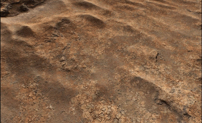

The Detail Max Height parameter enables you to set the maximum height for detail displacement. By default, it equals to 1 — the maximum possible value. In case of artifacts of stepped geometry caused by insufficient bit depth, you can adjust this parameter to a lower value, set it to the highest height value used in details. Make note that geometry will be clamped to this maximum height if details use higher values, however, normals will be affected appropriately.

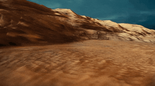

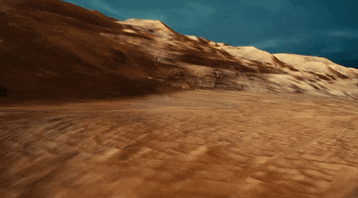

During rasterization the renderer selects the mip-level of textures according to the distance to the camera, as well as to the angle of the surface to the camera, i.e. the screen size of the polygon: distant polygons and polygons that are not faced right to the camera are rendered at a lower quality. The Texture Filtering mode controls the way of treating such situations, it has the following presets:
  • Low — use the lower mip-level. This option has the best performance but low quality: there is a noticeable edge of mip-levels change.
  • Medium — use the higher mip-level. Though the quality is better, the edge still remains. This option has a moderate effect on the performance.
  • High — linearly interpolate adjacent mip-levels. This option uses appropriate mip-levels and interpolates pixels, so the edge between mip-levels disappears. This is the most performance-consuming mode.
Comparison of filtering modes: Low, Medium, High. Settings were degraded for obviousness.
The Low and Medium modes may provide slight flickering due to low filtering quality. Use TAA to get rid of perceptible artifacts. If your project requires TAA to be disabled, try decreasing overall detail quality.

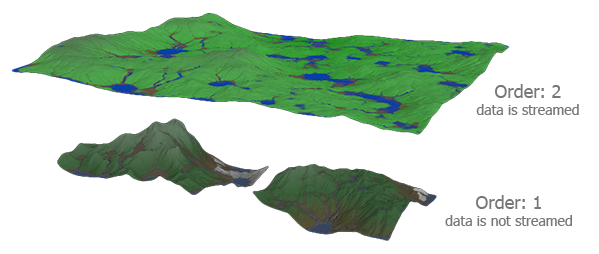

Only visible Landscape Layers are taken into account when streaming graphic data. Thus, a Landscape Layer Map with a higher Order value would overlap other ones and take part in data streaming, provided there is no blending between layers.
A schematic representation of several Landscape Layer Maps overlapping each other.
The one with the higher Order value will overlap the other ones and its data will be loaded.
Streaming is based on using previously loaded geometry to define the visible areas of terrain. The Culling flag of Landscape Layer Map enables uploading preliminary low-level data of the map to CPU (about 2 meters per pixel) to be used for checking what tiles are to be streamed next. For maps with the Culling option disabled, only high-detail data of the base map is uploaded on CPU, provided there is data loaded in the visible area.
Best Practice
Disable the Culling flag for Landscape Layer Maps that contain high-detail graphic data (having an insignificant difference in height from the base low-detail layer, e.g. centimeters, like vehicle tire tracks) and are used as insets (placed within the bounds of another layer map to provide a higher level of detail) to exclude them from loading preliminary low-level data and reduce load on CPU.
For Landscape Layer Maps that form basic shape of the landscape keep the Culling flag enabled, otherwise no graphic data will be loaded.

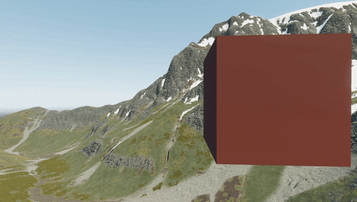

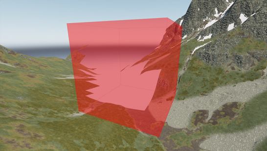

The polygons of Landscape Terrain are subject to frustum culling optimization. If a polygon falls out of the camera frustum (i.e. its screen position is outside the viewport bounds), it is culled out for rendering. You can enable the Aggressive Frustum Culling mode that implies more strict requirements for polygons to be rendered thereby increasing performance. In case of any issues with polygons rendering, try disabling this option (however, note that performance may drop).
Increase the Culling Oblique Frustum multiplier to cull out more polygons beyond the oblique frustum plane.

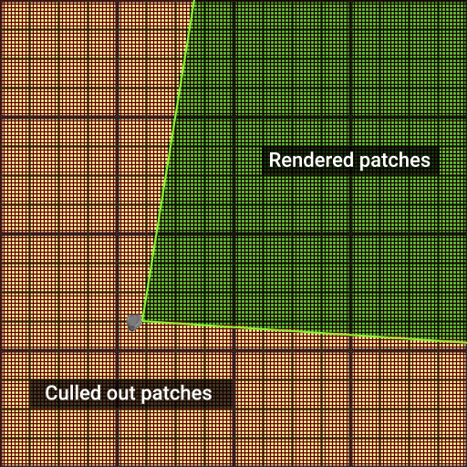

Internally, Landscape Terrain has 3 main stages of grid formation and culling, here is their schematic representation (top view), geometry levels of detail (Geometry Progression) are omitted for simplicity:
1. CPU Culling Patches
2. GPU Culling Patches
3. Tessellation Quads
You can use the Advanced settings for fine-tuning of internal operation of this system.
The default values are best suitable for the default camera FoV of 60 degrees. Using much more narrow fields may require fine tuning for the best performance.
  1. CPU Culling Patches — initial patches (tiles) tested for occlusion and visibility on the CPU side. Among other culling techniques, these patches support occlusion culling by Occluders.
    Occluders support.
    The CPU patches are to be subdivided and passed to the next stage — GPU Patches. The Culling Patch Resolution CPU value defines the number of subdivisions for CPU patches:
    • The lowest value of 2 corresponds to no subdivisions at all, i.e. all patches will be culled on the CPU side. Stick with lower values if you intend to use Occluders for polygon reduction.
    • Higher values reduce the load on CPU as more patches will be checked for visibility on the GPU side.
    Another important parameter is Culling Patch Batching defining the size of batches for culling patches. Batched culling of patches enables skipping large areas at once making it possible to operate on patches of smaller size for better culling quality and performance.
  2. GPU Culling Patches — Landscape Terrain patches, visibility of which is tested on the GPU side.
    The GPU patches are to be subdivided one more time before tessellation. The Culling Patch Resolution GPU value defines the number of subdivisions for GPU patches:
    • By lowering this value you reduce the load on CPU, more loading GPU due to less efficient culling of patches of larger size.
    • By increasing it you move more computations to CPU (more rendered primitives), reducing the load on GPU (less polygons).
    The point is to use these parameters to find a trade-off between loads on processing units in the given conditions on the target hardware. Use the Rendering Profiler to track the number of rendered primitives and triangles and achieve the best CPU and GPU timings:
  3. Tessellation Quads — this is where Adaptive Hardware Tessellation comes into play, subdividing polygons to the target density. The last Frustum Culling optimization is applied to polygons.
All patches are constructed for all geometry LODs. Since it is impossible to match edges of culled patches of adjacent LODs, it is needed to introduce overlapping edges. In case of geometry gaps, use the following settings to increase the distance of overlap between LODs:
Additional culling is applied to Landscape Layer Maps having small apparent size on the screen due to large distance to them or a high camera's FoV. In case small Landscape Layer Maps disappear too soon with the distance, try increasing the Culling Map value.
