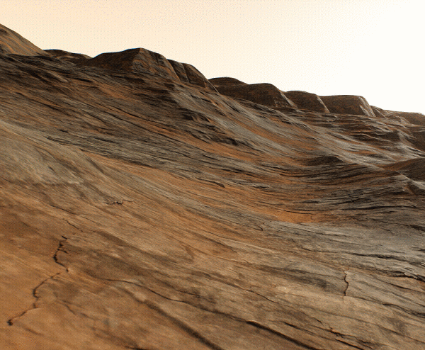

Configuring Landscape Terrain Details
Details are intended for refinement of Landscape Terrain graphic data by means of tiled textures in order to achieve extreme density and realistic visual representation in close up views.
If your project requires detection of collisions with the terrain surface, you should keep in mind that Details don't participate in Intersection and Collision Detection, so it's not recommended to apply intense displacement using details since visual inconsistency may appear.
Details#
ObjectLandscapeTerrain stores visual settings for 20 detail masks intended for reaching better level of visual quality in close up views. Details represent arbitrary albedo, roughness and height (displacement) data, so you can drastically improve the look of the Landscape Terrain. Details are applied according to masks of Landscape Layer Map objects.
Detail settings available in ObjectLandscapeTerrain parameters allow defining the detail visual appearance, adding up to 1024 details to a mask and defining the material of each detail.
Detail parameters are available on the Node tab of the ObjectLandscapeTerrain parameters.

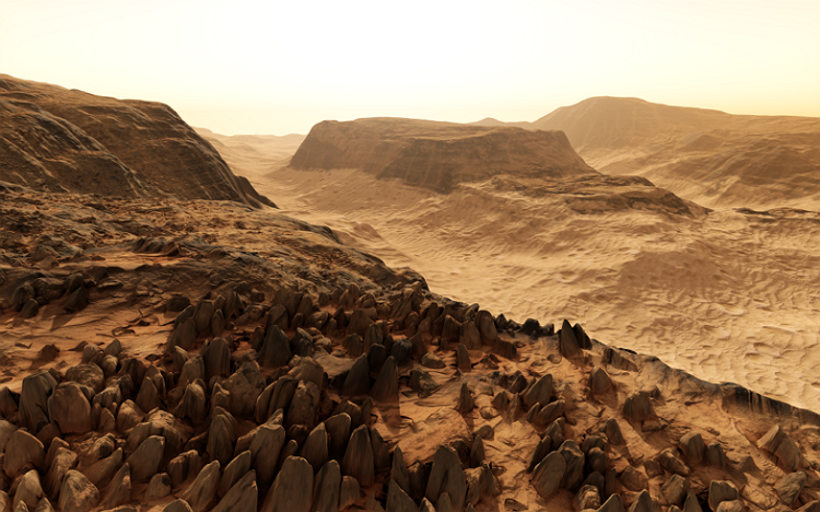

By combining multiple details under a single mask you can diversify the look of the surface a lot.
The result of combining three details under a single mask.

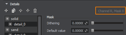

The list of detail masks displays the hierarchy of details for each of 20 detail masks. Using the buttons at the top you can control details and rearrange masks or details depending on what is selected:
  • create details for the selected masks.
  • clone the selected details.
  • move up the selected masks/details.
  • move down the selected masks/details.
  • delete the selected details.
Drag details using the mouse to set up the hierarchy, Double-click on a detail or a detail mask to rename it.

Internally each Landscape Layer Map stores its 20 masks in 5 RGBA8 mask textures. The following parameters display the info on the corresponding mask texture and can be used to access the mask via API:
Mask Texture The index of the mask texture used.
Channel The channel of the mask texture used.
