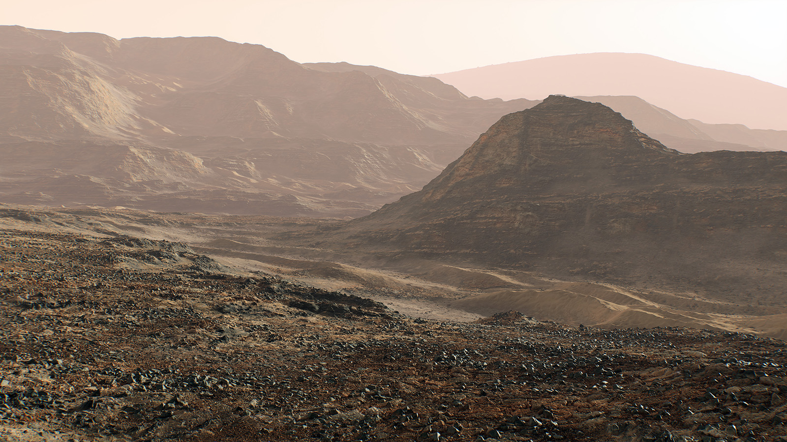

  • You can enhance the visual quality of your terrain by using details instead of just colored photos from satellites (imagery). Details can represent different materials and surfaces of your terrain. e.g. sand, grass, rocks. You can define areas where details should appear by using special masks. Masks can be generated in Houdini as well. As it's just an additional input information for the Sandworm Tool you can create pretty interesting masks for details and achieve very realistic results. In addition to storing color information, details also use normal maps and shading maps. In the end they will allow you to create several levels of detailing and you'll be able to see detailed visual information both in closeups and when looking at large distances from the surface of your terrain.

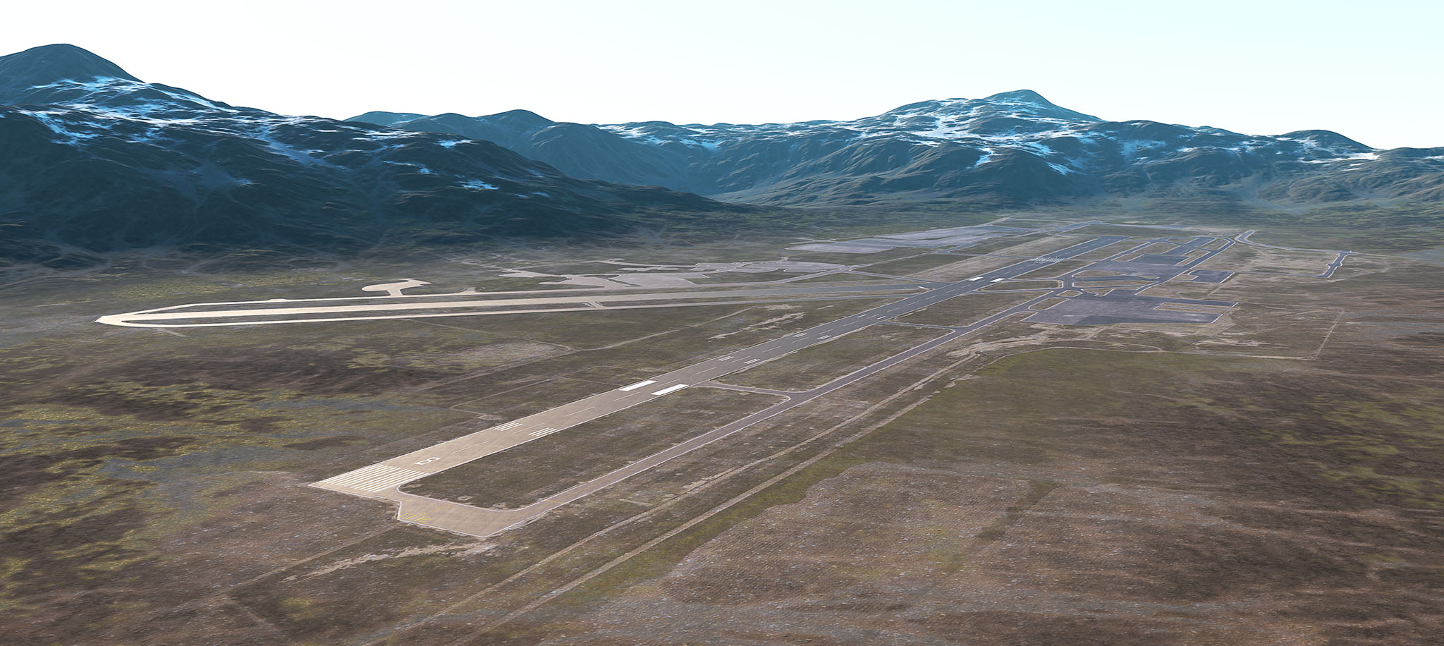

  • You can flatten the a terrain area where the airport is located via a Houdini asset. Simple asset will use a custom mask to flatten areas during landscape generation.
  • Runway itself should be created using Mesh Decals or separate geometry. Use the same way to create lines and markings on the runways.
    For more detailed and visualized explanation of using Mesh Decals see a part of our video tutorial on Decals.
