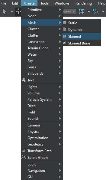

To add a skinned mesh to the scene via UnigineEditor, do the following:
  1. Run UnigineEditor.
  2. On the Menu bar, click Create -> Mesh -> Skinned.
  3. In the dialog window that opens, choose the path to the .mesh file.
  4. Place the mesh somewhere in the world.
You can change the path to the mesh at any time in the MeshSkinned tab.

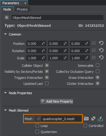

Loading a Skinned Mesh and Animation#
To replace a loaded skinned mesh with a new one, do the following:
  1. Choose the mesh in the World Hierarchy window and go to the Node tab of the Parameters window.
  2. In the Mesh Skinned section, choose the path to the new .mesh file in the Mesh field.

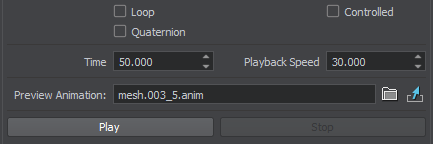

Setting Up Animation#
You can perform the following operations with the skinned mesh animation via UnigineEditor:
Mesh Skinned tab
Loop Play an animation in a loop.
Quaternion Toggles the dual-quaternion skinning mode on and off. The dual-quaternion model is an accurate, computationally efficient, robust, and flexible method of representing rigid transforms and it is used in skeletal animation.
Controlled Set the flag identifying that the mesh animation is controlled by a parent skinned mesh.
Time Set the animation time, in animation frames. The time count starts from the zero frame. If the time is set to be between frames, animation is blended. If the time is set outside the animation frame range, the animation is looped.
Playback Speed The multiplier of the animation playback time.
Preview Animation Path to a file with animation (.anim) to be played.
Play Start the animation playback.
Stop Stop the animation playback.

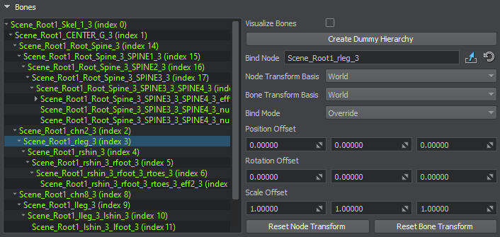

Setting Up Bones#
Bone hierarchy of your skinned mesh is displayed in the Bones section of the Parameters window.
Each bone of a skinned mesh can be bound to a separate node to control its transformation giving you a lot of flexibility. For example, you can animate these nodes via the Tracker tool or enable physics-based control over skinned mesh bones binding them to nodes driven by physics.
Mesh Skinned tab

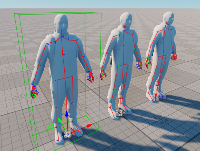

Visualize Bones Enable visualizer for bones and their basis vectors to monitor your settings while adjusting them. The visualizer is rendered even when a skinned mesh is not selected in the World Nodes hierarchy, making it possible to show positions of bones for multiple meshes simultaneously.
The global Visualizer is enabled automatically, when you check this option.
Create Dummy Hierarchy Creates a hierarchy of dummy nodes for the skinned mesh, where each node has the same name and transform as the corresponding bone and is bound to it with default settings.
The hierarchy can also be generated for selected bones only.
Bind Node Node whose transformation is used to control the transformation of the bone.
Node Transform Basis Defines which transformation of the bound node (World or Local) is to be used to override the transformation of the selected bone.
Bone Transform Basis Defines which transformation of the selected bone is to be overridden by the node's transformation:
  • World coordinates
  • Coordinates relative to the skinned mesh object
  • Coordinates of the parent bone
Bind Mode Defines the type of blending of node's and bone's transformations:
  • Override — replace bone's transformation with the transformation of the node.
  • Additive — node's transformation is added to the current transformation of the bone.
Position Offset Translation part of the additional transformation matrix applied to the node's transformation before applying it to bone's transformation. This parameter serves for the purpose of additional correction of the node's transform for the bone's basis.
Rotation Offset Rotation part of the additional transformation matrix applied to the node's transformation before applying it to bone's transformation. This parameter serves for the purpose of additional correction of the node's transform for the bone's basis.
Scale Offset Scaling part of the additional transformation matrix applied to the node's transformation before applying it to bone's transformation. This parameter serves for the purpose of additional correction of the node's transform for the bone's basis.
Reset Node Transform Resets initial node transformation.
Reset Bone Transform Reset bone transformation. This button is used to restore initial transformation of the bone after modifying it via a bound node.

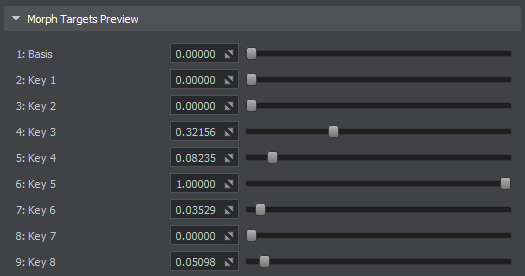

Controlling Morph Targets#
For meshes containing morph targets, the Morph Targets Preview list is available in the Parameters window. This set of parameters in the Editor allows visualizing what the model looks like with one or more morph targets applied. Actual application of morph targets and their weights is done via code.
Each target has a slider that allows configuring its weight — the extent of the morph target's effect on the resulting view of the model.
Basis represents the original position of all vertices of the mesh, and its slider is shown for reference.
