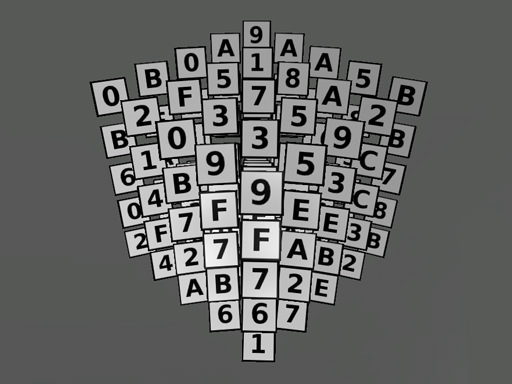

The Billboards object consists of a number of billboard elements. A billboard is a rectangular flat object that always faces the camera. The Billboards is used instead of fully functional objects that are barely seen from far off and slightly change their position when the camera moves around them (e.g. clouds, stars, far away forests). Using Billboards helps to simplify and speed up rendering.
For example, when you are adding a tree that is hardly seen from a distance, instead of creating a complex tree mesh, just put an appropriate texture onto the alpha-tested Billboards and it will make no visual difference at such a range.

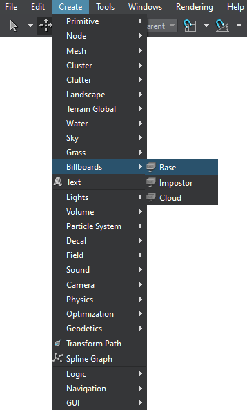

In the Create menu you will see three options each creating a Billboards object used for a specific purpose and having a specific material assigned:
  • Base - used for groups of billboards (billboards_base material)
  • Impostor - used as an optimization for impostors to be rendered, for example, instead of a Cluster object at large distances (Billboards are simpler and less performance-consuming). In this case the billboards_impostor_base material is assigned, it is a base material for impostors, that supports sampling different regions of textures based on viewing angle.
  • Cloud - intended to simulate simple shaded clouds (billboards_cloud_base material)

  1. On the Menu bar, click Create -> Billboards -> Base.
  2. Place the Billboards object somewhere in the world.

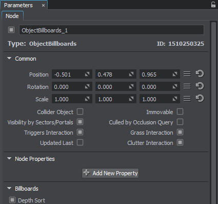

Billboards Parameters#
Depth Sort Indicates that billboards should be sorted in back-to-front order according to their position. This option should be enabled, if alpha blending is used for the billboard material (except for the additive blending).

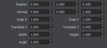

In the Billboards section of the Node tab, you can create new billboards and tweak their settings.
Add from Children Adds all billboards from identical children objects to the list in the parent billboard and removes the added children from the World Nodes hierarchy.

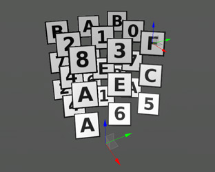

Add
Adds a new billboard. After a new billboard is created, it can be selected in the list of billboards in the Node tab and repositioned using a standard manipulator.
Repositioning a separate billboard
Remove Removes a billboard selected in the list.
Clear Removes all billboards from the list.
Position Moves the billboard along X, Y and Z axes, respectively.
Normal Sets the X, Y and Z coordinates of the billboard's normal vector. Is used to orient the billboard. Works only with the billboards_impostor_base material.
ScaleX
ScaleY
Scale values scale the texture on the selected billboard along X and Y axes, for example:
  • If ScaleX is set to 2, there will be two texture tiles widthways.
TranslateX
TranslateY
Translate values offset the texture on the selected billboard along X and Y. With these parameters, an arbitrary point of the texture can be set as the top left corner of the billboard, for example:
  • If TranslateX is set to 0.5, the texture is repositioned to the left (so that the edge of the texture is rendered in the center of the billboard).
Width Width of the rectangle for the selected billboard.
Height Height of the rectangle for the selected billboard.

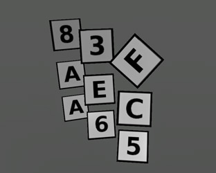

Angle
Angle to orientate the selected billboard.

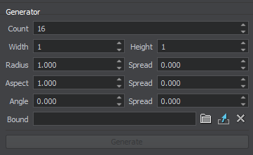

Generator#
Generator allows you to automatically create a specified number of billboards and randomly scatter them within an arbitrary mesh volume. After that, they will appear in the list in the Billboards section of the Node tab and can be repositioned, if necessary. If a texture atlas is used, each of the created billboards will be randomly assigned one of texture slots.
Count The number of billboards to create and scatter.
Width If a texture atlas is used, Width specifies the number of slots horizontally. If a simple texture is used, this value should be 1.
Height If a texture atlas is used, Height specifies the number of slots vertically. If a simple texture is used, this value should be 1.
Radius
Spread
The size of the square billboards to be created.
Spread value defines the range for possible variation of the Radius:
  • The higher the value, the more varying size the created billboards will have. (See how it is calculated in detail here.)
  • If set to 0, all billboards will be of equal size.
Aspect
Spread
The ratio of width to height. This option is used to create rectangular billboards.
  • If Aspect is set to 0.5, the width of the billboards will be twice their height.
  • If Aspect is set to 2, the height of the billboards will be twice their width.
Spread value defines the range for possible variation of the Aspect:
  • The higher the value, the more varying aspects the created billboards will have. (See how it is calculated in detail here.)
  • If set to 0, all billboards will be of equal (square) size.
Angle
Spread
Angle of orientation.
Spread value defines the range for possible variation of the Angle:
  • The higher the value, the more differently the created billboards will be oriented. (See how it is calculated in detail here.)
  • If set to 0, all billboards will stand straight.
Bound A mesh that determines the volume within which billboards will be generated. The mesh itself is not rendered.
Generate Create new billboards and scatter them within the mesh volume. If a texture atlas is used, each of the created billboards will be randomly assigned one of the texture slots.
