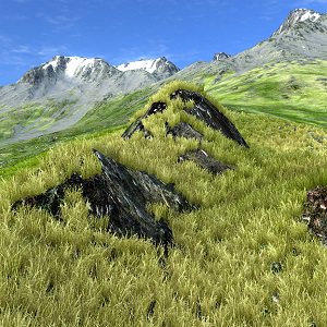

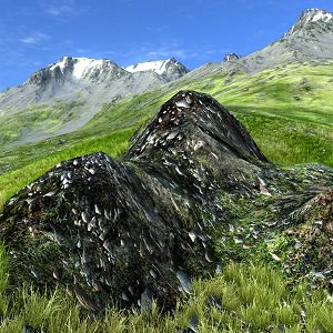

Intersection Flag indicating whether grass should follow the relief.
Orientation
Flag indicating whether grass polygons are oriented along the normal of its parent node (for example, terrain).
Grass polygons oriented along normal of Grass object
Grass polygons oriented along normal of Terrain
Read more here.
