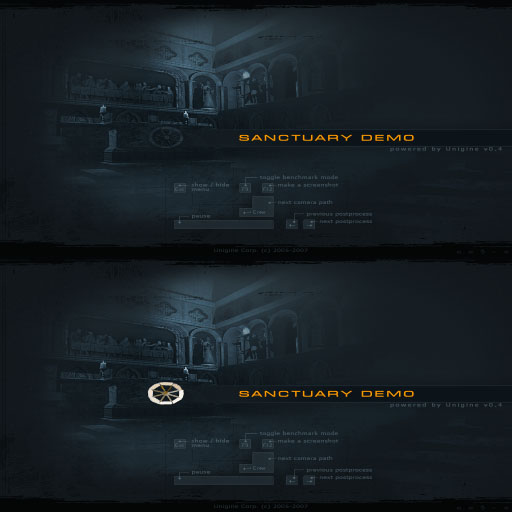

Boot and Loading Screens#
Texture splash screen
Layout#
The texture is divided into two parts: the initial state (upper) and the final state (lower).
Assembly#
While a texture of a loading screen is being displayed, the initial picture (upper) is gradually replaced with the final one (lower). Pseudo-animation can be created using the alpha channel: regions of the lower half with small alpha values will be shown first, regions with larger alpha values will be shown last.

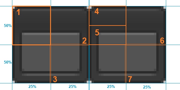

gui_border.png#
Frame borders
Layout#
Assembly#
All four corners are copied 1:1 from corresponding corners of the texture:
  1. The top-left corner
  2. The top-right corner
  3. The bottom-left corner
  4. The bottom-right corner
Vertical and horizontal strips (2 pixels in width), which are located at the center of the corresponding half of the texture are used to fill in space between corners. The strips are stretched, and the resulting color bar is constructed using interpolation between colors of the pixels in the strips.

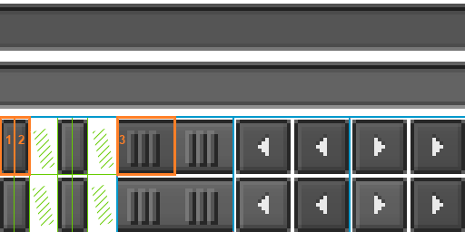

gui_hscroll.png#
Horizontal scroll bar
Layout#
The texture is divided into five zones, each of which uses the layout similar to the icon layout. Bottom-left corner has a specific layout, since it contains unused regions (highlighted with green hatching).
Assembly#
The scroll bar handle is combined from the left (1), central (3) and right (2) parts; the underlying bar is stretched to the given width.

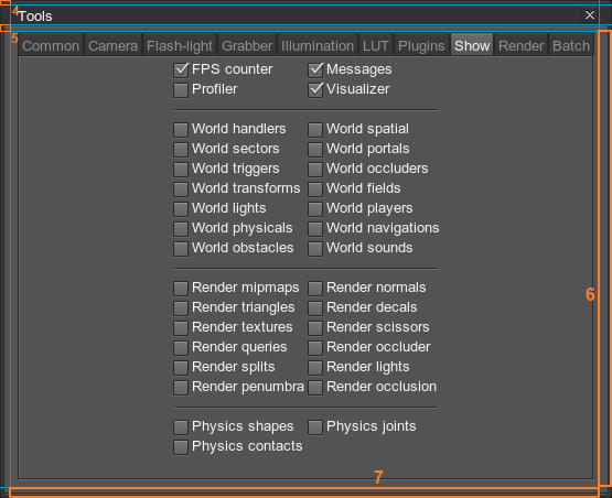

gui_window.png#
Window skin
Layout#
On the image below, the left half is for windows with caption and the right half is for windows without caption.
Assembly#
All four corners are copied 1:1 from the corresponding corners of the texture. Vertical and horizontal strips (two pixels in width), which are located at the center of the corresponding half of the texture are used to fill in space between corners. The strips are stretched, and the resulting color bar is constructed using interpolation between colors of the pixels in the strips.

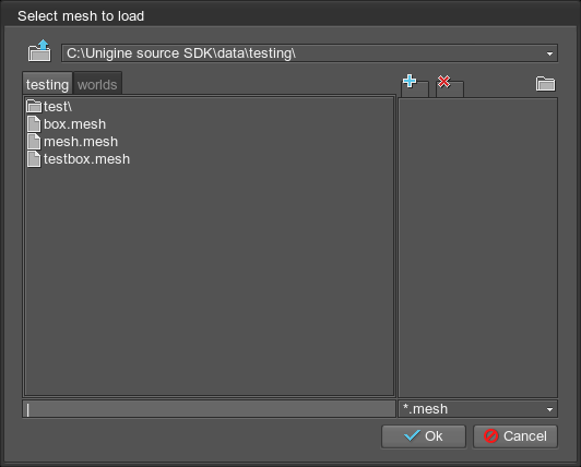

File Dialog#
File selection dialog
This dialog requires four images that use the icon layout.
  • Go to the upper directory:
  • Add a tab
  • Remove the tab
  • Mini-icons for different file objects; split vertically into squares:
