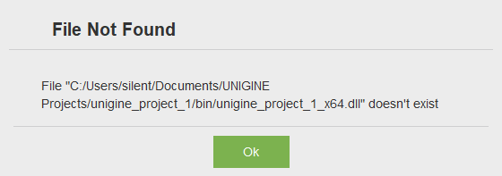

If you don't have .NET SDK installed, you can come across various errors while working with the project in both SDK Browser and UnigineEditor. For example, when running the application (clicking the RUN button) after creating it in SDK Browser, you may receive the error stating that File Not Found — File *_x64.dll doesn't exist:如果未安装.NET SDK,则在SDK Browser和UnigineEditor中使用该项目时会遇到各种错误。例如,在SDK浏览器中创建应用程序后运行该应用程序(单击RUN按钮),您可能会收到错误,指出该File Not Found — File *_x64.dll doesn't exist
File Not Found — File *_x64.dll doesn't exist File Not Found — File *_x64.dll doesn't exist

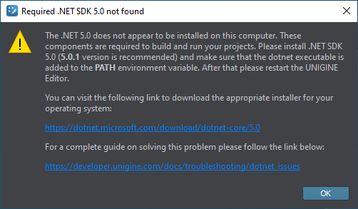

Errors also can occur when clicking the Play button in UnigineEditor (Required .NET SDK not found):单击UnigineEditor中的Play按钮时,也会发生错误(Required .NET SDK not found):
Required .NET SDK not found找不到必需的.NET SDK

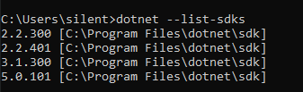

  1. Open the Command Prompt (Click the Start button and type cmd).打开命令提示符(单击Start按钮并键入 cmd )。
  2. In the window that opens, type the following:
    命令行
    dotnet --list-sdks
    在打开的窗口中,键入以下内容:
    命令行
    dotnet --list-sdks
The following information should appear:应该出现以下信息:
List of the SDKs installed on the PC PC上安装的SDK的列表

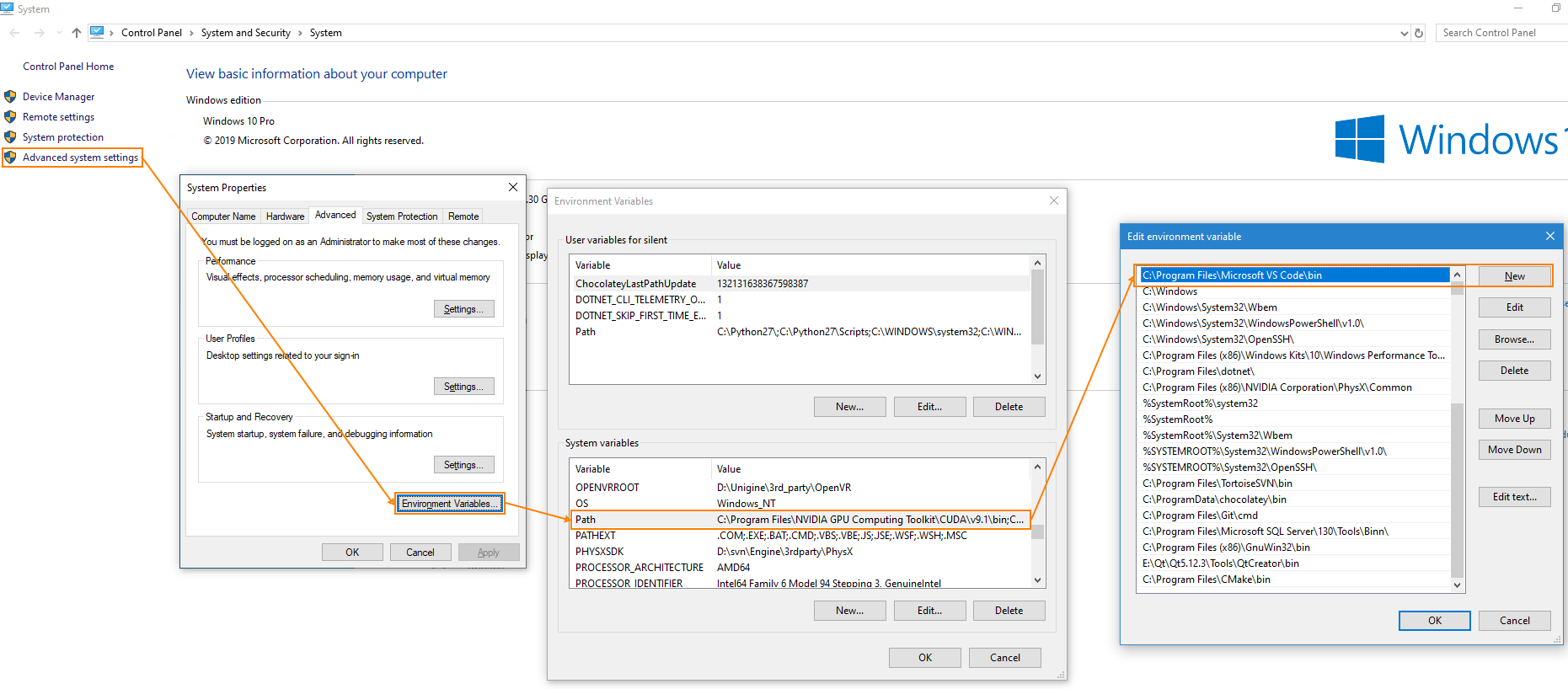

In case IntelliSense cannot be started due to the spawn cmd ENOENT error in the OmniSharp extension, it is recommended to add %WINDIR%\System32 to the PATH variable.如果由于OmniSharp扩展中的spawn cmd ENOENT错误而导致无法启动IntelliSense,建议将%WINDIR%\System32添加到PATH变量中。
Editing the PATH variable on Windows 10在Windows 10上编辑PATH变量

In case a single source file of a C# component is opened in VS Code when double-clicking it in UnigineEditor, it is recommended to make sure the path to the VS Code bin (%VSCODE_INSTALLATION_FOLDER%\bin) folder is added to the %PATH% environment variable, for example, as follows: C:\Program Files\Microsoft VS Code\bin.如果在UnigineEditor中双击VS Code中的C#组件的单个源文件时,建议确保将VS Code bin(%VSCODE_INSTALLATION_FOLDER%\bin)文件夹的路径添加到%PATH%环境变量中例如,如下:C:\Program Files\Microsoft VS Code\bin
