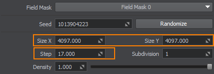

Setting Up Step for Cell Division设置细胞分裂步骤#
For optimization purposes, the grass field is split into cells forming a grid. These cells are rendered one by one, from the camera to the horizon. Each cell requires 1 DIP call, so the higher number of cells, the lower the performance. The number of cells is determined by two parameters - the Size of the grass field and the Step by which the grass field is split into cells. 出于优化目的,将草场拆分为形成网格的单元。从摄影机到地平线,这些单元一一渲染。每个单元需要1个DIP呼叫,因此单元数越多,性能越低。单元格的数量由两个参数确定-草地的Size和将草地分为多个单元格的Step。
There are two requirements for these parameters that should be met:这些参数应满足两个要求:
- The size of the field should be divided by the step exactly, with no remainder by division.字段的大小应精确地除以步骤,没有除法的余数。
- The step value should stay within the recommended optimal range of [10;25], as the small enough cells are rendered fast and smoothly while the large cells may take more time for rendering.步长值应保持在[10;25]的推荐的最佳范围之内,因为足够小的单元格可以快速而流畅地渲染,而大的单元格可能需要花费更多时间进行渲染。
For example, if the size of the grass field is 4097 x 4097, the recommended Step value is 17. It is in the range and the field size is divided by this value exactly.例如,如果草场的大小为 4097 x 4097 ,则建议的“步长”值为 17 。它在范围内,字段大小精确地除以该值。

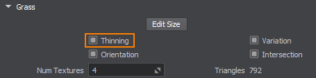

Thinning Grass间草#
