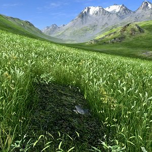

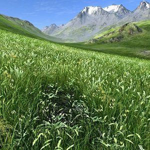

  • A Field Spacer can be used to specify area under a building and around it where grass should not grow. Moreover, by using the attenuation factor, it is possible to create thinner grass around the building.

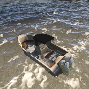

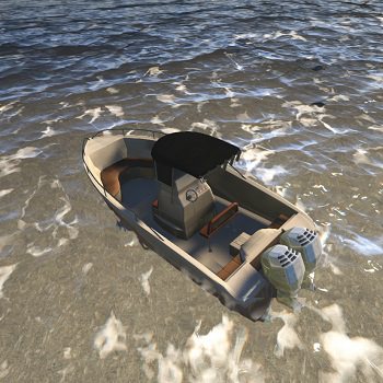

  • A Field Spacer can be set for a boat so that water is not rendered inside it.

Boat without the Field Spacer: water is inside the boat
Boat with the Field Spacer: the Field Spacer cuts water off

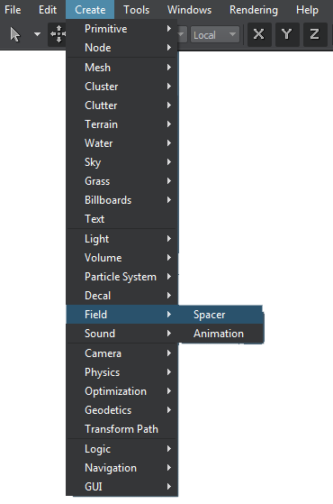

To add a Field Spacer in the world via UnigineEditor, do the following:
  1. On the Menu bar, choose Create -> Field -> Spacer.

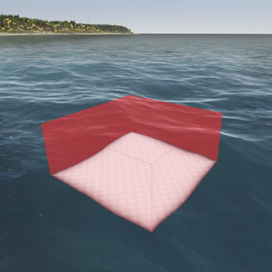

  2. Place the spacer field in the world so that it intersects geometry required to be cut off:
    Make sure that the Spacer interaction flag is set for materials applied to grass or water.
    • In case of grass, the Field Spacer should intersect the surface, on which grass grows.
    • In case of water, the Field Spacer should intersect the water surface:

Attenuation An attenuation factor indicating how much geometry is cut off gradually starting from the center of the Field Spacer.
  • By the minimum value of 0, all geometry inside the Field Spacer will be rendered.
  • The higher the value, the less geometry will be rendered inside the Field Spacer.
Atten = 5
Atten = 15
