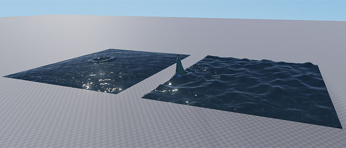

The Water body is modeled as a two-dimensional grid with point particles positioned in the vertices of the mesh. The particle movement is restricted to two directions: it can be lifted upwards or dragged downwards. In the case of changing its position, the particle acquires a velocity that affects the neighboring particles and thus describes the grid of Water body at each physics time step. Thus, the waves are generated when physical bodies get in contact with water or a particle is directly assigned new velocity.Water物体被建模为二维网格,点粒子位于网格的顶点。粒子运动被限制在两个方向:它可以向上提升或向下拖动。在改变其位置的情况下,粒子获得影响相邻粒子的速度,从而描述每个物理场的Water物体网格时间步长.因此,当物理物体与水接触或直接为粒子分配新速度时,就会产生波。
Water grid changes during physics simulation物理模拟过程中的水网变化

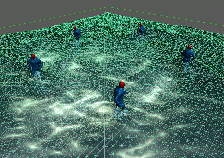

Two-way dynamic interaction provides both physically and visually convincing simulation of the waves from the physical bodies as they disturb the fluid. Imagine a moving boat that forms a wake wave behind it, or a character creating ripples while moving in the water (see the picture above).双向动态交互提供了物理和视觉上令人信服的模拟,当它们干扰流体时来自物理体的波。想象一艘移动的船在它后面形成尾波,或者一个角色在水中移动时产生涟漪(见图以上)。

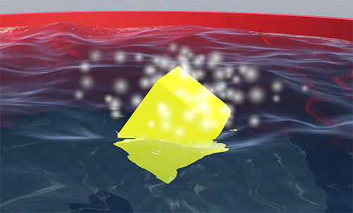

It is possible to create an additional visual effect of small droplets, splashes or bubbles on the water when objects fall into it. To enable this effect perform the following steps:当物体落入水中时,可以在水面上产生小水滴、飞溅或气泡的额外视觉效果。要启用此效果,请执行以下步骤:
  1. Create a Particle system effect by clicking Create -> Effect -> Particle system in the main menu of UnigineEditor.通过单击主菜单中的 Create -> Effect -> Particle system 创建 Particle system 效果统一编辑器.
  2. Go to the Parameters window.转到 Parameters 窗口。
  3. In the Dynamic section, choose the Spark Emitter to spawn particles by selecting Emitter -> Spark.Dynamic 部分,选择火花发射器通过选择 Emitter -> Spark 来生成粒子。
  4. Make Particle system a child of the Water Mesh object.使 Particle system 成为孩子Water Mesh 对象。
Particles will be generated only when the object first contacts the water surface, while already submerged bodies will float without generating them.只有当物体第一次接触水面时才会生成粒子,而已经淹没的物体将漂浮而不生成它们。
Effect of water splashes水溅效果
