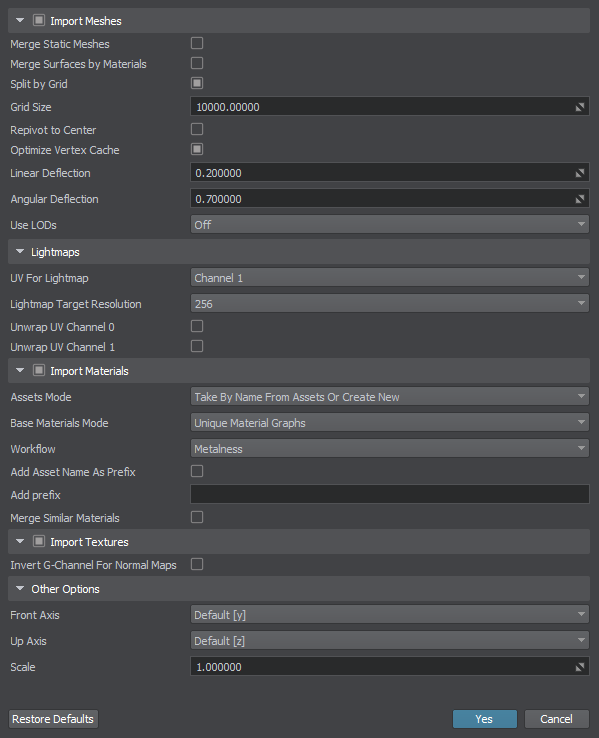

When you import a CAD asset, the import settings window appears:导入CAD资源时,将显示导入设置窗口:
To simplify sequential import of multiple similar assets, Asset Browser remembers previous asset import settings and offers to use them by default. To reset import settings to system defaults use the Restore Defaults button.为了简化多个相似资源的顺序导入,Asset Browser会记住以前的资源导入设置,并默认提供使用它们的功能。要将导入设置重置为系统默认值,请使用Restore Defaults按钮。
The list of available import options includes the following:可用的导入选项列表包括以下内容:
Mesh Import Options
网格导入选项#
Import Meshes Import geometry meshes from the file.从文件导入几何体网格。
Merge Static Meshes Merges all children static meshes in one (names it after the parent mesh). All of the meshes surfaces will be copied and shown in the Surfaces hierarchy.将所有子静态网格物体合并为一个(以父网格物体命名)。所有的网格表面将被复制并显示在Surfaces层次结构中。
Merge Surfaces by Materials Enables merging surfaces that have the same materials.启用具有相同材质的合并曲面。
Split by Grid
Enables splitting of imported meshes. Too large models having sizes, that exceed 10000 units may have various artefacts (jitter, etc.) associated with positioning errors. You can eliminate such artefacts by splitting your mesh into multiple separate meshes. To do so, just enable this option and set the size of the grid cell (see the Grid Size parameter below) to be used for mesh splitting.启用导入网格的拆分。尺寸超过10000个单位的太大模型可能会出现与定位错误相关的各种伪像(抖动等)。您可以通过将网格划分为多个单独的网格来消除此类伪影。为此,只需启用此选项并设置用于网格划分的网格单元的大小(请参见下面的Grid Size参数)。
This option does not split surfaces.此选项不会拆分曲面。
Grid Size Size of the grid cell to split imported meshes, in units.划分导入的网格的网格单元的大小,以单位为单位。
Repivot to Center Places a pivot of generated mesh to its center. Can be used for meshes having their geometry located too far from their pivot, as this may lead to various artefacts (jitter, etc.) associated with positioning errors.将生成的网格的枢轴放置到其中心。可以用于其几何形状离其轴心太远的网格,因为这可能导致与定位误差相关的各种伪像(抖动等)。
Optimize Vertex Cache Enables vertex cache optimization. This option reorders an indexed triangle list to improve vertex cache utilization at runtime. It can be turned off to accelerate saving process; however, it should always be turned on if saving the final version.启用顶点缓存优化。此选项对索引的三角形列表重新排序,以提高运行时的顶点缓存利用率。可以将其关闭以加快保存过程;但是,如果保存最终版本,则应始终将其打开。
Linear Deflection Limits the distance between triangles and the original surface. It is used to define triangulation of the imported model together with the Angular Deflection.限制三角形与原始曲面之间的距离。它用于与Angular Deflection一起定义导入模型的三角剖分。
Angular Deflection Limits the angle between adjacent triangles generated from a surface. It is used to define triangulation of the imported model together with the Linear Deflection.限制从曲面生成的相邻三角形之间的角度。它用于与Linear Deflection一起定义导入模型的三角剖分。

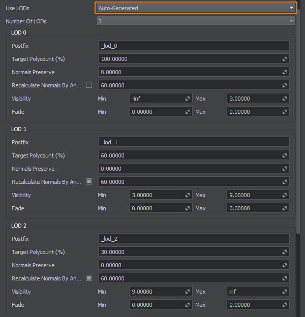

Use LODs Defines if Levels of Detail (LODs) are to be used for the imported model.定义是否将自动创建详细级别(LOD)用于导入的模型。
Levels of Detail
详细程度#
Automatic LOD Generation feature based on the meshoptimizer library will help create several variations of one object with different level of detail (LODs).基于meshoptimizer的自动LOD生成功能将帮助创建一个对象的多个不同细节层次(LOD)变体。
To use the feature choose Auto-Generated in the Use LODs dropdown and configure the settings listed below - the Engine will do the rest, generating all LODs automatically based on your configuration.要使用该功能,请在 Use LODs 下拉列表中选择 Auto-Generated 并配置下面列出的设置 - 引擎将完成剩下的工作,并根据您的配置自动生成所有 LOD。
See the video tutorial on how to configure LODs for more details.详情请参见如何配置 LOD视频。
You can also enable the Merge Static Meshes option for more optimization.您还可以启用Merge Static Meshes选项以进行更多优化。
Number of LODs Number of Levels of Detail.详细级别数。
Target Polycount
Desired degree of geometry simplification for each LOD (target geometry complexity percentage from the initial number of polygons).每个LOD所需的几何简化程度(目标几何复杂度与初始多边形数量的百分比)。
Please keep in mind that this is only a target value, that in some cases may be unreachable for the mesh simplifier. In case any artefacts with the topology of the simplified meshes occur, try increasing this value.请记住,这只是一个目标值,在某些情况下,网格简化器可能无法达到。如果出现任何具有简化网格拓扑的伪影,请尝试增加此值。
Normals Preserve This parameter indicates the impact of normals on mesh topology simplification. Higher values increase the influence of normals, by the value of 0 normals are ignored. Avoid setting too high values as this may restrict simplifier too much and simplification will fail (as normals may differ significantly). Default setting is suitable for most cases.该参数表示法线对网格拓扑简化的影响。较高的值会增加法线的影响,0 的值会忽略法线。避免设置太高的值,因为这可能会过多地限制简化器并且简化将失败(因为法线可能会有很大差异)。默认设置适用于大多数情况。
Recalculate Normals by Angle Enables recalculation of normals in the process of mesh simplification based on the specified angle threshold. If an angle between the normals to adjacent polygons exceeds this value, normals will be recalculated between them to smoothen the look of the geometry and get rid of possible shading issues.启用基于指定角度阈值的网格简化过程中的法线重新计算。如果相邻多边形的法线之间的角度超过此值,则将在它们之间重新计算法线以平滑几何体的外观并消除可能的阴影问题。
Min Visibility
The minimum distance on which this LOD is visible in camera local axes.在摄像机局部轴上可见此LOD的最小距离。
-inf — the LOD is visible by default.-inf:默认情况下,LOD可见。
Max Visibility
The maximum distance on which this LOD is visible in camera local axes.此LOD在相机局部轴中可见的最大距离。
inf — the LOD is visible by default.inf:默认情况下,LOD可见。
Min Fade
Over this distance, the surface fades in until it is completely visible. Along this distance the engine automatically interpolates the level of detail from completely invisible to completely opaque. Fading-in starts when the camera has reached the minimum distance of surface visibility and is in the full visibility range.在这个距离上,表面逐渐消失,直到完全可见。沿着这个距离,引擎会自动将细节级别从完全不可见插入到完全不透明。当相机达到表面能见度的最小距离并且处于完整的能见度范围内时,淡入开始。
Max Fade
Over this distance, the surface fades out until it is completely invisible. Fading out starts when the camera has reached the maximum distance of surface visibility and is out of the full visibility range.在这个距离上,表面逐渐消失,直到完全不可见。当相机达到表面能见度的最大距离并且超出整个能见度范围时,就会开始淡出。

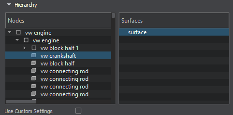

This auxiliary section is available in the Parameters window when selecting an imported CAD asset in the Asset Browser. It enables you to preview the content of the CAD asset imported with the current Mesh Import Options.在资源浏览器中选择导入的 CAD 资源时,此辅助部分在 Parameters 窗口中可用。它使您能够预览使用当前文件导入的 CAD 资源的内容网格导入选项.
Nodes List of nodes obtained from the CAD asset.从 CAD 资源中获取的节点列表。
Surfaces List of surfaces of the selected node.选定节点的曲面列表。
Use Custom Settings Enables custom Lightmaps options for the selected surface(s).启用自定义光照贴图选定曲面的选项。

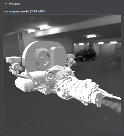

Asset Preview
资源预览#
This section is available in the Parameters window when selecting an imported CAD asset in the Asset Browser. It allows you to preview the imported model.Asset Browser 中选择导入的 CAD 资源时,此部分在 Parameters 窗口中可用。它允许您预览导入的模型。

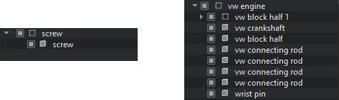

CAD model can be represented as a single detail or as an assembly. If parts of the assembly are stored in separate files, you should specify all of them on the assembly import.CAD模型可以表示为单个细节装配体。如果部件的零件存储在单独的文件中,则应在部件导入中指定所有零件。
To import 3D geometry data contained in a CAD model, you should enable the Import Meshes option. When you add the imported geometry to the scene, it will be available in the World Hierarchy as a Dummy Node:要导入CAD模型中包含的3D几何数据,应启用Import Meshes选项。将导入的几何体添加到场景中时,它将在World Hierarchy中以Dummy Node的形式出现:
  • If the imported CAD asset stores a detail, a single static mesh will be a child of the Dummy Node.如果导入的CAD资源存储了明细,则单个静态网格物体将是Dummy Node的子级。
  • If the imported CAD asset stores an assembly, the Dummy Node will have a hierarchy of child nodes representing parts of the assembly.如果导入的CAD资源存储了程序集,则Dummy Node将具有代表程序集零件的子节点层次结构。
A Detail (left) and An Assembly (right)一个细节(左)和一个装配体(右)

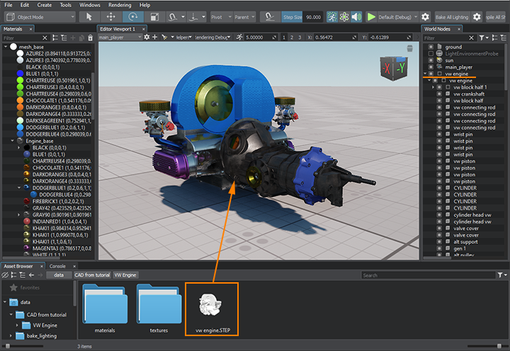

To add an imported CAD asset to the scene, drag it from the Asset Browser to the Viewport window. The corresponding node will be created and displayed in the World Hierarchy window. This node will have the same name as the imported CAD asset and a hierarchy of child nodes representing separate objects contained in the model.要将导入的CAD资源添加到场景中,请将其从资源浏览器Viewport窗口。相应的节点将被创建并显示在World Hierarchy窗口中。该节点将具有与导入的CAD资源相同的名称,并且子节点的层次结构代表模型中包含的单独对象。
If you double-click the imported CAD asset in the Asset Browser, the .mesh and .node files generated in run-time and stored in the CAD file will be displayed.如果在资源浏览器中双击导入的CAD资源,则将显示在运行时生成并存储在CAD容器中的.mesh.node文件。
