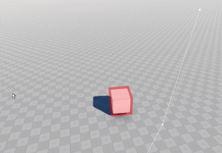

As a result, you will have a simple navigation sector, in which the dynamically changing obstacle box is placed.最终,您将有一个简单的导航扇区,其中放置了动态变化的障碍框。
Here the obstacle is highlighted with red在这儿,障碍用红色突出显示
