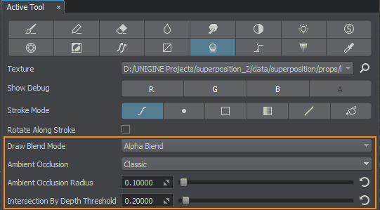

  4. Set the Draw Blend Mode parameter to Maximum. In this case, the texture will be brightened when painting.
  5. Specify the required Ambient Occlusion Radius.
  6. Specify the maximum available value (10) for the Intersection By Depth Threshold parameter.
  7. Choose the Fill stroke mode and paint the texture. You can use any stroke mode, if necessary.

Draw Blend Mode Sets a blending mode used for painting. For more details, see the Brush tool settings.
Ambient Occlusion
Method of ambient occlusion calculation:

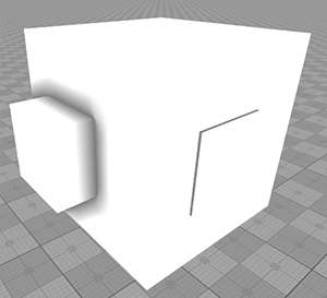

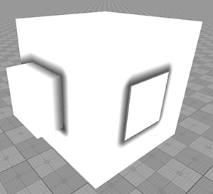

  • Classic method calculates how much the points are illuminated.
  • By Distance To Surface method calculates how close is the nearest surface to the shading point. It allows calculating smooth gradients even around small convexities.
Classic Ambient Occlusion
Ambient Occlusion By Distance To Surface
As you can see, there is no ambient occlusion effect around the small convexity in the first picture.
Ambient Occlusion Radius Distance for each point in the world space, up to which it can shadow its neighboring points.
Intersection By Depth Threshold Depth threshold (in units) limits the ambient oclusion effect in areas where information cannot be obtained. The higher the value, the less pronounced the effect is.
