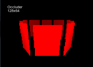

The buffer will open in the upper left corner:缓冲区将在左上角打开:
Simplified Occluder that is stored in the buffer存储在缓冲区中的简化Occluder
The buffer is rendered in a low resolution.缓冲区以低分辨率呈现。
