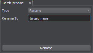

Rename
Rename the selected node(s), propertie(s), material(s) or file(s) to the specified name.
In case multiple files (properties, materials, or other assets) are selected, indices will be added to names automatically. However, indices are not added for nodes.

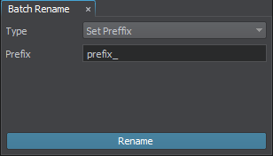

Set Prefix
Add the specified prefix to the selected element(s).

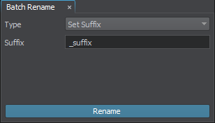

Set Suffix
Add the specified postfix to the selected element(s).

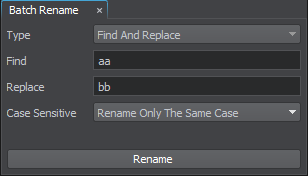

Find And Replace
Find the specified combination of symbols and replace it as defined in the Replace field taking into account the Case Sensitive condition:
  • Override Original Case — replaces the combination of symbols in all names regardless of the case originally used in the name.
  • Rename Only The Same Case — replaces the combination of symbols with the same case as specified in the Find field.

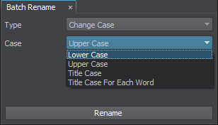

Change Case
Change the letter case in the name of the selected element(s) according to the selected condition:
  • Lower Case — any letters in the capital case are changed to the lower case.
  • Upper Case — any letters in the lower case are changed to the capital case.
  • Title Case — the first letter is in the capital case and all the rest are in the lower case.
  • Title Case For Each Word — the first letter of each word is in the capital case and all other letters are in the lower case. The word is a combination of letters separated from other combinations by a space or a non-letter symbol.
