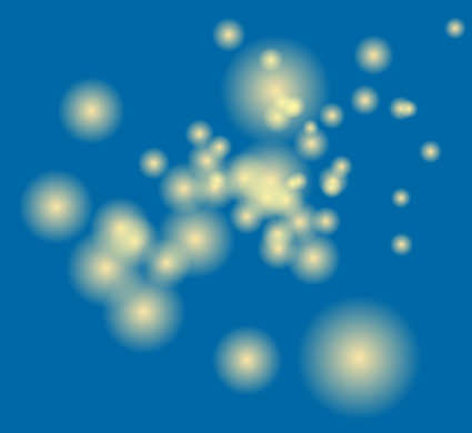

Src = One
Dest = One minus Src alpha
Result: Alpha blending结果:Alpha 混合
  • Opaque areas (alpha = 1) receive material color.不透明区域(alpha = 1)接收材质颜色。
  • Transparent areas (alpha = 0) receive screen buffer color.透明区域(alpha = 0)接收屏幕缓冲颜色。
The combination is used to create the effect of transparency basing on the alpha component.结合用于创建透明基于α组件的影响。

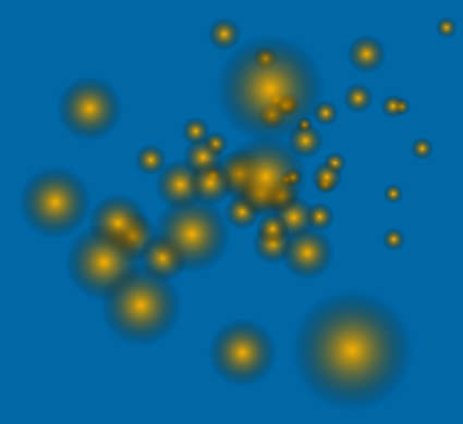

3
3#

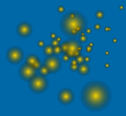

Src = Src alpha
Result: Standard alpha blending结果:标准α混合
  • Opaque areas receive material color, but they are darker and smaller in size, if compared to the previous variant.不透明 区域接收材质颜色,但与 以前的 变体相比,它们更暗且尺寸更小。
  • The areas of alpha gradient fading are darkened.领域的α梯度衰落是黑暗的。
  • Transparent areas receive the screen buffer color.透明区域接收屏幕缓冲颜色。

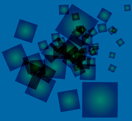

4
4#

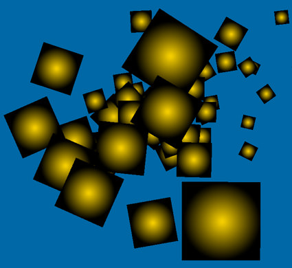

Src = Src color
Result:结果:
  • Opaque areas are also small and even darker and more contrast, if compared to the second and third variants.第二第三 相比,不透明 区域也更小,甚至更暗,对比度更高 变体。

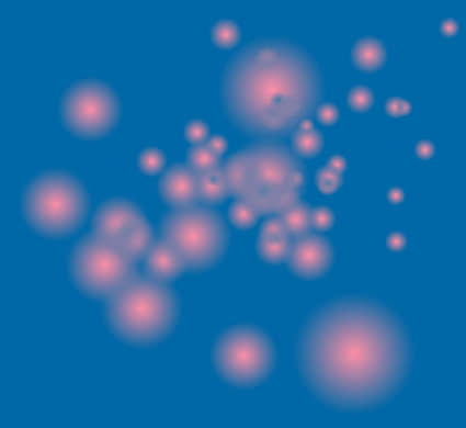

5
5#
Src = Src color
Dest = One minus Src color
Result:结果:
  • Opaque areas are small and of the inverted color.不透明区域很小并且颜色反转。
  • Completely black diffuse material color will result in rendering in screen buffer color.完全黑色分散材质将导致呈现在屏幕缓冲区的颜色。

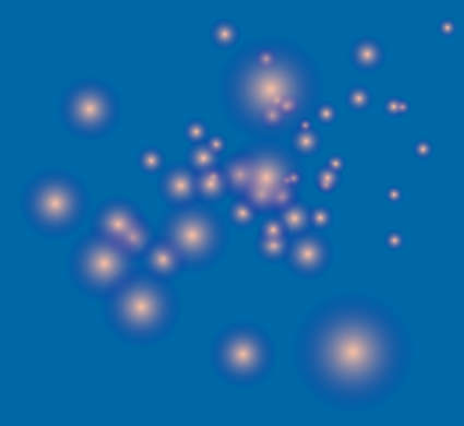

6
6#

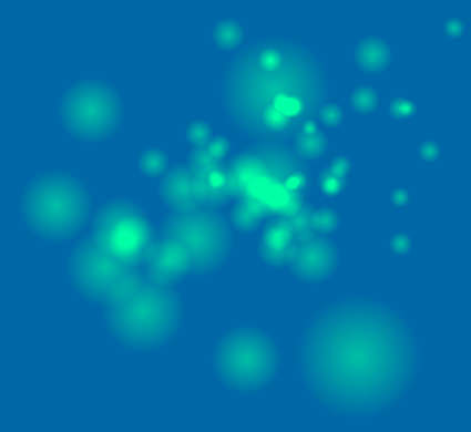

Src = Src alpha
Dest = One
Result: Alpha-dependent color addition结果:Alpha-dependent颜色之外
  • In overlapping opaque areas, the material color is added to itself. The areas are very small in size.在重叠的不透明区域中,材质颜色被添加到自身。 这些区域的面积非常小。
  • Transparent areas receive screen buffer color.透明区域接收屏幕缓冲颜色。

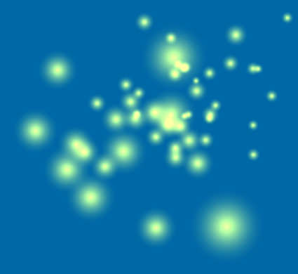

8
8#
Src = One
Dest = One
Result: Color addition结果:颜色之外
  • In overlapping opaque areas the material color is added to itself.在重叠的不透明区域中,材质颜色被添加到自身。
  • The areas of alpha gradient fading are bright and distinct.α梯度衰落的地区是明亮的和独特的。

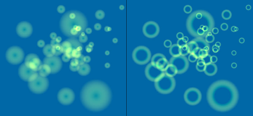

10
10#

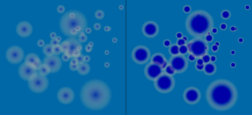

Src = One minus Src color
Dest = Dest alpha
Result:结果:
  • With a non-white color, a completely opaque area seems small and receives the inverted color. In the area of alpha gradient fading, it changes into the summed color. Layers overlapping causes intensification of the color.非白人的颜色,似乎完全不透明区域小,接收倒颜色。在α渐变褪色,它改变到总结的颜色。层重叠会导致颜色的强化。
  • If the diffuse material color is white, completely opaque core areas receive screen buffer color that changes into the summed color as alpha gradient fades.如果漫反射材质颜色为白色,则完全不透明核心区域会接收屏幕缓冲区颜色,该颜色会随着 alpha 渐变的消退而变为总和颜色。
  • Transparent areas are of the screen buffer color.透明区域接收屏幕缓冲颜色。
  • Changing the diffuse color multiplier changes the size of the core areas (ring size on the illustration).改变漫射颜色乘数的大小变化核心领域(环大小的插图)。
Material diffuse color multipliers: 1 (on the left) and 1.5 (on the right)材质漫射颜色乘数:1(左边)和1.5(右边)
If the diffuse material color is white, the opaque core is of the screen buffer color. The diffuse color multiplier equals 1.5如果分散材质的颜色是白色,不透明的核心是屏幕缓冲区的颜色。漫射颜色乘数= 1.5

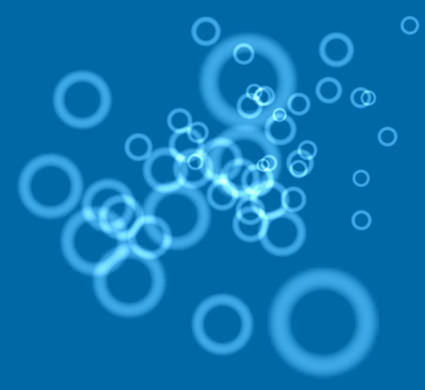

Src = One minus Dest color
Dest = Dest Alpha
Result:结果:
  • Opaque areas are bright and of diffuse material color hue.不透明 区域是明亮的且具有漫反射材质色调。
  • The darker the screen buffer color, the more saturated the material color is.屏幕缓冲区的颜色越深,越饱和材质颜色。
  • Transparent areas are of the screen buffer color.透明区域是屏幕缓冲颜色。
