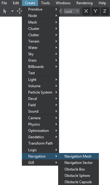

When a mesh is prepared, you can add the Navigation Mesh to the scene via UnigineEditor:准备好网格物体后,可以通过UnigineEditor将Navigation Mesh添加到场景中:
  1. Run UnigineEditor.跑步UnigineEditor。
  2. On the Menu bar, click Create -> Navigation -> Navigation Mesh.在菜单栏上,单击Create -> Navigation -> Navigation Mesh

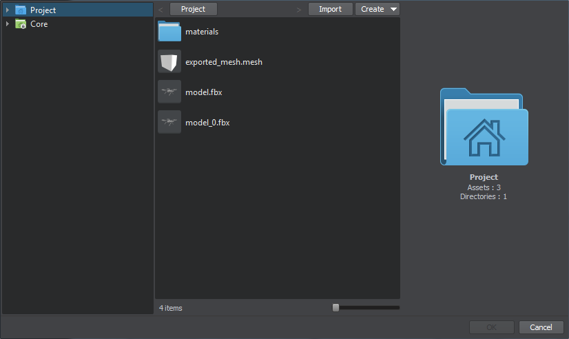

  3. In the file dialog window that opens, choose the required mesh to be used as a base for the new navigation area and click OK.在打开的文件对话框窗口中,选择所需的网格用作新导航区域的基础,然后单击OK
  4. Click somewhere in the world to place the Navigation Mesh. A new Navigation Mesh is added to UnigineEditor and you can edit it via the Parameters window.单击世界上的某个地方以放置Navigation Mesh。新的Navigation Mesh已添加到UnigineEditor,您可以通过Parameters窗口进行编辑。

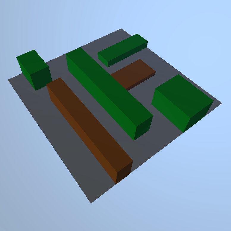

If you have a scene with different objects and need to calculate a 2D route among them, add the Navigation Mesh to this scene as follows:如果您的场景包含不同的对象,并且需要在它们之间计算2D路线,请按如下所示将Navigation Mesh添加到该场景:

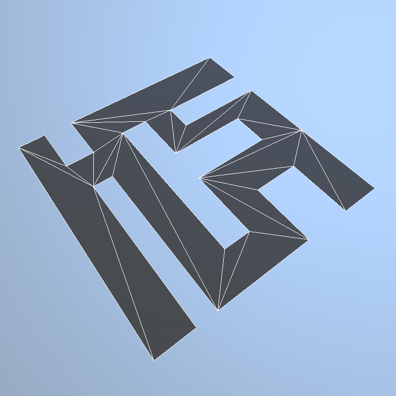

  1. Create a flat mesh with holes in places where the objects are positioned.在放置对象的位置创建带有孔的平面网格。
    The scene现场
    The mesh created for the Navigation MeshNavigation Mesh创建的网格

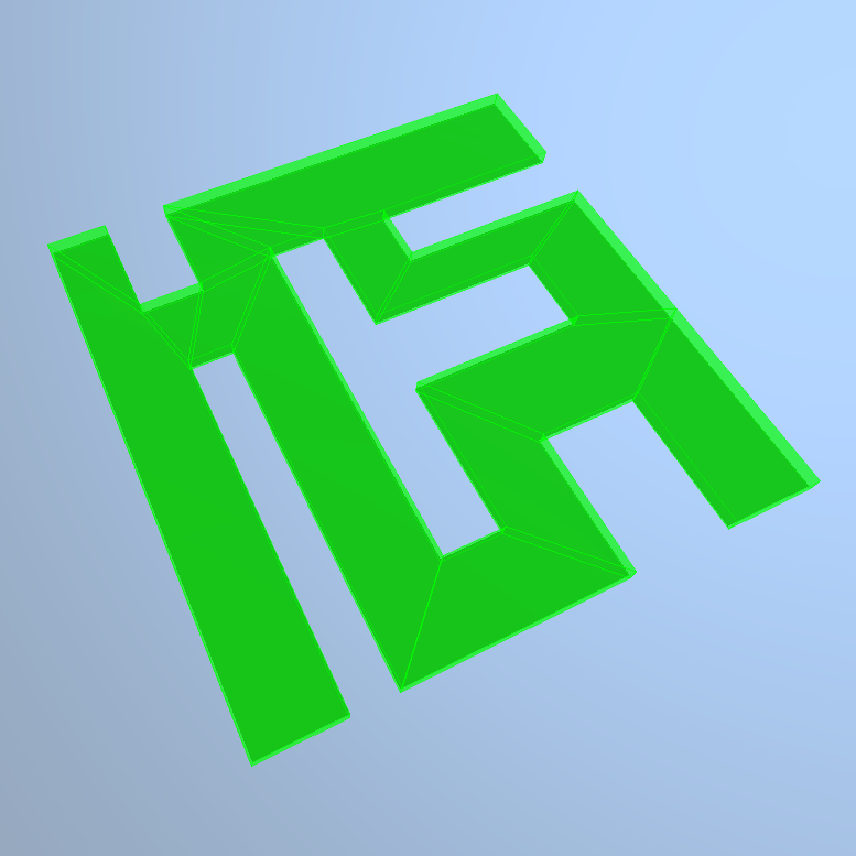

  2. Specify this mesh as a base for a Navigation Mesh within which the route is calculated, and add the Navigation Mesh to the world. It will be highlighted in green:将这个网格指定为Navigation Mesh的基础(在其中计算路线),然后将Navigation Mesh添加到世界中。它将以绿色突出显示:
    A Navigation Mesh based on the flat mesh基于平面网格的Navigation Mesh

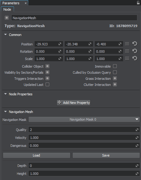

In the Node tab of the Parameters window, you can adjust the following parameters of the Navigation Mesh:Parameters窗口的Node选项卡中,可以调整Navigation Mesh的以下参数:
Navigation Mask The Navigation mask of the Navigation Mesh must match the Navigation mask of the route that is calculated within it. Otherwise, the Navigation Mesh does not participate in pathfinding.Navigation MeshNavigation掩码必须与在其中计算的路由的Navigation掩码匹配。否则,Navigation Mesh不参与寻路。
Quality Quality of optimization for route calculation. This value specifies the number of iterations that are used to find the shortcut. The higher the value, the longer the route calculation takes.路线计算的优化质量。此值指定用于查找快捷方式的迭代次数。值越高,路线计算花费的时间越长。
Velocity Scaling factor for velocity of the point that moves inside the Navigation Mesh.Navigation Mesh内移动的点的速度的比例因子。
Dangerous
Danger factor that indicates if a moving point should try to avoid the Navigation Mesh.危险因素,指示移动点是否应尝试避免Navigation Mesh
If the danger factor exceeds the maximum danger factor set for the route, the Navigation Mesh is excluded from pathfinding calculations.如果危险因子超过为该路线设置的最大危险因子,则将Navigation Mesh从寻路计算中排除。
Depth Depth value. This value affects the quality of the route that is currently calculated. The more the depth value, the better control over accuracy and speed of route calculation is provided. The depth can take integer value in range [0;4]. By default, the depth is set to 0 for a new Navigation Mesh. The 2, 3, 4 values are used for deeper heuristics.深度值。此值影响当前计算的路线的质量。深度值越大,就可以更好地控制路线计算的准确性和速度。深度可以取[0;4]范围内的整数值。默认情况下,对于新的Navigation Mesh,深度设置为0234值用于更深入的启发式。
Height Distance above the mesh polygons available for pathfinding. By default, the height is set to 1 for a new Navigation Mesh.可用于寻路的网格多边形上方的距离。默认情况下,新的Navigation Mesh的高度设置为1
