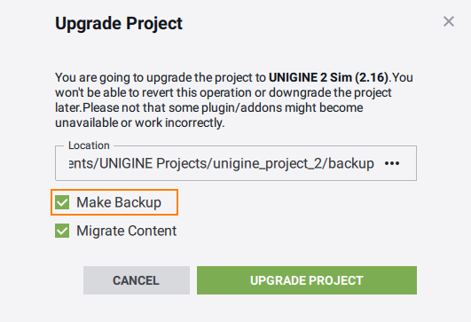

Another way is to keep the Make Backup option enabled. In this case the project is automatically copied for reference, and if automatic migration goes wrong (i.e. it is stopped halfway and you see a message like "Skip migration to version "2.15" File: "D:/ProjectFolder/data/.../example_file.node in the migration log) you can fix the problem files manually.
Make Backup
You can delete the backup folder manually after you've migrated successfully.

As a result, the binary executable and configuration files, meshes, terrains, worlds, nodes, splines, materials, properties, tracks, settings files will be upgraded to new formats (if any). The <unigine_project>/migration.log.html log file will be opened in the web browser. However, you can uncheck Migrate Content during automatic upgrading and perform content upgrading manually. In this case, only binary executable files will be upgraded.
