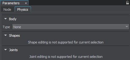

Physics settings of a node can be changed on the Physics tab of the Parameters window. Here you can assign a required body to the selected node and then set it up. 节点的物理设置可以在Parameters窗口的Physics选项卡上进行更改。在这里,您可以将所需的主体分配给选定的节点,然后进行设置。
Physics Settings物理设置
