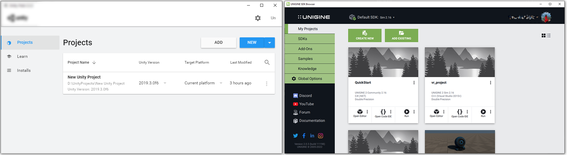

As a Unity software user, you are accustomed to use Unity Hub — the application that streamlines the way you find, download and manage your projects and installations.作为Unity软件用户,您习惯于使用Unity Hub,该应用程序可简化查找,下载和管理项目及安装方式的方式。
UNIGINE SDK Browser is the first step to start working with UNIGINE Engine. This application enables you to manage your projects and installed SDKs, as well as gives you access to the samples and the knowledge base. UNIGINE SDK浏览器 是开始使用UNIGINE Engine的第一步。该应用程序使您可以管理项目和已安装的SDK,并可以访问示例和知识库。
Unity Hub和UNIGINE SDK浏览器比较 (点击放大)

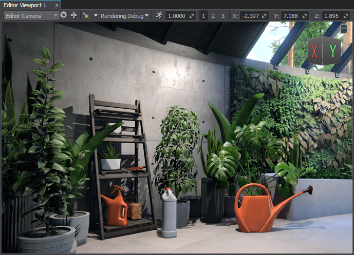

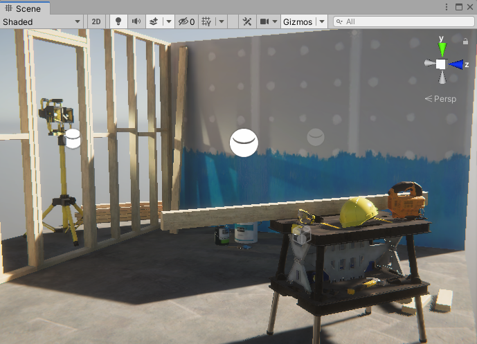

You may find the Scene View and the Editor Viewport controls looking very much alike.您可能会发现Scene ViewEditor Viewport控件看起来非常相似。
Unity Scene View
UNIGINE Editor Viewport
You can use:您可以使用:
  • Camera panel to switch between cameras and configure the current one.Camera panel可以在摄像机之间切换并配置当前摄像机。
  • Rendering Debug to display the contents of rendering buffers the same way as using the Draw Mode in Unity Editor.Rendering Debug显示渲染缓冲区的内容,与在Unity Editor中使用Draw Mode相同。
  • Navigation panel to quickly set up and switch between camera speed presets and change the camera position.Navigation panel可快速设置并在摄像机速度预设之间切换并更改摄像机位置。
Navigation inside the Editor Viewport is pretty much the same as in Unity Scene View. However, get familiar with Scene Navigation so as not to miss details.Editor Viewport中的导航Unity Scene View中的几乎相同。但是,请熟悉场景导航,以免丢失细节。

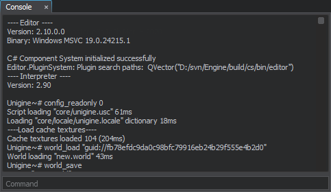

Console
安慰#
As well as Unity software, UNIGINE has the Console used for standard input, output and error logging. A set of console commands is provided.Unity软件外,UNIGINE还具有用于标准输入,输出和错误记录的控制台。提供了一组控制台命令
It is available both in UnigineEditor and a running application. To open the Console window in the Editor, go to Windows -> Console menu:它在UnigineEditor和正在运行的应用程序中均可用。要在编辑器中打开控制台窗口,请转到Windows -> Console菜单:
A built-in console is called by pressing the F1 key:按下grave accent (`)键可以调用内置控制台:
You can use it to print user messages from code.您可以使用它从代码中打印用户消息

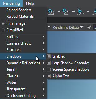

In Unity Editor, Asynchronous Shader compilation is toggled on and off in the Editor settings (menu: Edit > Project Settings > Editor > Shader Compilation).Unity编辑器中,在编辑器设置(菜单:Edit > Project Settings > Editor > Shader Compilation)中打开和关闭Asynchronous Shader compilation
In UNIGINE, a similar editor feature, Forced Shader Compilation, is available via both the toolbar and the Editor section of the Settings window.在UNIGINE中,可通过工具栏和Settings窗口的Editor部分使用类似的编辑器功能Forced Shader Compilation

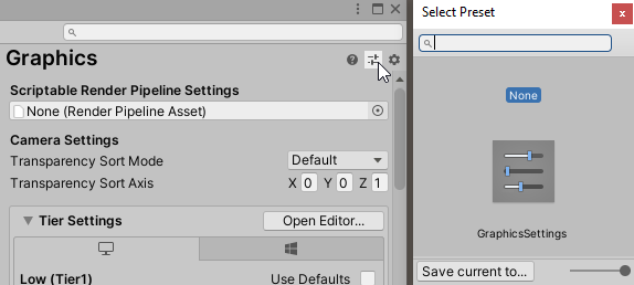

You use Presets in Unity Editor when you need to reuse property settings that have bearing to different tasks, be it component settings, import settings or especially Project Settings. You can save the settings preset for a certain section of the Project Settings as a .preset asset and reuse in development later.需要重新使用与不同任务相关的属性设置时,可以在Unity编辑器中使用“预设”,无论是组件设置,导入设置还是特别是项目设置。您可以将项目设置的某个部分的预设设置保存为.preset资源,并在以后的开发中重复使用。
Presets are an Editor-only feature in Unity software.预设是Unity软件中的仅编辑器功能。

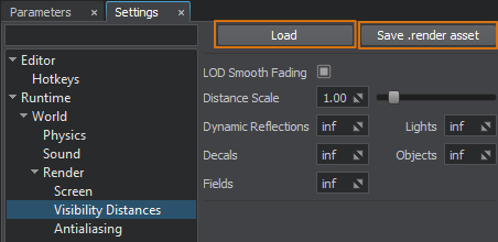

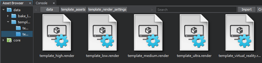

In UNIGINE, you can save and load presets for general physics, sound and render settings. The presets are stored as assets with the *.physics, *.sound and *.render extensions respectively. Use Load and Save .* asset buttons of the Settings window to work with presets of the corresponding settings section.在UNIGINE中,您可以保存和加载预设以进行常规的物理,声音和渲染设置。预设分别存储为资源,扩展名为*.physics*.sound*.render。使用Settings窗口的LoadSave .* asset按钮可使用相应设置部分的预设。
Saved assets appear in the Asset Browser. You can load the render settings by double-clicking the required .render asset.已保存的资源将显示在资源浏览器中。您可以通过双击所需的.render资源来加载渲染设置。
By default, a UNIGINE project provides settings for low, medium, high, ultra and virtual reality quality presets stored in the data/template_render_settings folder.默认情况下,UNIGINE项目为存储在data/template_render_settings文件夹中的low, medium, high, ultravirtual reality质量预设提供设置。
Presets are not an Editor-only feature in UNIGINE. You can use Physics, Sound and Render classes to manage presets for corresponding settings, for example, to switch between quality levels at run time.预设不是UNIGINE中的仅编辑器功能。您可以使用PhysicsSoundRender类管理相应设置的预设,例如,在运行时在质量级别之间切换。

  • The Graphics section contains global settings for graphics. The Tier Settings provide platform-specific adjustments to rendering and shader compilation. One of the three Tier levels to be applied is defined automatically based on the platform used. Graphics部分包含图形的全局设置。 Tier Settings为渲染和着色器编译提供特定于平台的调整。将根据所使用的平台自动定义要应用的三个层级之一。
  • The Quality section handles levels of graphical quality defined for each platform. Quality部分处理为每个平台定义的图形质量级别。

Realtime Reflection Probes Menu: Rendering -> Dynamic Reflections -> Enabled
Texture Streaming Render -> Streaming Settings
Shadows Render -> Shadows Settings
