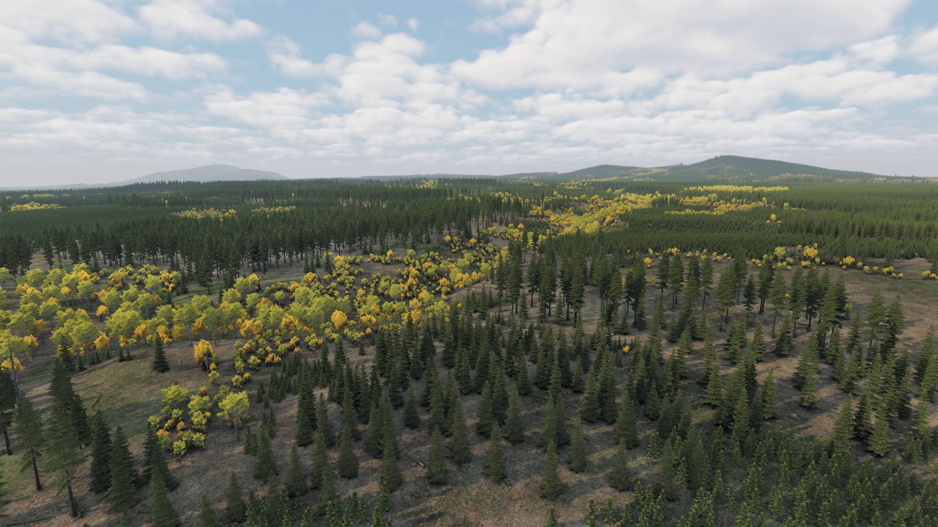

For example, you can replace the distant trees with impostors to optimize forest rendering:例如,您可以使用冒名顶替者替换远处的树木,以优化森林渲染:
Forest Optimized by Using Impostor Trees使用发布者树优化的森林

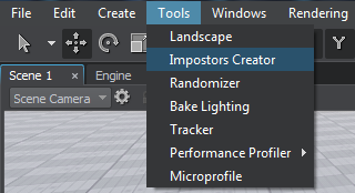

  1. In the Menu Bar, choose Tools -> Impostors Creator. The Impostors Creator tool will open.
    在菜单栏中,选择Tools -> Impostors Creator。的Impostors Creator工具将打开。

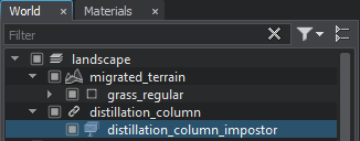

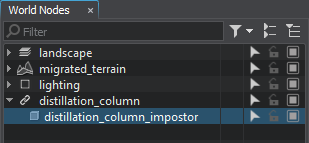

The generated impostor(s) will be added as a child node to the original mesh/clutter:生成的冒名顶替者将作为子节点添加到原始网格/杂波中:

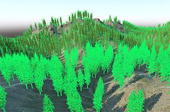

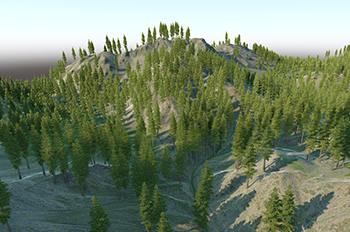

    Real Clutter Objects and Its Impostors in SceneReal Clutter Objects and Its Impostors in Scene
    Objects and Impostors WireframesObjects and Impostors Wireframes
    Real Clutter Objects and Its Impostors in SceneObjects and Impostors Wireframes
    对于杂乱无章的对象, Grass 对象具有从中继承的材质grass_impostor_base将被添加。所有必需的设置都会从原始文件中复制Mesh ClutterGrass自动对象。
    Real Clutter Objects and Its Impostors in Scene场景中的真实杂物及其伪装者
    Objects and Impostors Wireframes对象和假名线框
  • For a single object, the Billboards object with the material inherited from billboards_impostor_base will be added.

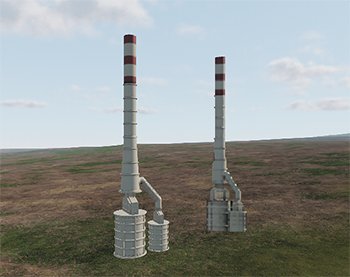

    Real Object (left) and Its Impostor (right) in SceneReal Object (left) and Its Impostor (right) in Scene
    Object and Impostor WireframesObject and Impostor Wireframes
    Real Object (left) and Its Impostor (right) in SceneObject and Impostor Wireframes
    对于单个对象,Billboards具有从中继承的材质的对象billboards_impostor_base将被添加。
    Real Object (left) and Its Impostor (right) in Scene场景中的真实对象(左)及其伪装者(右)
    Object and Impostor Wireframes对象和假名线框
