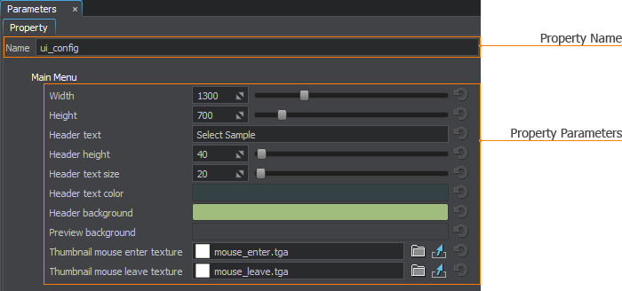

The multi-purpose Parameters window provides access to all available parameters of the selected property.多功能Parameters窗口提供了对所选属性的所有可用参数的访问。
Parameters Window with Property Settings参数窗口的属性设置
If the window isn't opened, choose Windows -> Add Parameters in the main menu.如果没有打开该窗口,请在主菜单中选择“Windows -> Add Parameters”。
Via this window, you can change a name of the selected property or modify its parameters (if it is editable and not a manual one.通过此窗口,您可以更改所选属性的名称或修改其参数(如果它是可编辑的,而不是 manual one)。
A property can be assigned both to single surfaces and whole nodes (a single node can have multiple properties assigned). You can access parameters of the assigned properties via the Node Settings displayed in the Parameters window.一个属性可以分配给 single surfaceswhole nodes(一个节点可以有多个属性分配)。您可以通过Parameters窗口中显示的节点设置访问所分配属性的参数。
UnigineEditor doesn't provide editing of properties: you cannot add, modify or delete parameters. To implement or change a property, open the required .prop file and edit it manually.UnigineEditor不提供属性编辑:您不能添加、修改或删除参数。要实现或更改一个属性,打开所需的 .prop文件,并手动编辑它。
