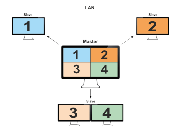

Simply connect multiple computers into one high-resolution seamless display using LAN. And it does not matter if these computers are running on Windows and Linux at the same time, as Syncker works even across different platforms. Moreover, created virtual environments can have any monitor configuration, since all viewports are fully configurable and multi-monitor grids on Slave computers are supported.只需使用 LAN 将多台计算机连接到一台高分辨率无缝显示器即可。这些计算机是否同时在 Windows 和 Linux 上运行并不重要,因为 Syncker 甚至可以跨不同平台运行。此外,创建的虚拟环境可以具有任何监视器配置,因为所有视口都是完全可配置的,并且支持 Slave 计算机上的多监视器网格。
Syncker
Computers in LAN connected via SynckerLAN 中的计算机通过 Syncker 连接

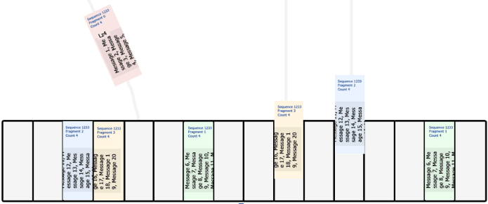

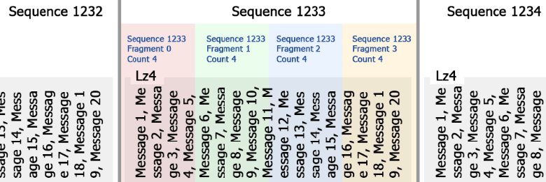

For sending and receiving messages between Master and Slave, Syncker uses a single UDP socket with the following five technologies:为了在 MasterSlave 之间发送和接收消息,Syncker 使用具有以下五种技术的单个 UDP 套接字:
  • Reliable — guarantees packet delivery using the so-called acknowledge packets. When Master sends a message, Slave reports that the message is received. In case Slave does not reply in a certain period of time, Master tries to re-send the message.Reliable — 使用所谓的确认数据包保证数据包传送。当Master发送消息时,Slave报告收到消息。如果 Slave 在一定时间内没有回复,Master 会尝试重新发送消息。
  • Sequenced — guarantees that all packets are received in the right order, finding all duplicates. Each packet has a number and until Slave receives the packet, Master shall not send next ones to it (with greater numbers).Sequenced — 保证所有数据包都以正确的顺序接收,找到所有重复项。每个数据包都有一个编号,并且在 Slave 接收到数据包之前,Master 不会向它发送下一个(具有更大的数字)。
  • Merged — small messages are combined into a greater one instead of sending them all one right after the other (send a single 100-bytes packet rather than sending 10 packets 10-bytes each). This makes sending acknowledge packets to the sender simpler and faster.Merged — 小消息被组合成一个更大的消息,而不是一个接一个地发送它们(发送一个 100 字节的数据包,而不是发送 10 个 10 字节的数据包)。这使得向发送方发送确认数据包更简单、更快捷。
  • Fragmented — a large message exceeding the MTU size (Maximum Transmission Unit), shall be split into several packets having the MTU size. This ensures delivery of all packets protecting Slave from buffer overflow caused by a single large packet.Fragmented — 超过 MTU 大小 (Maximum Transmission Unit) 的大消息应拆分为多个具有 MTU 大小的数据包。这确保了保护 Slave 免受单个大数据包引起的缓冲区溢出的所有数据包的传递。
  • Compressed — all messages are compressed using the LZ4 algorithm before sending. This reduced network load, but slightly increases the load on the computer itself.Compressed — 所有消息在发送前都使用 LZ4 算法进行压缩。这减少了网络负载,但稍微增加了计算机本身的负载。
So, here's how the packets are delivered:所以,这里是数据包的传递方式:
  1. During the frame up to the Data Sync Point, Master prepares messages for sending and places them to a queue. This "big message" is compressed, split into parts according to the MTU size, wrapped into packets with the following three numbers specified for each of them: sequence number (packet group), fragment number, and total number of fragments in this sequence.在到达数据同步点的帧期间,Master 准备要发送的消息并将它们放入队列。这个“大消息”被压缩,根据 MTU 大小分成几部分,包装成数据包,为每个数据包指定以下三个数字:序列号(数据包组)、片段号和此序列中的片段总数。
  2. The packets are sent.数据包被发送。
  3. Upon receiving any of the packets, Slave changes the size of its sliding window in accordance with the number of fragments and adds the received fragment to this window.Slave 在接收到任何一个数据包后,会根据片段的数量改变其滑动窗口的大小,并将接收到的片段添加到该窗口中。
  4. In case of missing/lost packets, Slave adds the corresponding information on the missing part it requests to be sent again to the acknowledge packet dispatched to Master.在丢失/丢失数据包的情况下,Slave 将它请求再次发送的丢失部分的相应信息添加到分派给 Master 的确认数据包中。

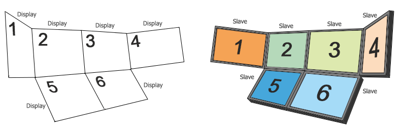

Screen configuration for Syncker has to meet the following requirements:Syncker 的屏幕配置必须满足以下要求:
  • Each display in the configuration should correspond to one of the monitors/projectors.配置中的每个显示器都应对应于其中一台显示器/投影仪。
  • Position and orientation of each display/projector must be relative to the main master camera. The closer the monitor is to the viewer, the higher is the FOV value.每个显示器/投影仪的位置和方向必须相对于主摄像头.监视器离观看者越近,FOV 值就越高。
Two types of configuration can be used:可以使用两种类型的配置:
  • A multi-monitor setup formed by displays, where each Slave renders its viewport on the corresponding monitor (or several monitors).多显示器设置由显示,其中每个 Slave 在相应的监视器(或多个监视器)上呈现其视口。
    Projection and modelview matrices are automatically calculated on the basis of the viewer's position.投影和模型视图矩阵是根据观察者的位置自动计算的。
    The following picture shows the screen configuration for the multi-monitor setup, where each Slave renders its viewport to a single monitor.下图显示了多显示器设置的屏幕配置,其中每个 Slave 将其视口渲染到单个显示器。
    Screen Configuration (the left picture) for Multi-Monitor Setup (the right picture)多显示器设置(右图)的屏幕配置(左图)

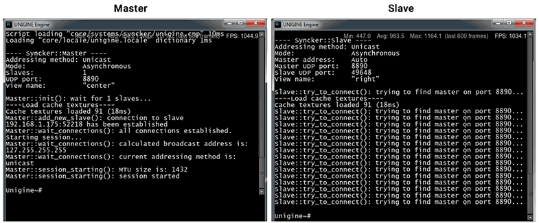

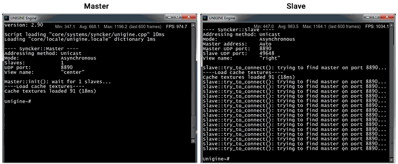

Basically Syncker has 4 states:基本上 Syncker 有 4 个状态:
  • Wait for connections — waiting until all Slave PCs are connected.Wait for connections — 等待所有 Slave PC 连接。
  • Starting...MTU calculation and startup synchronization of all hosts.Starting... — 所有主机的 MTU 计算和启动同步。
  • Session Started — the session is started.Session Started — 会话开始。
  • Session Finished — the session is over, all Slave PCs are disconnected.Session Finished — 会话结束,所有 Slave PC 断开连接。
Let us consider Syncker running using broadcast addressing with Master and a single Slave:让我们考虑使用带有 Master 和单个 Slave 的广播寻址运行的 Syncker

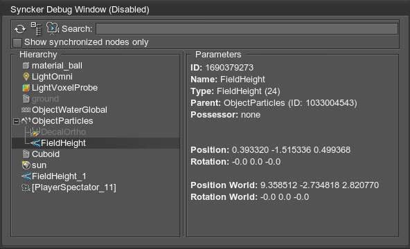

Debug Window
调试窗口#
Syncker's debug window enables you to monitor the hierarchy of objects at run time. The whole hierarchy means all objects (not only the ones registered in the Editor) including objects in cache, internal structure of node references, etc. When a node is selected, all necessary debug information is displayed. This information is updated each frame.Syncker 的调试窗口使您能够在运行时监视对象的层次结构。整个层次结构是指所有对象(不仅是编辑器中注册的对象),包括缓存中的对象,内部结构节点引用等。选择节点后,将显示所有必要的调试信息。该信息每帧更新一次。
The Search option allows you to find any node by its name or ID (on Master or Slave), so a faulty node can be found quickly.Search 选项允许您通过名称或 ID(在 MasterSlave 上)查找任何节点,因此可以快速找到故障节点。
To open the debug window, run the syncker_debug console command from Master or Slave as follows:要打开调试窗口,请从 MasterSlave 运行 syncker_debug 控制台命令,如下所示:
源代码
syncker_debug 1
The debug window can also be opened via the System Menu:调试窗口也可以通过 System Menu 打开:
  1. Open the System Menu by pressing Esc.Esc 打开 System Menu
  2. Enable the Show debug window option:启用 Show debug window 选项:
The debug window will open:调试窗口将打开:
Debug Window调试窗口

Slave Cannot Connect to Master
从站无法连接到主站#
The console shall look like this:控制台应如下所示:
Slave periodically sends broadcast messages when trying to find Master that responds, but there's no reply. Messages do not reach Master.Slave 在尝试找到响应的 Master 时会定期发送广播消息,但没有回复。消息未到达 Master
Solutions:解决方案:
  • Make sure that the port used by Slave for sending/receiving messages (Slave UDP port) is not blocked by the firewall on Master. Try disabling firewalls on Master and all Slave PCs.确保 Slave 用于发送/接收消息 (Slave UDP port) 的端口未被 Master 上的防火墙阻止。尝试禁用 Master 和所有 Slave PC 上的防火墙。
  • Make sure that broadcast/multicast messages are not blocked by the router/switch. It is unlikely, but still possible.确保广播/多播消息未被路由器/交换机阻止。这不太可能,但仍有可能。
  • Try to explicitly specify Master's IP address via the sync_master_address command, for example:尝试通过 sync_master_address 命令明确指定 Master 的 IP 地址,例如:
    源代码
    -sync_master_address 192.168.0.1
    In this case Slave shall skip the phase of searching for Master via broadcast messages and use unicast mode for direct connection.在这种情况下,Slave 将跳过通过广播消息搜索 Master 的阶段并使用单播模式用于直接连接。
  • Make sure that Master really waits for new connections. Check the sync_count value, is it greater than 1?确保 Master 真的在等待新的连接。检查sync_count值,是否大于1
Master Cannot Reply to Slave
Master无法回复Slave#
In this case the console shall look like this:在这种情况下,控制台应如下所示:
Connection requests from Slave were received by Master, the connection was opened and the session was started, but connection response did not reach Slave.Master 收到来自 Slave 的连接请求,打开连接并启动会话,但连接响应未到达 Slave
Solutions:解决方案:
  • Make sure that the port used by Slave for sending/receiving messages (Slave UDP port) is not blocked by the firewall. Try disabling firewalls on Master and all Slave PCs.确保 Slave 用于发送/接收消息的端口 (Slave UDP port) 未被防火墙阻止。尝试禁用 Master 和所有 Slave PC 上的防火墙。
  • Make sure that broadcast/multicast messages are not blocked by the router/switch. It is unlikely, but still possible.确保路由器/交换机没有阻止 broadcast/multicast 消息。这不太可能,但仍有可能。
  • Try using a unicast connection:尝试使用单播连接:
    源代码
    -sync_method unicast
  • Check that the broadcast address found is valid, try setting up a broadcast channel for all hosts:检查找到的广播地址是否有效,尝试为所有主机设置广播通道:
    源代码
    -sync_broadcast_address 255.255.255.255
  • Try setting another multicast address on the Master and Slave PCs via the sync_multicast_address command.尝试通过 sync_multicast_address 命令在 MasterSlave PC 上设置另一个多播地址。
  • Check IP/port of the Slave connected to Master. Is this the right Slave, or maybe there is another instance of Slave looking for Master on the same port? Try changing port number on Master and Slave (e.g., -sync_port 25100) and restart applications.检查连接到 MasterSlave 的 IP/端口。这是正确的 Slave,还是 Slave 的另一个实例在同一端口上寻找 Master?尝试更改 MasterSlave(例如 -sync_port 25100)上的端口号并重新启动应用程序。
