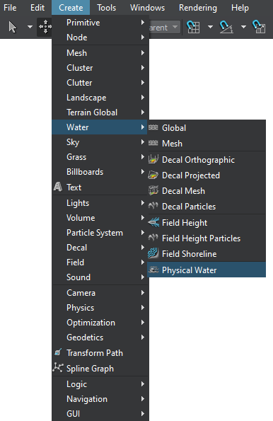

To add a Physical Water to the scene via UnigineEditor:通过UnigineEditor将Physical Water添加到场景中:
  1. Run the project with UnigineEditor.跑步UnigineEditor的项目。
  2. On the Menu bar, click Create -> Water -> Physical Water.在菜单栏上,单击Create -> Water -> Physical Water
  3. Click somewhere in the world to place the Physical Water.单击世界上的某个地方以放置Physical Water

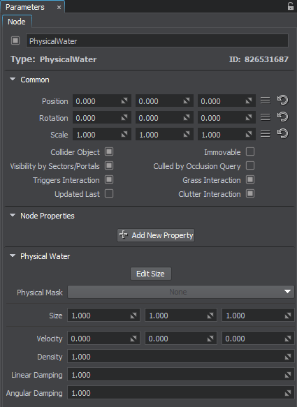

A new Physical Water node will be added to UnigineEditor, and you will be able to edit it via the Parameters window. By default, the size of the node is 1×1×1 unit.新的Physical Water节点将被添加到UnigineEditor,您将能够通过Parameters窗口对其进行编辑。默认情况下,节点的大小为1×1×1单位。
Editing Physical Water
编辑物理水#
In the Physical Water section (Parameters window -> Node tab), you can adjust the following parameters of the Physical Water:Physical Water部分(Parameters窗口→Node选项卡)中,可以调整Physical Water的以下参数:

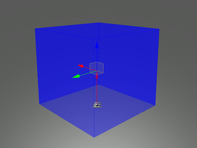

Edit Size
Toggles the editing mode for the Physical Water node. When enabled, the Physical Water box sides that can be resized are highlighted with the colored rectangles. To change the size of a side, drag the corresponding rectangle.切换Physical Water节点的编辑模式。启用后,可以调整大小的Physical Water框边会用彩色矩形突出显示。要更改边的大小,请拖动相应的矩形。
Physical Mask Physical mask. The physical mask of the Physical Water must match the Physical mask of the physical object. Otherwise, the Physical Water won't affect the object.Physical掩码。 Physical Water的物理掩码必须比赛物理对象的Physical掩码。否则,Physical Water将不会影响该对象。
Size Size of the Physical Water box along the axes in units.沿轴的Physical Water框的大小(单位)。
Velocity Velocity of the flow in the Physical Water along the axes.沿轴在Physical Water中的流速。
Density
Density of the Physical Water. It determines buoyancy of objects that float in the Physical Water. The higher the value, the higher is the buoyancy of the object. The lower the water density, the deeper the object submerges into water.Physical Water的密度。它确定漂浮在Physical Water中的对象的浮力。值越高,对象的浮力越高。水密度越低,物体浸入水中的深度就越大。
The density and the mass of the physical body also affect buoyancy of the object.密度大量的身体的浮力也会影响物体的浮力。
Physical Water density = 10物理水密度= 10
Physical Water density = 25物理水密度= 25
Linear Damping Value indicating how much the linear velocity of the objects decreases when they get into the Physical Water. The higher the value is, the lower the linear velocity will be.指示对象进入Physical Water时线速度降低多少的值。值越高,线速度将越低。
Angular Damping Value indicating how much the angular velocity of the objects decreases when they get into the Physical Water. The higher the value is, the lower the angular velocity will be.指示对象进入Physical Water时角速度减小多少的值。值越高,角速度将越低。
