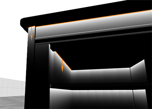

The Leaks tool is used for painting leaks on complex 3D models, especially on surfaces aligned at an angle to other surfaces, and other places where the leaks may occur. For example:
The arrows show direction of the gradient.
Leaks calculation with the Leaks tool doesn't depend on the UV map, as it is performed using screen-space tracing.

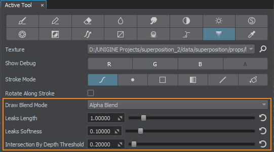

Settings#
Draw Blend Mode Sets a blending mode used for painting. For more details, see the Brush tool settings.
Leaks Length Length of the painted leaks.
Leaks Softness Softness of the painted leaks.
Intersection By Depth Threshold Depth threshold (in units) limits the leaks effect in areas where information cannot be obtained. The higher the value, the less pronounced the effect is.
