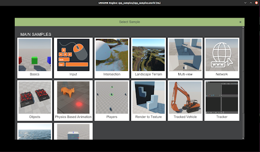

Running C++ Application
运行C++应用程序#
  1. Enable connections with the X-server:启用与X-server的连接:
    输出
    $ xhost +local:*
  2. Launch the C++ application:启动C++应用程序:
    输出
    $ cd ~/unigine-in-docker/
    $ docker run -it --rm \
    --runtime=nvidia --gpus 0 \
    -e NVIDIA_VISIBLE_DEVICES=0 \
    -e DISPLAY=${DISPLAY} \
    --device /dev/snd \
    -e NVIDIA_DRIVER_CAPABILITIES=display,compute \
    -v /tmp/.X11-unix:/tmp/.X11-unix \
    -v `pwd`/cpp_samples:/opt/project \
    -v /etc/localtime:/etc/localtime:ro \
    -w /opt/project/bin/ \
    unigine/run-unigine-in-docker:latest \
    ./cpp_samples_x64

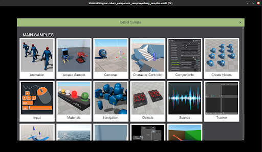

Running C# Application
运行C#应用程序#
    输出
    $ xhost +local:*
  2. Launch the C# application:启动C#应用程序:
    输出
    --device /dev/snd \
    -v `pwd`/csharp_component_samples:/opt/project \
    dotnet csharp_component_samples_x64.dll -console_command "world_load csharp_samples"
